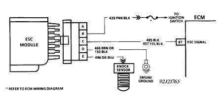

Now the Electronic spark control unit. With your volt meter check term C and if when the truck is running the (may need to be in gear) there is 12 volts pressent the the ESC needs to be replaced. If there isn't 12 volts then take a small hammer to ratched and tap on the block near the Knock sensor and 12 volts should show. Check the ohms at term D to ensure a good ground and check Term B with the key on engine off to ensure battery voltage this way you know that there are no bad wires ok.
https://www.2carpros.com/forum/automotive_pictures/249564_Graphic2_6.jpg
Let me know what you find. Thanks.

Knock sensor was bad. Replaced. Check engine light is not on and I checked the codes couple of weeks ago. No codes stored.
Checked wires. OK. Checked TPS sensor. Tested fine.
Did not get the chance to check anything else.
Couple of other things I noticed/forget to tell you. When it is messing up, it will not idle. RPMs drop, then it shakes and sputters, knocks, then levels out and is fine. Sometimes after it dies, starter really has to work to turn over motor. Could the idle air control valve be flaky? Can you test it?
Also heard a popping sound coming from the muffler/cat area after truck had been running 10-15 minutes. May have just been warming up?
Problems always happen after truck has ran for 10-15 minutes. Fine before that point.
Going back up to work on the truck on Tuesday. Any suggestions besides the spark control and ignition module which I plan on testing at that time?
Thanks for all your help. Learning as I go!

No not at this point as with what you are discribing I am thinking timing issue. So test the ESC first then test the module. The ESC with the knock sensor control the timing. If the ESC thinks it is pinging then it will retard the timing or advance it if it sees the signal incorrectly and make it ping and then it would be very hard to start as the timing is advanced beyond what the engine should be. Does this make sense? If not let me know I will try to explain it better.
