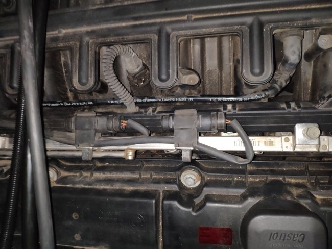

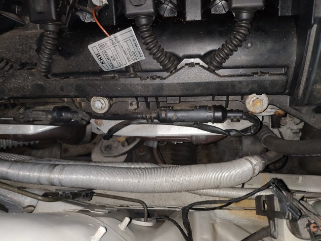

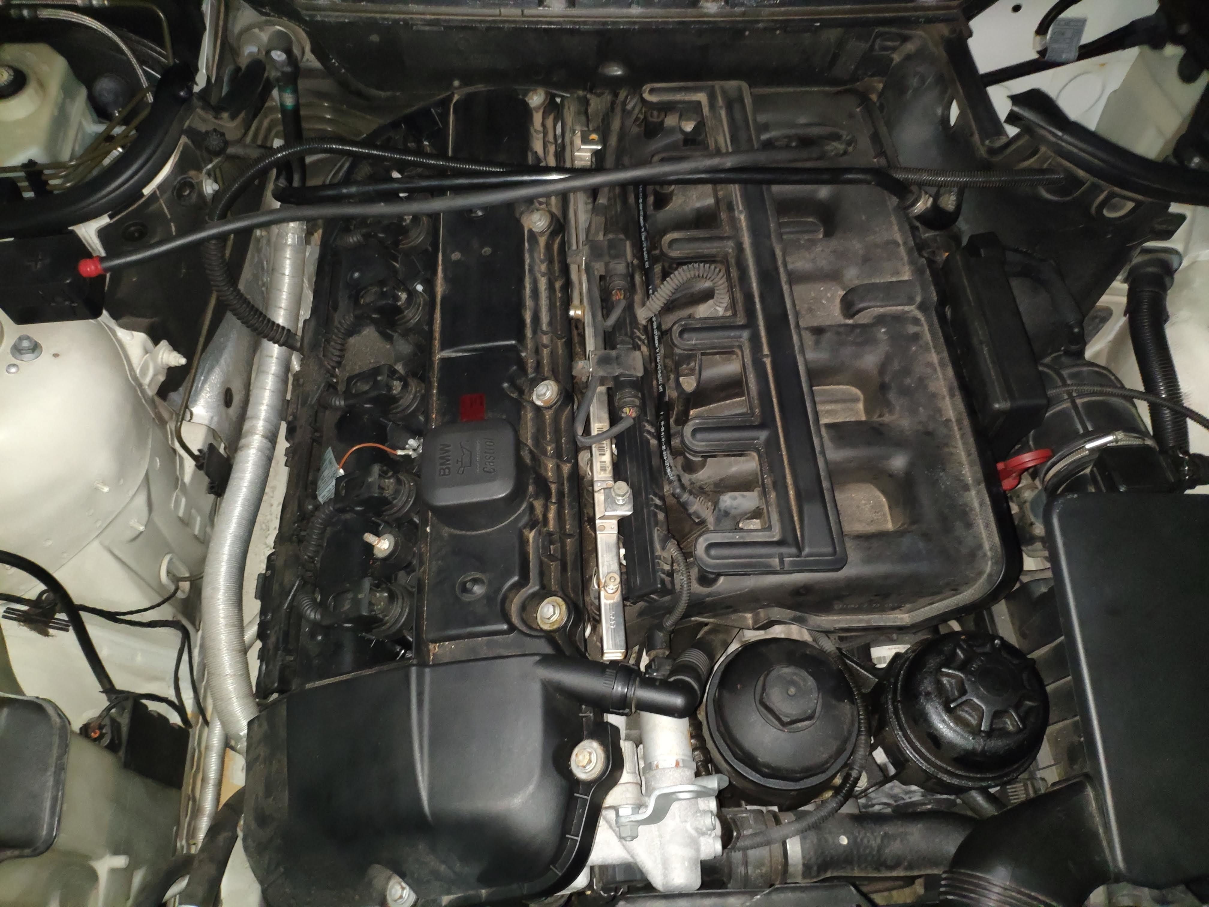

CYBAFORGE
  • 13 POSTS
Thanks for all the help!

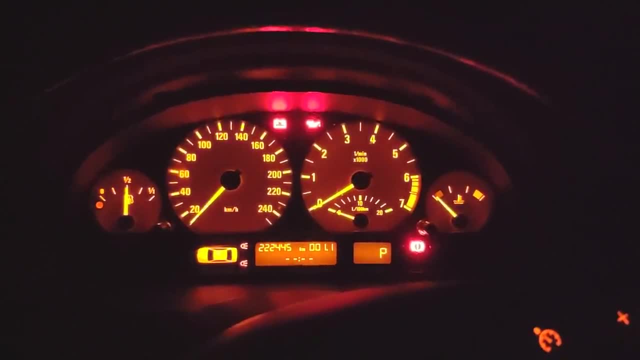

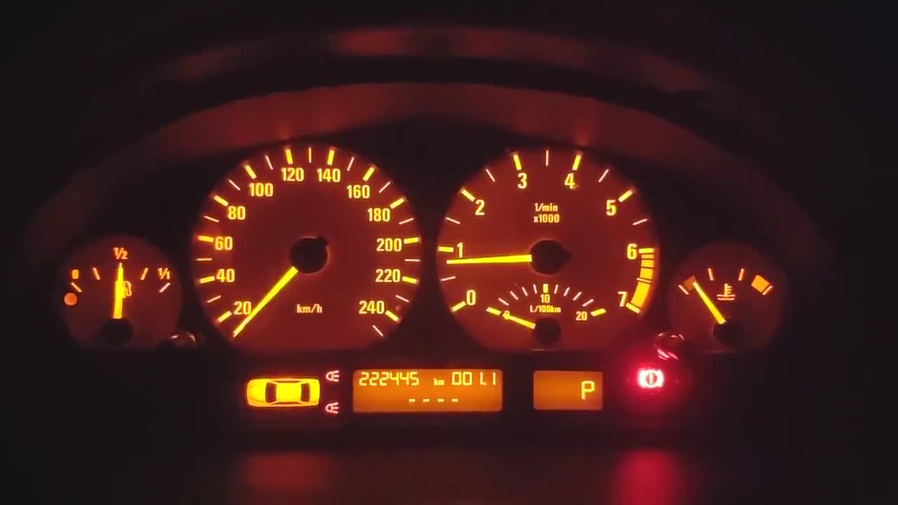

I've attached some stuff:
Some photos of what I think are disconnected (temperature?) sensors on top of my engine?
One photo of some attached sensors on the side of my engine
A video of me starting the car a few hours ago:
0:00 - Car starts and immediately stalls.
0:11 - I press the accelerator so car doesn't stall and keep my foot there.
0:17 - The revs drop even when the pedal is constant.
0:19 - I press the pedal more to keep the revs up.
0:30 - I press it some more to test the high revs.
0:38 - I try to see if it will idle without the pedal but it stalls.
1:16 - Ignore me pressing the radio.
2:10 - It finally stalls by itself!
2:30 - I move the car around a bit (reverse first).
2:47 - I go forwards.
2:56 - It stalls going up a tiny slope.
3:20 - Back to where I started, back in park (such a low idle :c).
3:45 - More testing the high revs.
And finally a video of me playing with the A/C while it idles (it started up perfectly somehow and got a bit worse over time)
If it's relevant it's about 15°C (or 60°F) and I'm not that far above sea level.
Thank you so much!

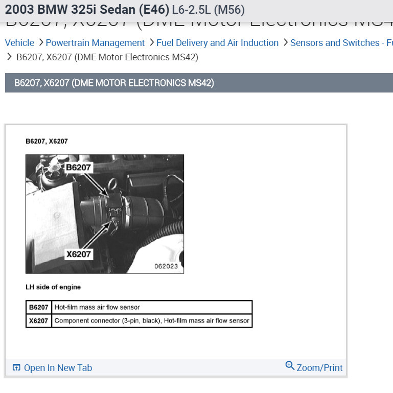

Try disconnecting the MAF sensor.

IAC: You can also try disconnecting this electrically. The idle might stabilize at a higher RPM. Disconnect and re-connect with the car off.
The MAF sensor sometimes does not set a code. With it disconnected, the car generally is driveable, but not quite right.

Disconnected the MAF sensor and it runs much better! High idle but much less of a problem. Should I be getting a can of MAF cleaner?
Should I still try and disconnect the IAC valve? (do you mean just unplug it and plug it back in immediately while the car is off or actually trying to run the car with it unplugged?)
