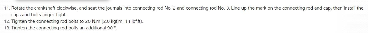

I rebuilt my engine, but I do not know the connecting rod bolt torque spec.

I had to attach the directions and specs in pictures. Check out the diagrams (Below). Please let us know if you need anything else to get the problem fixed. Let me know if this helps.
