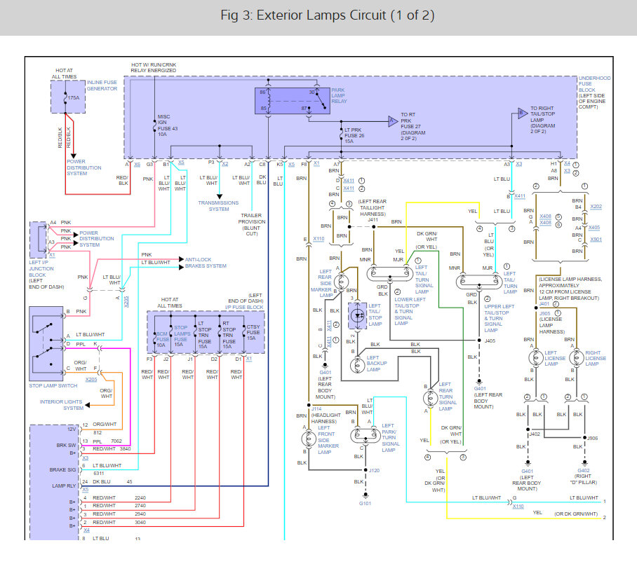

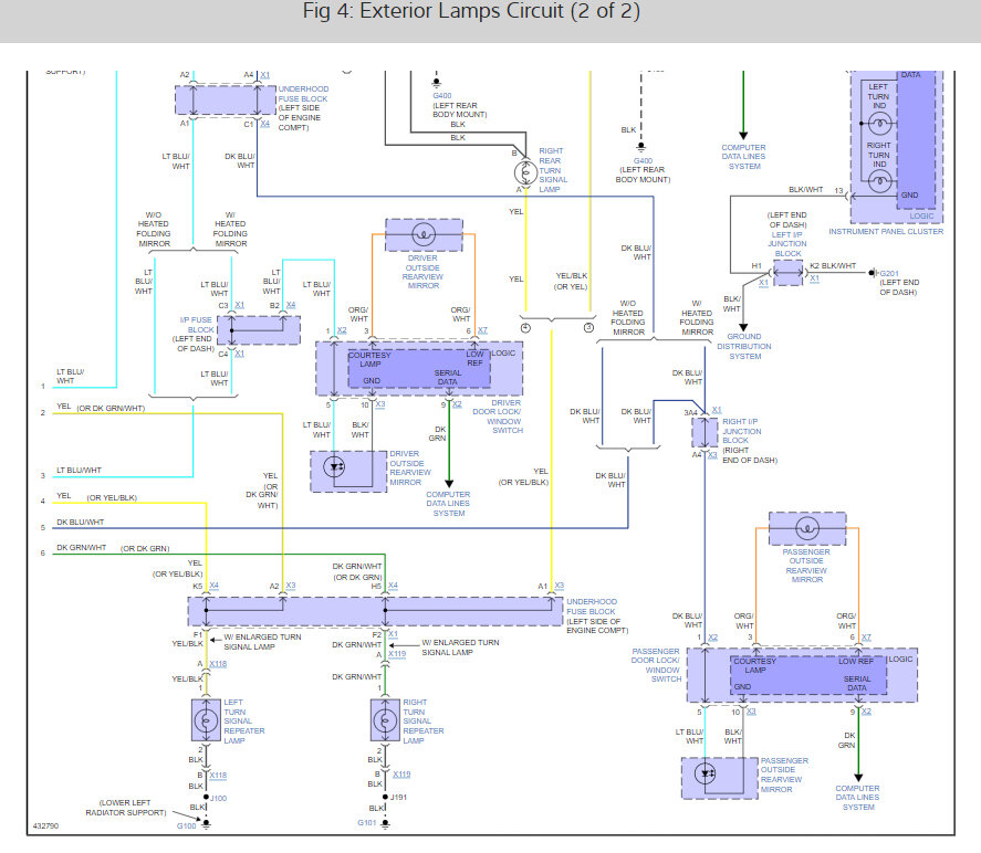

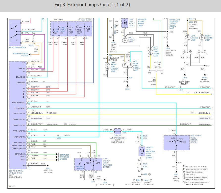

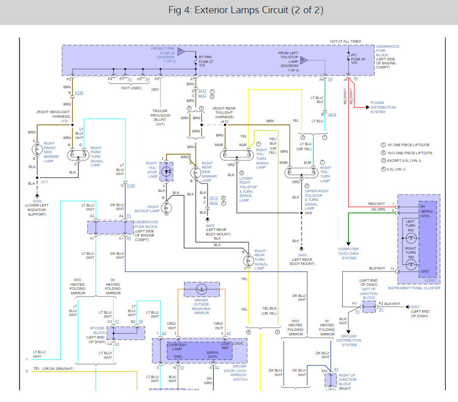

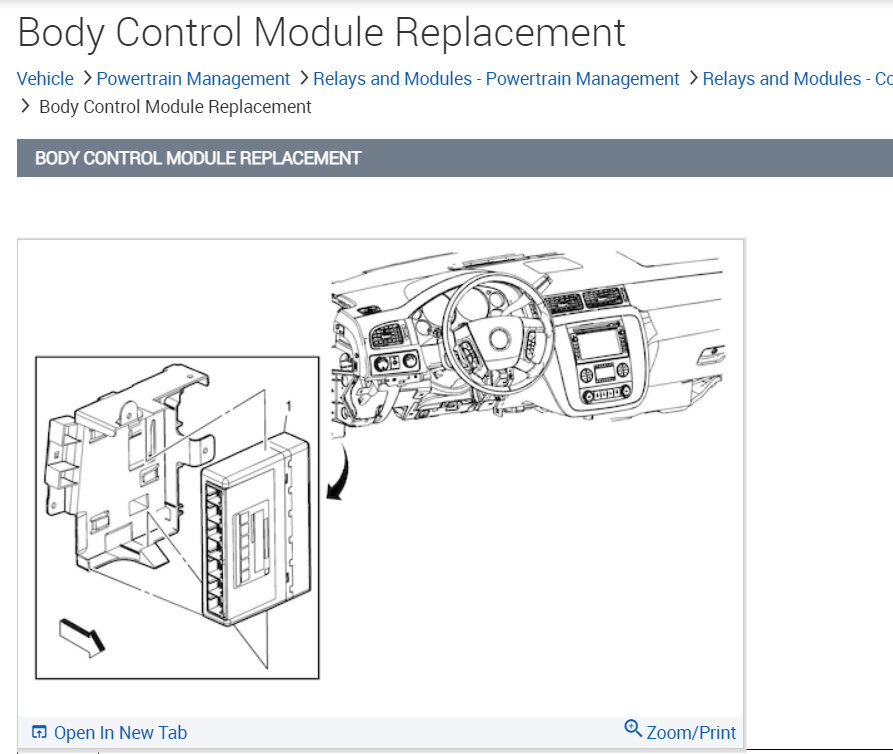

The right blinker has stopped working. It was intermittent but now has completely stopped. I have checked all the fuses I could find and changed the blinker assembly on the column to no avail. Also, curiously the right side of the hazard lights still work and are the same bulb/filament.
Thanks
Oct 17, 2022 at 2:43 AM
  • 55,267 POSTS

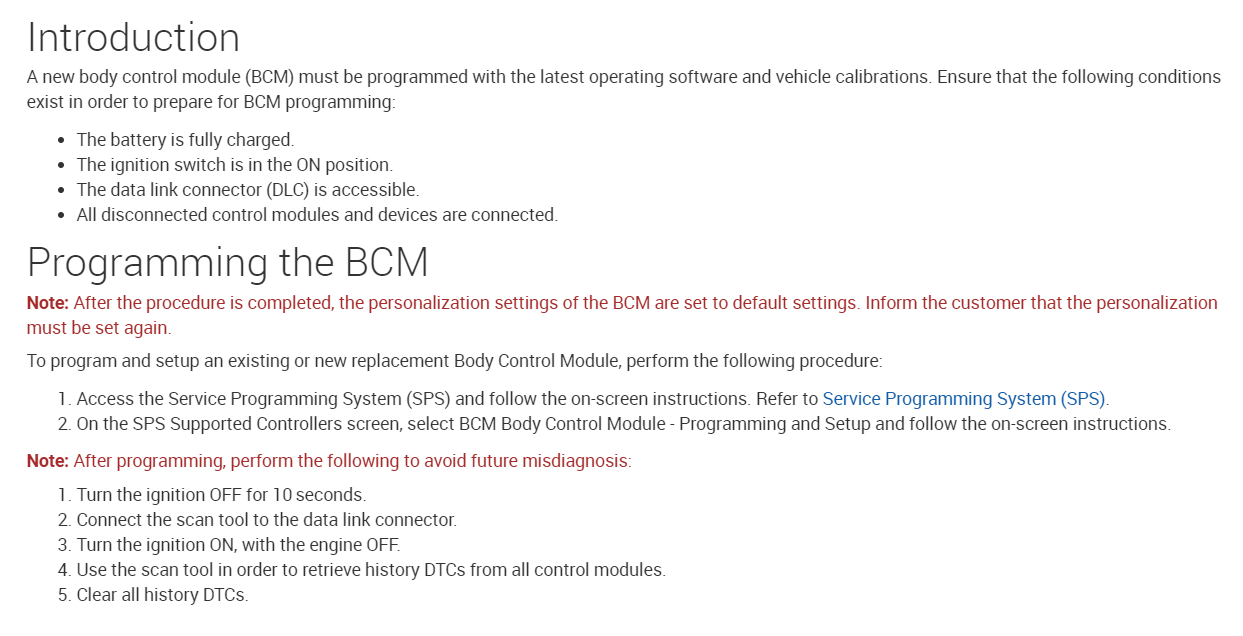

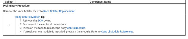

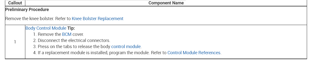

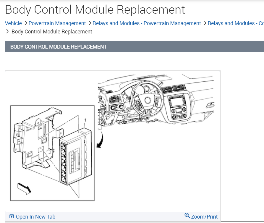

The right turn signal is controlled by the BCM, so it sounds like it is not working. here are the blinker wiring diagrams so you can see how the system works and the location and instructions on how to change the BCM out. You can get a rebuilt BCM by searching Google or eBay, just have your VIN number ready. To confirm this is the problem you can do a CAN SCAN which is easy to do. You can get a CAN scanner (Controller Area Network) from Amazon for about $36.00.
https://youtu.be/u-4syLc-ifQ
and
Amazon CAN scanner link for about $35.00.
https://amzn.to/3R9lJ60
Check out the images (below). Let us know what happens and please upload pictures or videos of the problem.
