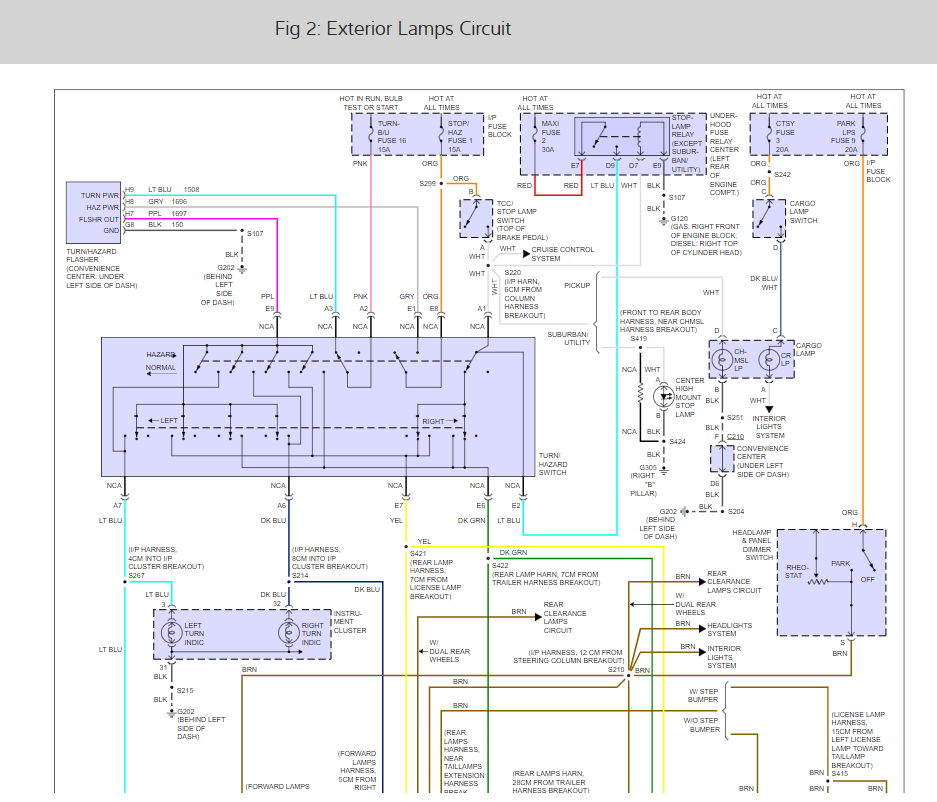

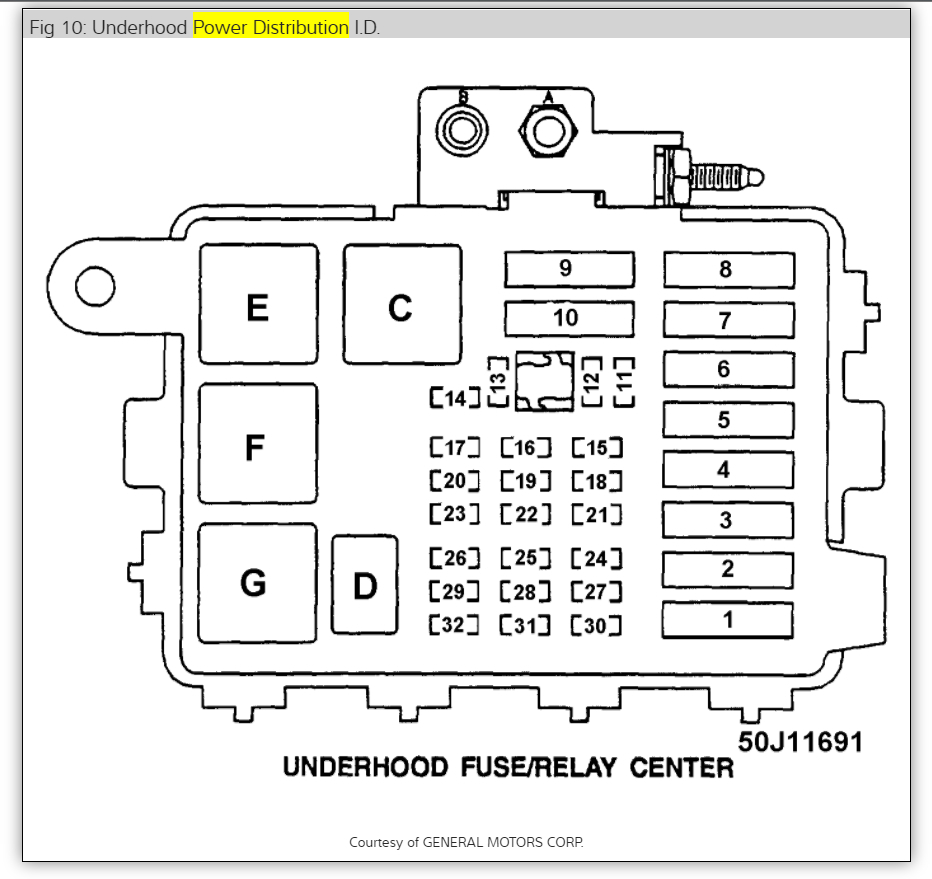

Stupid me was disconnecting my trailer from my Sub last night in the rain and forgot to make sure the car was off completely. There was a short in the wiring and I lost taillights, dash lights and turn signals. Replaced fuses and flash combo relay and got everything back but the turn signals. Hazard lights still work fine so I know the bulbs are good but I can not for the life of me figure out why my turn signals won't come back on. I have no signal indicators on the dash and not signals at all 4 corners. Is there some other relay I should change?

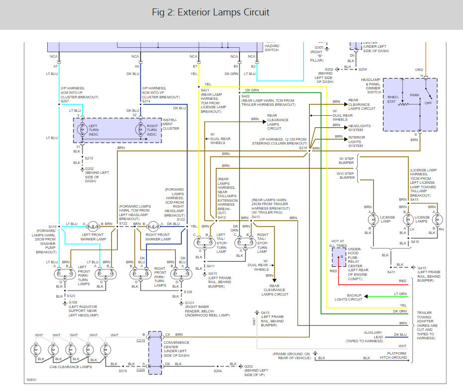

It sounds like you cooked the flasher in the convenience center here is the wiring diagrams so you can see how the system works and the flasher location so you can change it out.
Saturday, April 11th, 2009 AT 8:14 PM
JETZOMMER
Thanks it was the flashert I got a new one for $34.00 you guys are the best!

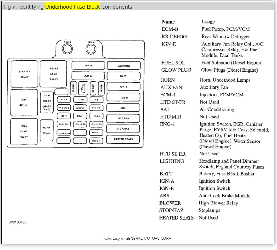

Change the Stop hazard relay in the fuse box. Mind did the same thing
