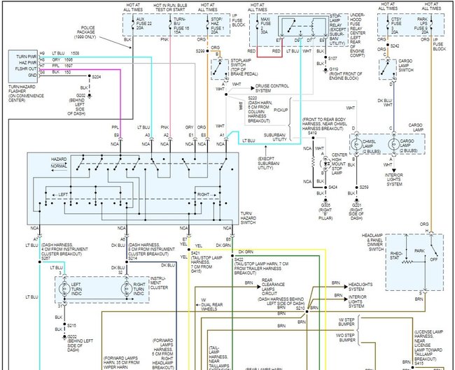

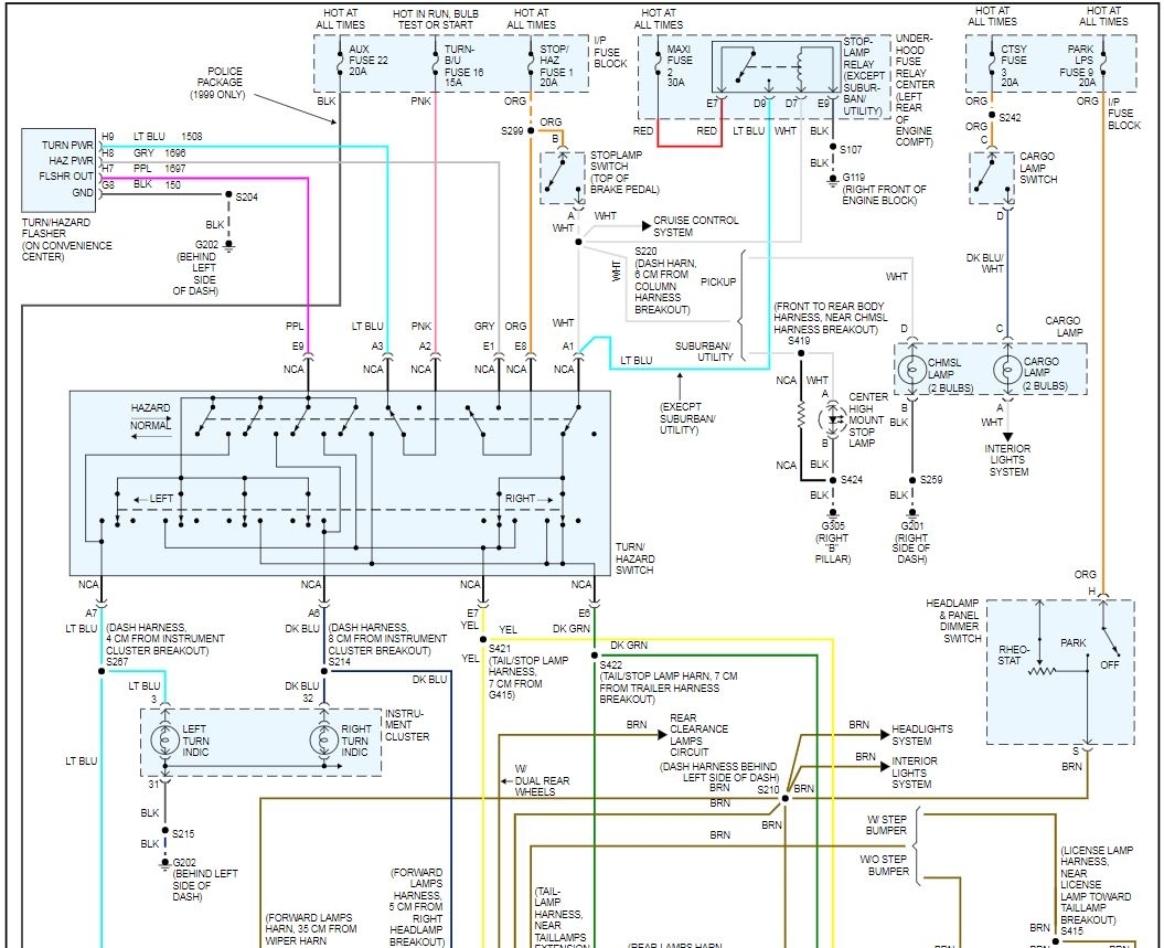

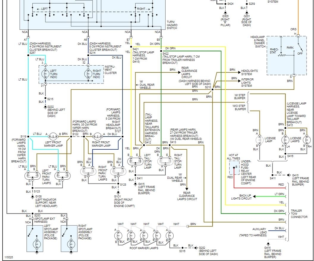

I have noticed now that wehn I have my head light on my left trun signal wil not flash. If I trun off the light it will work again but all of the dash lights bling with the turn signal. I have also noticed that the third brake light is always on. Also when I am Getting out and I step on the brake the warning buzzer saying I have left my headlights on buzzes. And last Now the cruse control is not working. I know this is a lot of things wrong but they all started around the same time and I think it is a common problem. Can you tell me what may be wrong. Thanks in advance

Have the brake light circuit checked and especially the turn/hazard switch
Heres a guide on testing wiring, it will help
Wiring diagram is attached below
-1

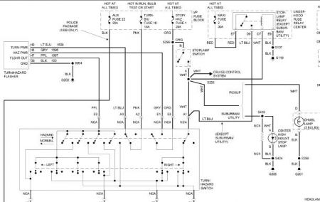

Does the high-mount brake lite work? Starting to look like a problem with the turn switch or wiring circuit in the steering column. The orange wire to the brake switch, is hot all the time. When the brake switch is activated, the white wire carries that voltage to the turn switch, for the lower brake lites.
https://www.2carpros.com/forum/automotive_pictures/170934_suburban_wiring_1.jpg

Vehicle as above: right turn signal works fine, but when selecting the left turn signal the entire "emergency flasher/hazzard lights" system flashes - not just the left turn indicator lights. I checked all the bulbs and all fuses and even pulled the dash and looked for any loose or contacting wires - none found. This started about three weeks ago, and during that period of time this has happened four times but the fault usually corrected itself after a couple attempts at using the left signal. Today, after about an hour of driving around town, it started again and has not corrected itself. During todays incident, I attempted to wiggle the emergency flasher and cycled both the left and right turn signal numerous times to no positive result. I think this car has two flasher (one for turn signals and one for the hazzard lights) but this problem is so different than any other turn signal/flasher problem I have had. Though I am an above average wrench, electrical stuff (especially around air bags) really is my weak link. I suspect a short or maybe bad turn signal switch itself. Could you folks offer any solid ideas or guidance from your end?

That sub has a turn signal/flasher module in the fuse panel on the left end of the dash. Test the dark green wire for power when left signal is on, if ok then the module is bad.

The wire to the fuse is power in. To find the wire go to the turn sig switch plug, should be less wires there to confuse. The circuit board may be shorting and has expanded enough with the heat to not do it
