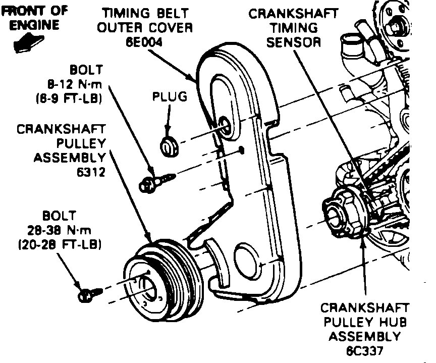

I am trying to replace the crank shaft motor sensor on my truck. I got the timing chain cover off but I cannot figure out how to get the back of the cover off.

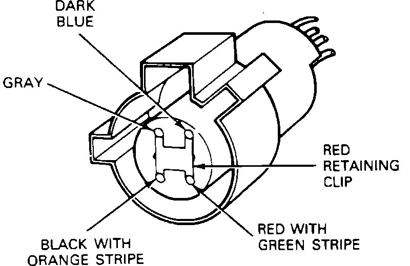

Crankshaft Position Sensor Connector
Pic 1
1. Disconnect the crankshaft timing sensor assembly electrical connector.
2. If the colors differ from the image, make a chart showing the locations of the wires (by color). Remove the wires from the sensor connector by removing the red retaining clip and then the wires.

Timing Belt Cover Area Exploded View
Pic 2
4. Remove the four crankshaft pulley assembly bolts and remove the pulley.
5. Remove the timing belt outer cover.

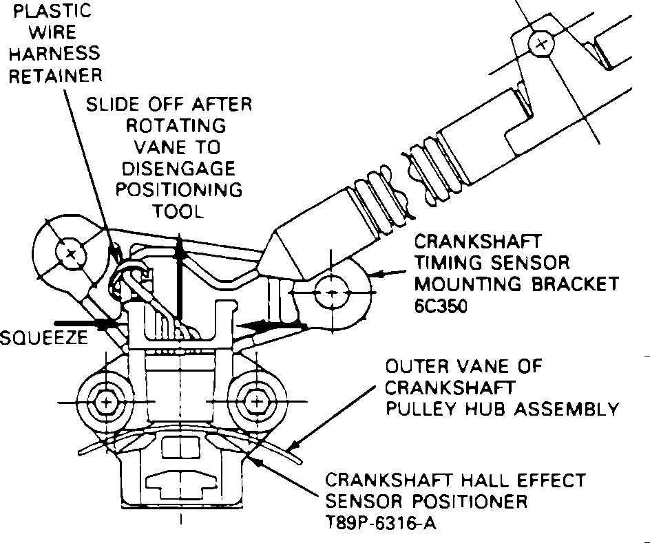

6. Rotate the crankshaft until the keyway is at the ten o'clock position. This will place the vane window of both the inner and outer cups over the crankshaft timing sensor assembly.
7. Remove the two crankshaft timing sensor assembly retaining bolts.
8. Remove the plastic wire harness retainer that holds the sensor harness to its mounting bracket.
9. Remove the crankshaft timing sensor assembly, sliding the electrical wires out from behind the inner timing belt cover.

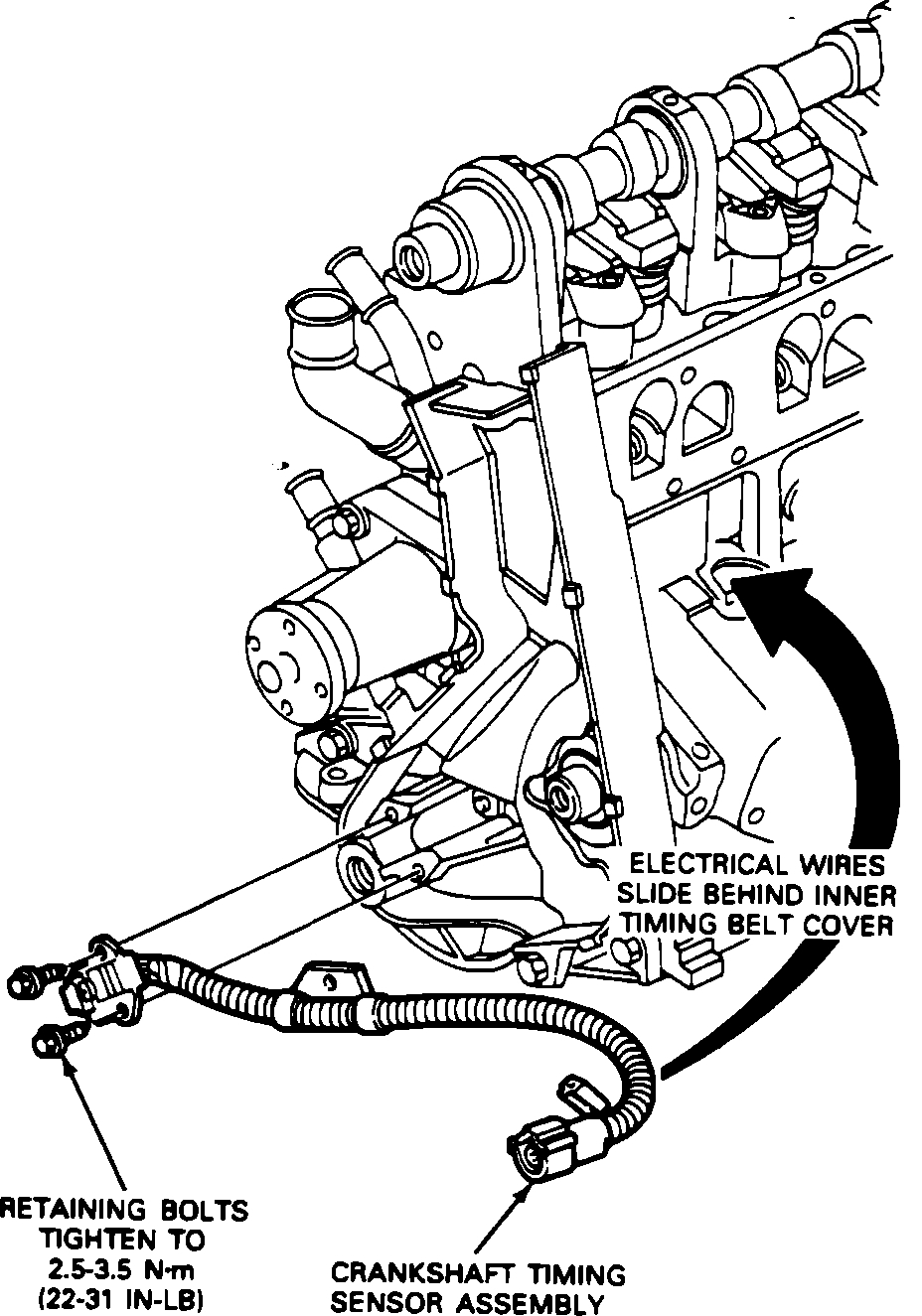

INSTALLATION
Pic 3
1. Position the crankshaft timing sensor assembly by sliding the electrical wires behind the inner timing belt cover, then loosely install the retaining bolts. Do not tighten the bolts at this time.
2. Install the large electrical connector onto the crankshaft timing sensor harness.
NOTE: Make sure the wires are located in their original positions. Refer to the chart made in REMOVAL STEP 2.
3. Reconnect the crankshaft timing sensor electrical connectors to the engine harness.
Aligning Crankshaft Position Sensor
pic 4
4. Rotate the crankshaft so that the outer vane on the crankshaft pulley hub engages both sides of the crankshaft Hall effect sensor positioner (Ford T89P-6316-A, or equivalent), then tighten the sensor retaining bolts to 22-31 in lb (2.5-3.5 Nm).
5. Rotate the crankshaft until the crankshaft pulley vane clears the positioning tool, then remove the tool.
6. Install a new plastic wire harness retainer to secure the crankshaft timing sensor harness to its mounting bracket, trimming off any excess retainer.
