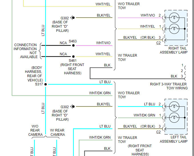

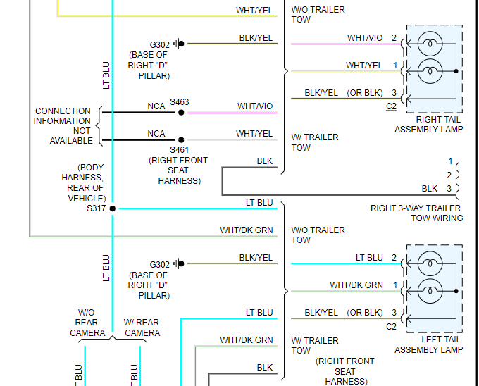

Here is the wiring diagram for the rear brake and taillight circuit. If you switch the wires around you will accomplish what you want to do. Hope this helps and thanks again for using 2CarPros.
