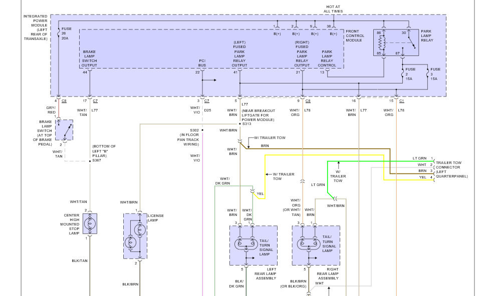

My brake lights are staying on for several minutes after each time I use them. I checked the brake switch. The lights stay on with the brake switch removed.
Jul 10, 2017 at 2:24 AM
HMAC300
  • 48,601 POSTS
This can be what is called the integrated power module problem. The brake lights enter and exit that a mechanic will need to scan for codes. the brake light switch is probably sending the signal then ending but TPIM module is slow to respond.
