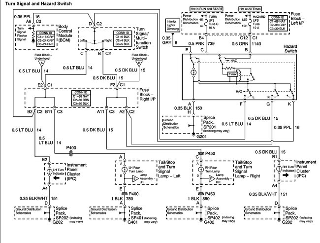

I was having an issue with my blinkers so I researched and found that replacing the hazard switch (button) could fix it. I replaced it, but now the blinkers are too fast. Hazards are normal speed but blinkers are not. Any idea?
Jan 23, 2018 at 9:23 AM
STEVE W.
  • 15,314 POSTS
First double check that all of the bulbs in the turn system are working. Do they flash fast on both sides or just one? What was the original issue with the signals?
Jan 23, 2018 at 4:43 PM
PLUXO
  • 71 POSTS
All the bulbs work. Blinkers in front and back flash fast. Driver side headlight is out. Original issue was that I had to press the hazards to make the turn signals work and sometimes that would not even work.
Jan 23, 2018 at 5:13 PM
STEVE W.
  • 15,314 POSTS
About the only thing that can make them fast is either a bad flasher or if the lights are the wrong type. In your case the hazard switch is also the turn signal flasher and it is electronic so bulb loading will not alter its flash speed. Looking at the wiring and the way the system works my bet is the new switch is defective internally. It is the only item that is common to both turn signals.

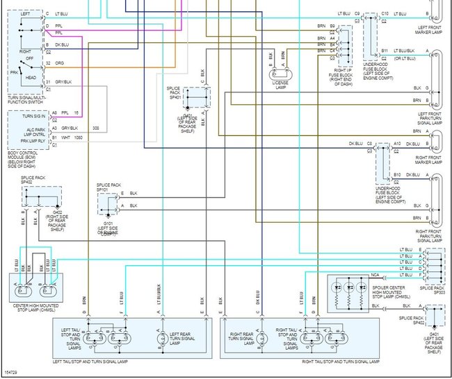

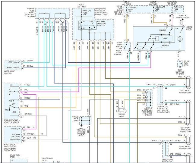

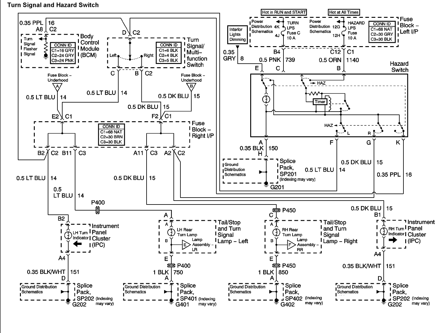

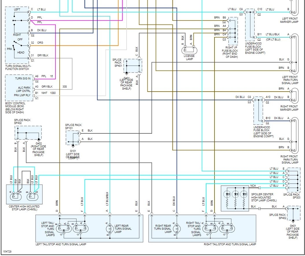

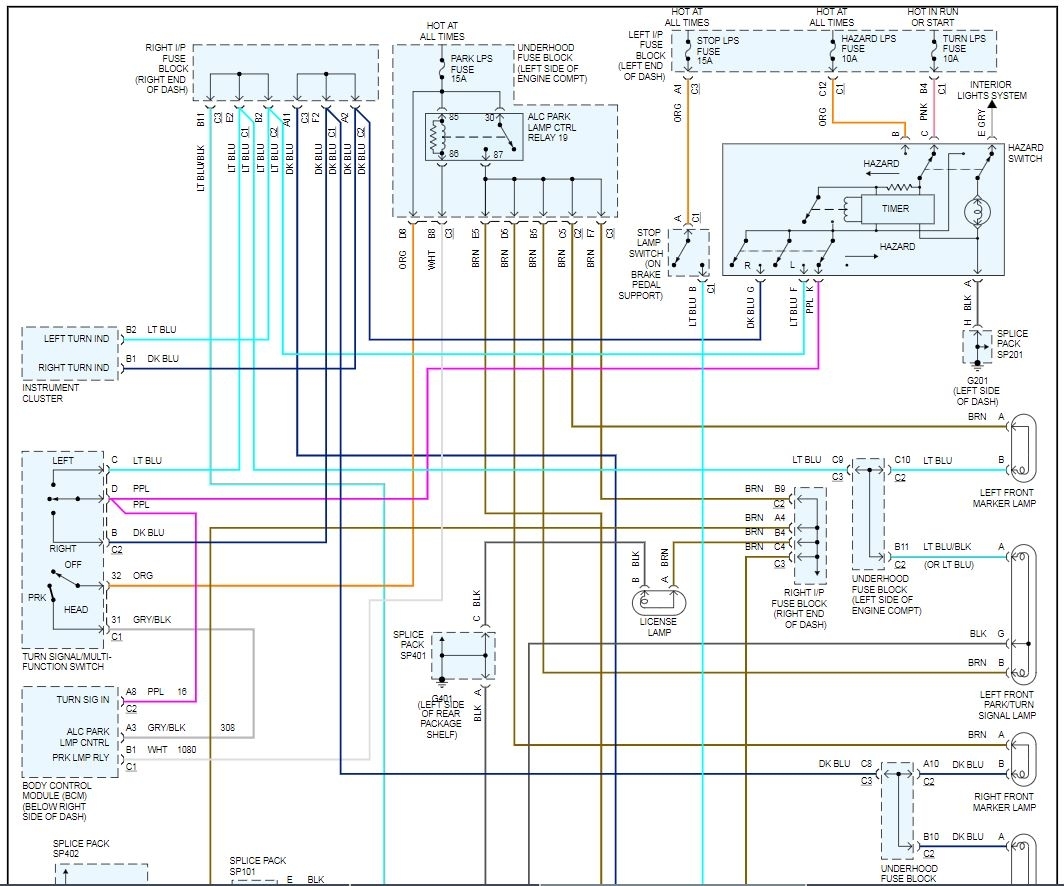

The best suspect is the flasher assembly, which is now built into the hazard switch. They are no longer the common sense simple $2.99 flasher. They are now an expensive and fairly unreliable electronic assembly.
Read the guide below on testing wiring , it will help
The wiring diagrams for the turn signals are attached below.
