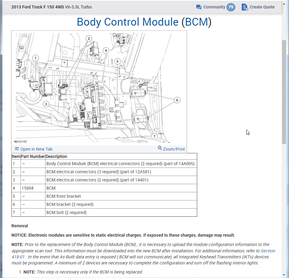

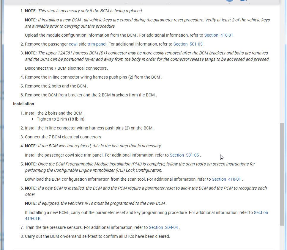

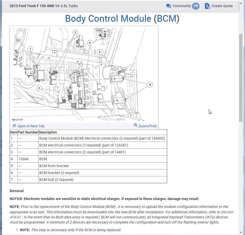

What are the steps to replace a fuse panel box on the passenger compartment and will it have to be reprogrammed?
Mar 22, 2016 at 2:40 PM

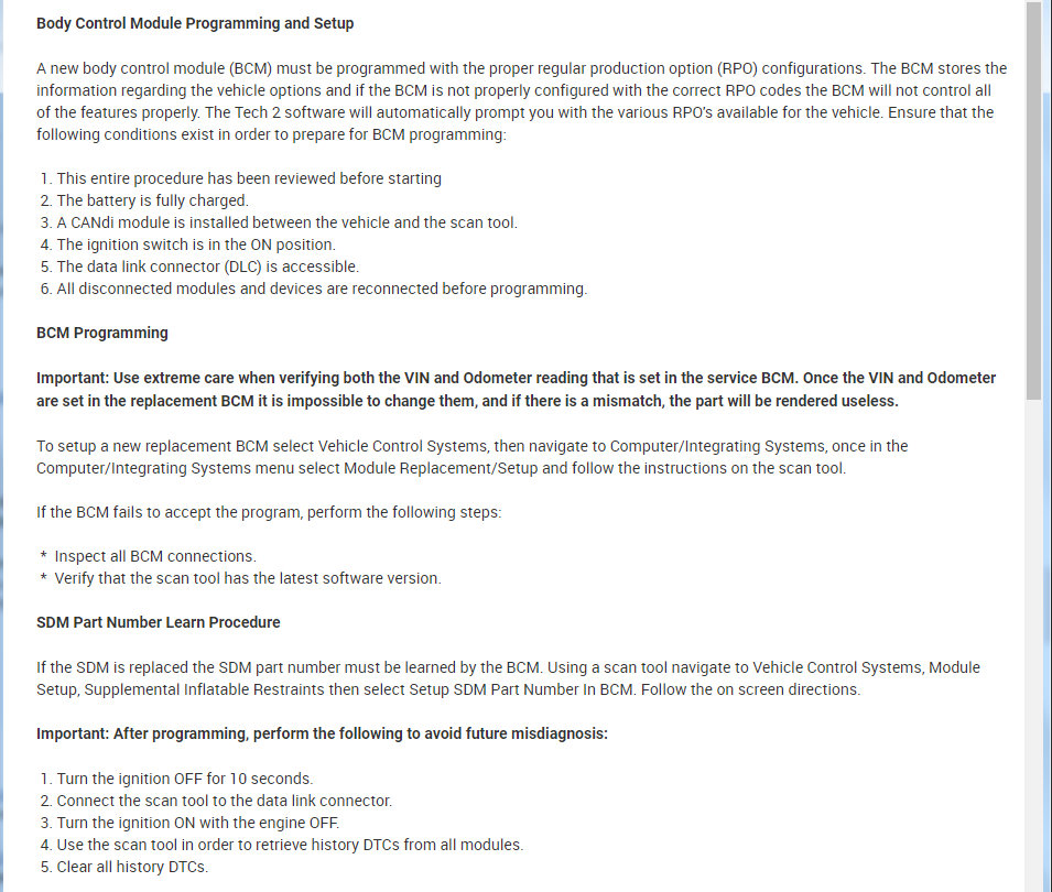

You will require a scan tool capable of performing the needed functions of programming the PCM and BCM after the BCM replacement. I attached the info needed.

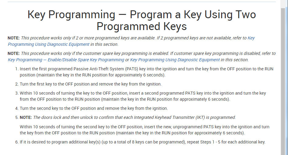

Also, you are going to have to program the keys to the new BCM as well.
Let us know if you require more information. Thanks
