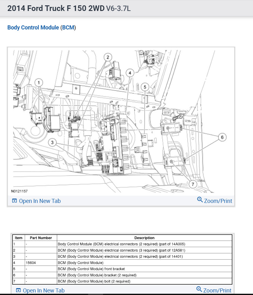

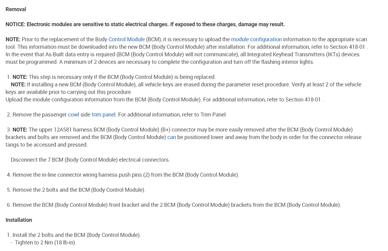

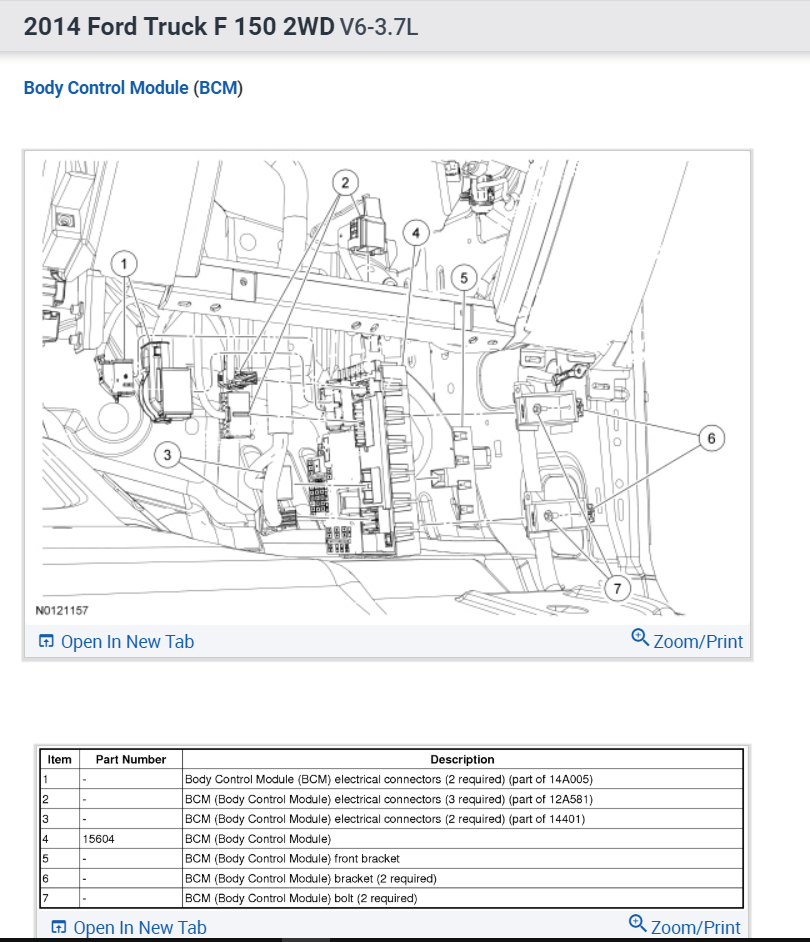

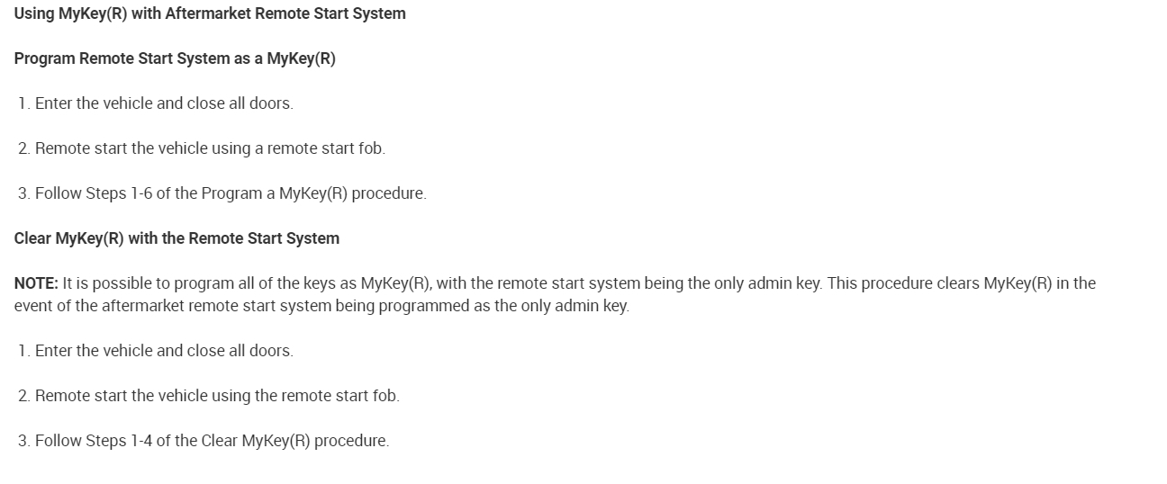

the body control module controls about everything inside truck and outside sometimes. it' deals with lights, radio, cameras etc. it may be a connection problem or what is called a can bus which several modules are connected on same line and if one goes out it cause a a problem. It can be a shorted wire, water, etc. to cause it to go out. Or even a surge of electricity that is to high in voltage.

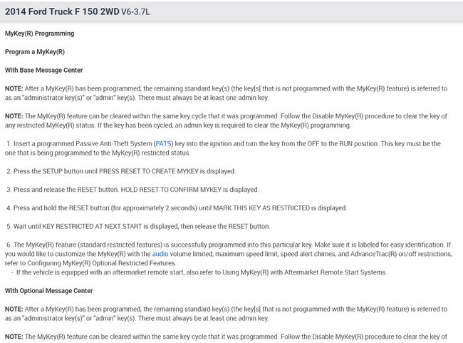

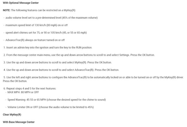

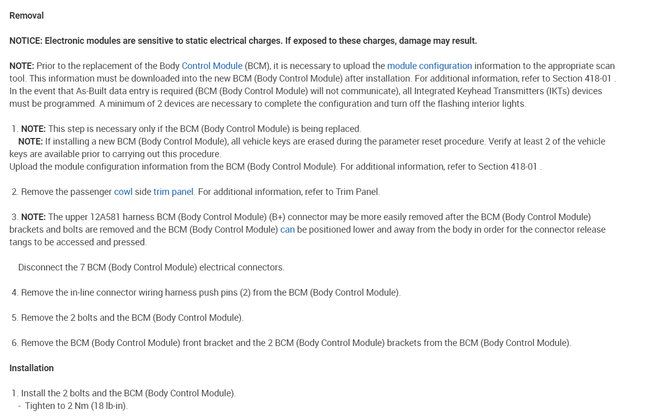

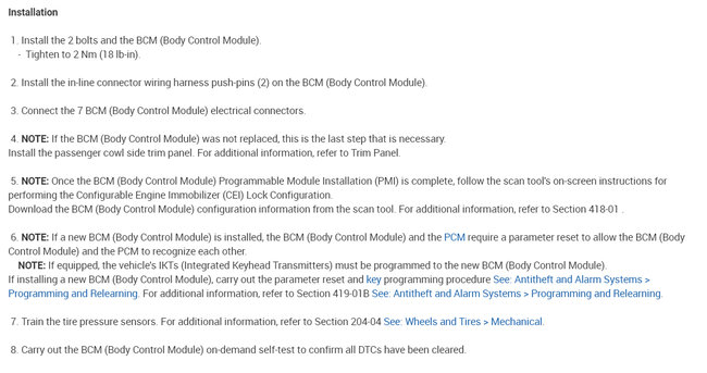

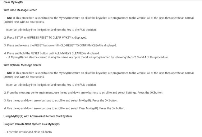

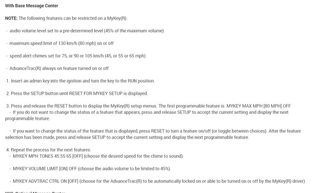

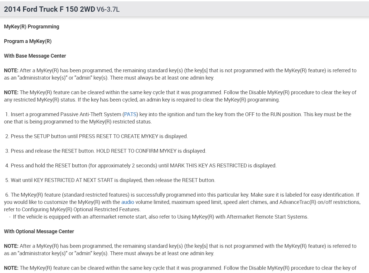

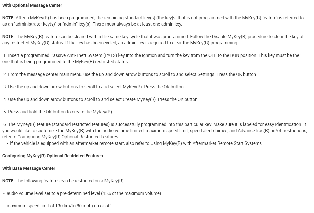

Here are the instructions in the diagrams below on how to replace the BCM and reset the ignition keys as well. It must be done at the same time.
