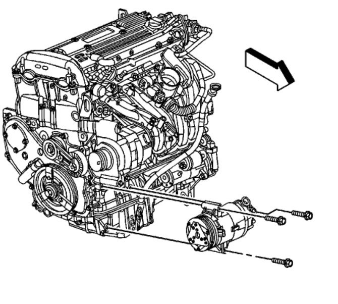

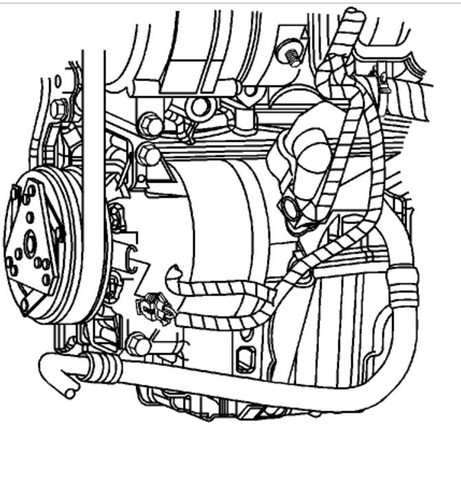

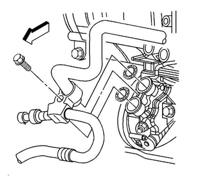

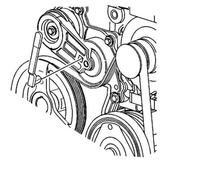

Yep we got you covered Here are instructions on how to replace the compressor and some diagrams of what it will be like on your car.
https://www.2carpros.com/articles/replace-air-conditioner-compressor
and
