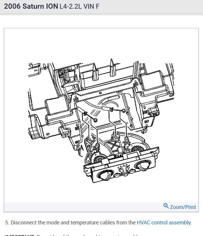

A/C blows warm air but Freon is full. what could the problem be?
Nov 8, 2009 at 2:29 PM
  • 75,988 POSTS
This can be because of a blown fuse or a blend door actuator is not working right here is a guide to help you check the fuses.
Here is a guide to help you with the blend door actuator.
Check out the diagrams (Below). Please run this test and get back to us.
Cheers

I had this problem with y car it ended up being the mode cam was all jacked up here is what the part looks like below. FYI
