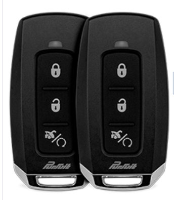

So I just got remote start installed on my car, when I do it and then go to press the brake and drive it shuts off as soon as I hit the brake. Is this normal? Is there a take over procedure for this? Also the light knob does not let me manually turn the lights off anymore. It was left partially open when I got it back. I start the car, get in before 45 seconds is up, then I push the brake and it shuts off.

The key says pursuit. When I push the button for the push start it just turns the car off. I assume there is no way to work around it. Is there a reason why the lights won’t turn off on their own if I want to shut them off manually? I wouldn’t think they would need to tap into that.

I had someone else install it. The key fob on the right is what mine looks like. I am not sure on the product number because I never saw the box. I have a new key fob and the OEM key fob.

Clearly there is either an issue with the system that was installed as it is not compatible with the vehicle or it was not installed properly. Obviously I can't tell how they installed it but I would suggest taking it back and showing them what it does and they can try to figure out what they did or give you the detail about what it is and how they installed it so you and I can try to figure out what they did.
Sorry I can't pinpoint this but there are too many variables.
