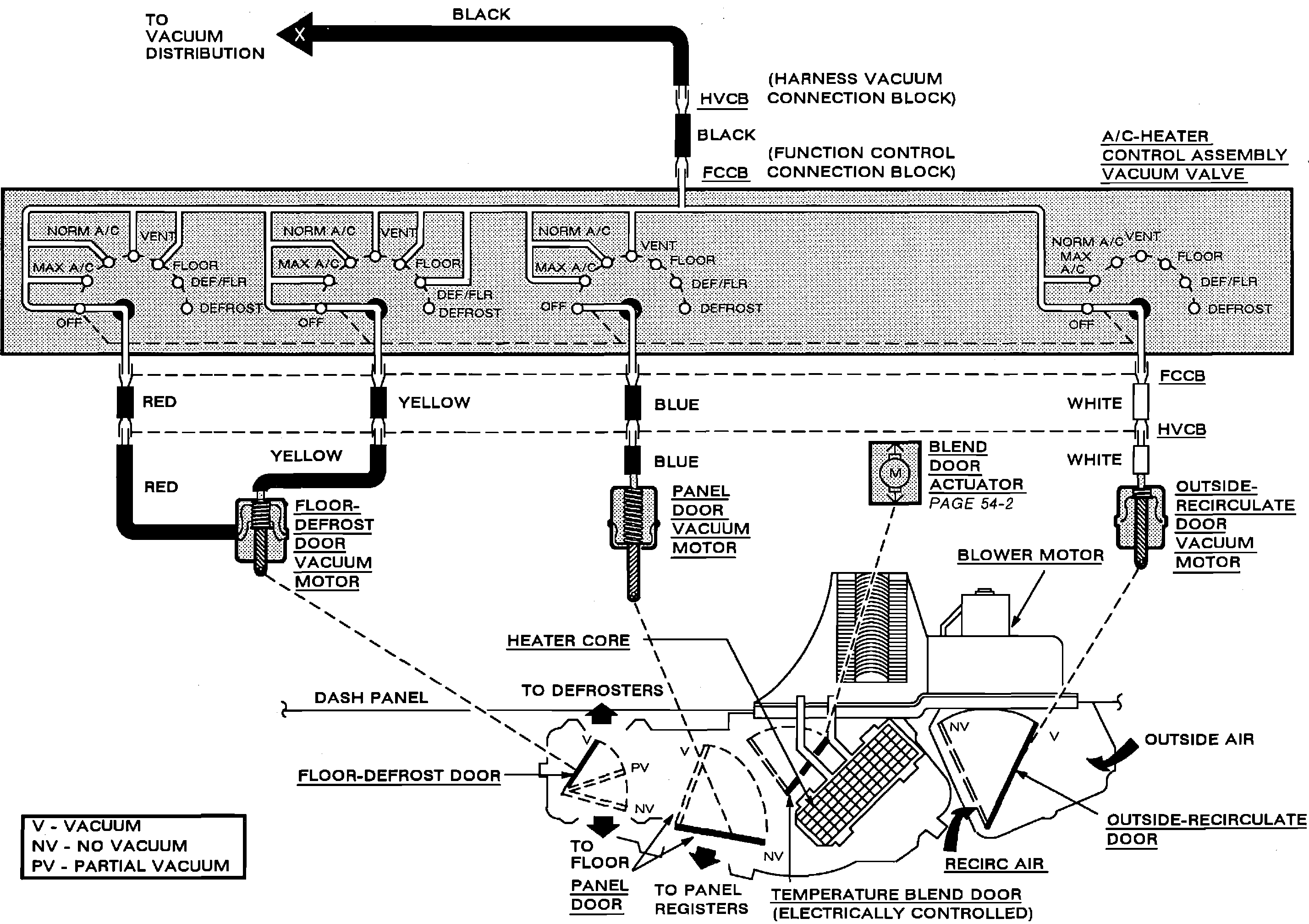

The actuator with the white hose is merely the re-circulation door and has nothing to do with your problem. As I understand it, you just cannot get full defrost. The actuator that gives you that is the one with the red and yellow hoses attached to it. It appears you are getting a full throw from that actuator so that tends to point to a problem with the door inside. A common thing to happen is a pencil or something like that will fall into the vent and jam up the door which could be broken by now. If you have access to a bore-scope, it may be helpful.
I am attaching a diagram of the vacuum hoses and doors.

I was actually think if a borescope would allow me to see anything. However, I was thinking I would use it on the actuator that has the blue line, that goes into the black box under the dash, because I cannot see what is connected to the other end of the actuator arm. The actuator with the red and yellow lines is easier to get to though. If I get a scope, would I go up through the floor vent or down through the windshield opening?

I was thinking down through the defrost vent to look for an obstacle.
Looking behind the actuator would be helpful also.

I guess I forgot and got too busy to let you know what I ended up doing. I never got a scope but instead did some digging and found I was able to disconnect the floor heat deflector. It took some work, including removal of both actuators. Upon removing the deflector, I was able to get a good look at the defrost door. It was working properly. I decided to check the panel (vent) door but could not get my hand/arm into the duct work. I snipped a thin piece of plastic used as a support for the deflector and could reach all the way into the panel (vent) chamber. I found the problem. The panel (vent) door had dislodges from its pivot and was simply moving back and forth when the actuator was moving, instead of open and close. Although by feel, I could not seem to get the door back into its "groove", I was able to easily close the door and now I get 99% of air out the floor and defrost vents. Not having panel (vent) air is not an issue at all especially now that it is cold. I use the floor/defrost or just defrost until everything is clear, then switch to floor only and it is perfect.
