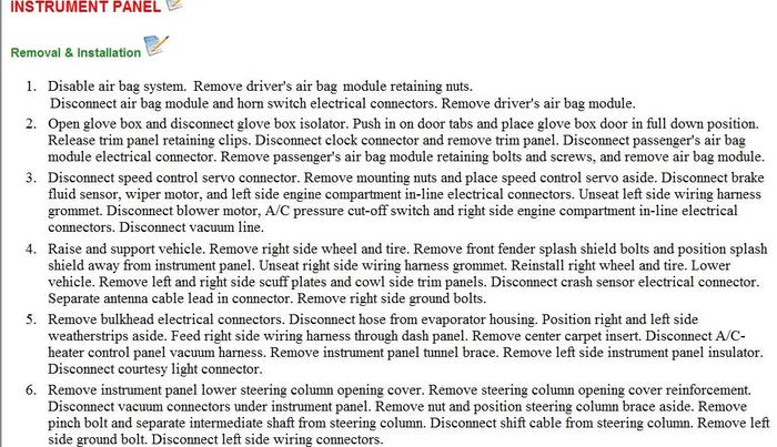

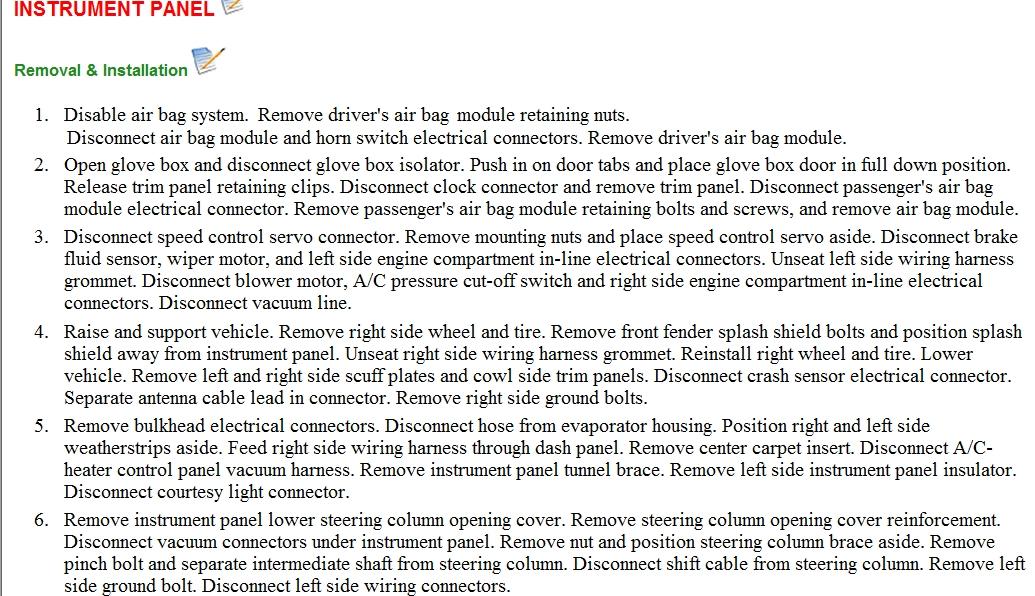

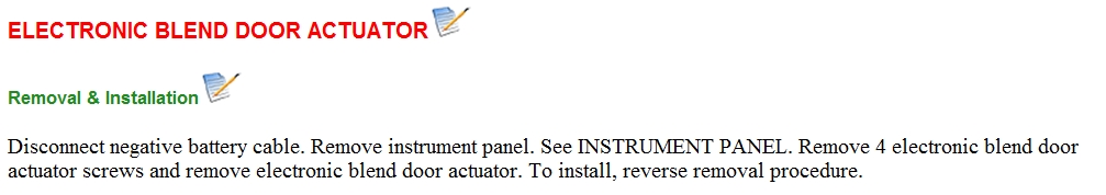

APLUS123
trying to removemy blend door motor on a 99 ford crown victoria where do i start?
Aug 6, 2019 at 10:24 AM (Merged)
BLUELIGHTNIN6
  • 16,542 POSTS
see steps attached
FIXITMR
  • 9,990 POSTS
i found a person who said they changed it thru the glove box. dont have details yet. gotta have small hands/tools he said.
