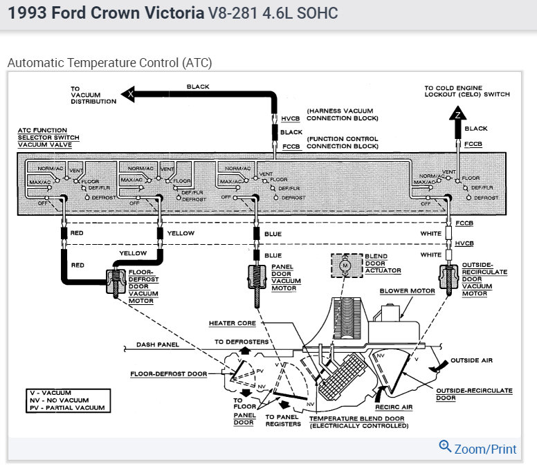

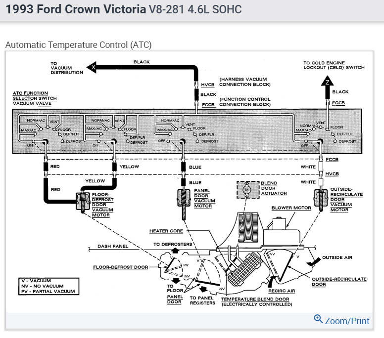

At the rear of the vacuum valve is there vacuum present at the valve and do you hear the blower motor running at high speed? Here is a diagram that show the vacuum line routing so we can see how the system works. Check out the diagrams (below). Please run this test and get back to us.

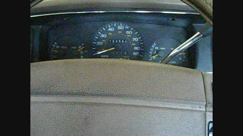

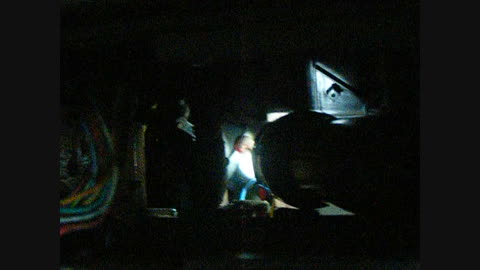

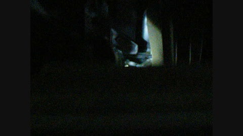

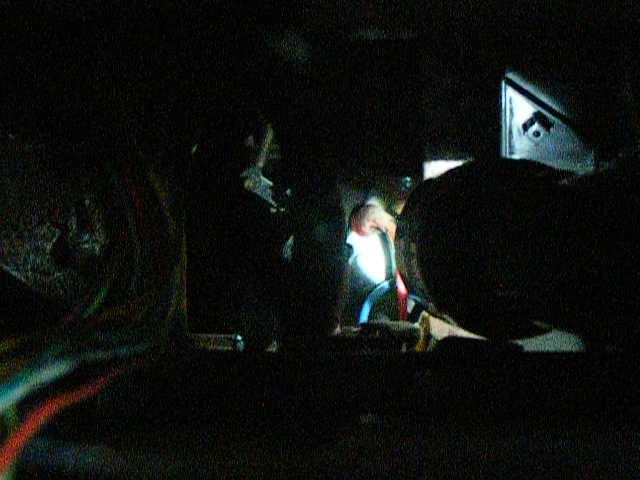

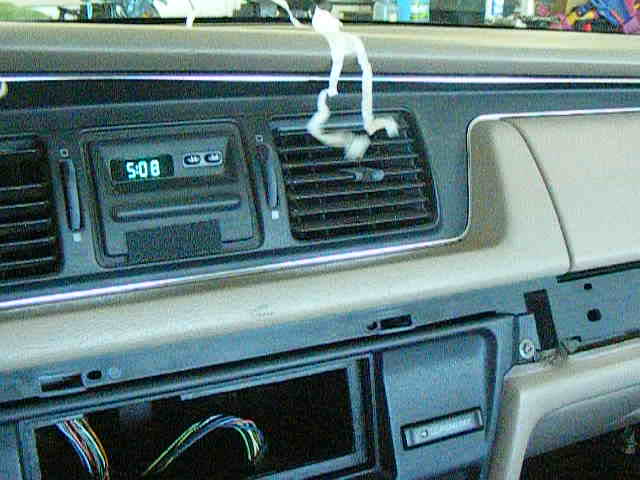

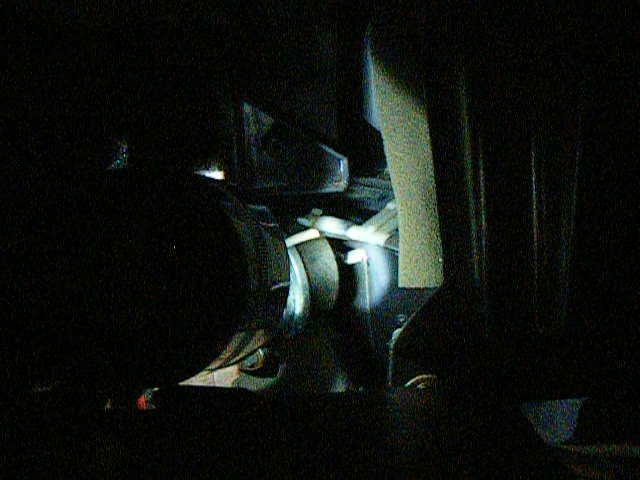

EPA223
  • 15 POSTS

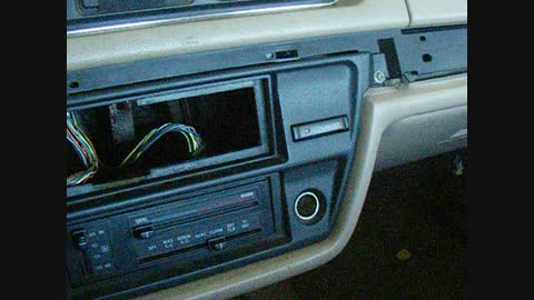

Hi Ken,
I can hear the vacuum hiss and clunking of doors when I move the selector through its different positions.
I shot a video, although I had to stop a few times, so it is on four different videos. I think it will show my issue. You may be able to notice on the right actuator, the arm moves up and down slightly as it moves in and out. I do not know if that has anything to do with my problem or not. Too bad I cannot see inside that black box.
Thanks again Ken,
Eric
Sep 12, 2018 at 4:47 PM
  • 54,837 POSTS

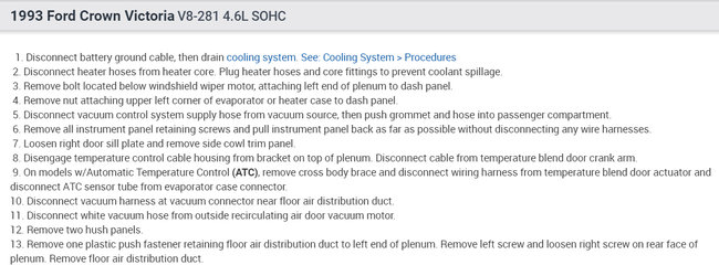

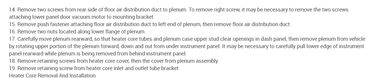

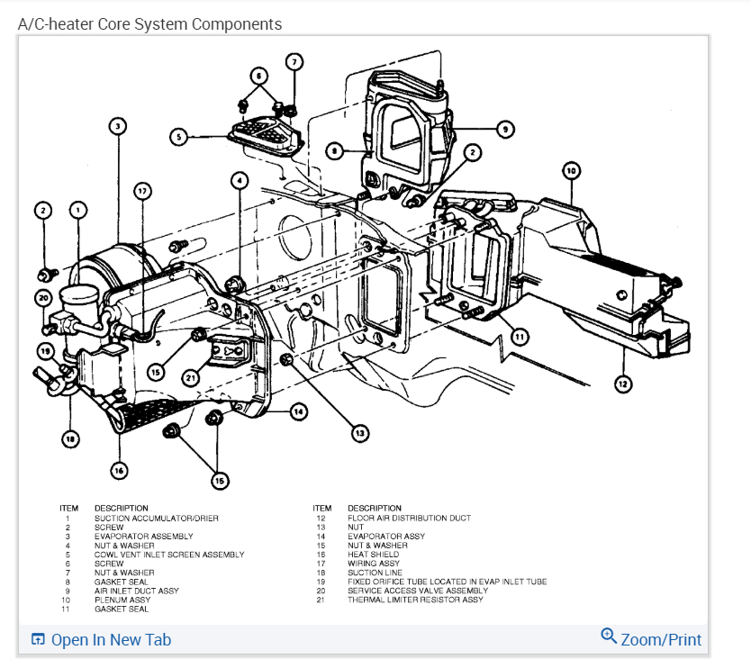

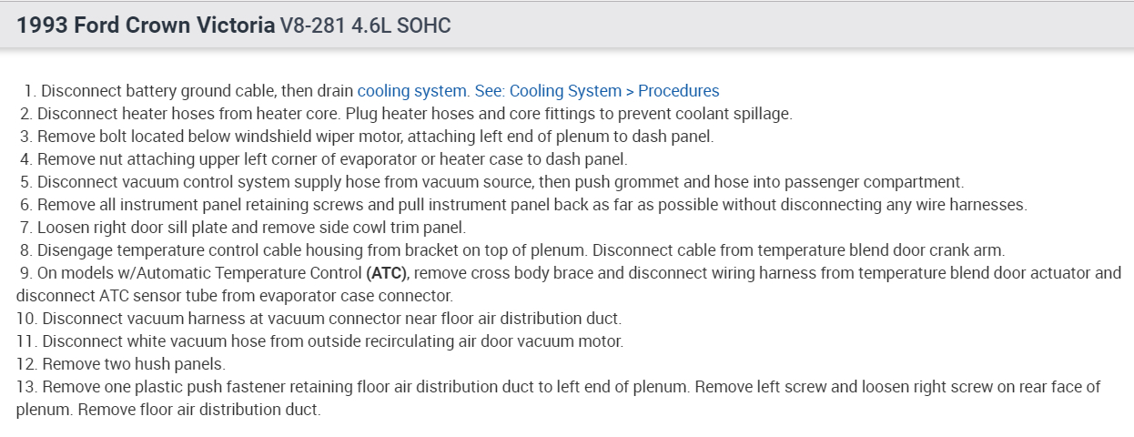

One of the better video demonstrations I have seen, nice work. :) The vacuum controls do not seem to be the issue. It is a mode problem for sure but since the actuator are working it only leaves the actual air door inside the plenum had broken loose for the pivot pin. This means the heater box will need to come out to fix it. I have had this happen only one time in my time so it is rare. Here are diagrams to help you get the job done you will need to vacuum down and recharge the AC system. Here is a guide and diagrams to help you get the job done.
This will kind of show you, check out the diagrams to see your car.
https://www.2carpros.com/articles/replace-heater-core
Sep 16, 2018 at 2:43 PM

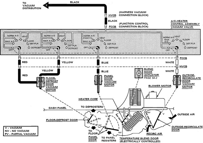

The actuator with the white hose is merely the re-circulation door and has nothing to do with your problem. As I understand it, you just cannot get full defrost. The actuator that gives you that is the one with the red and yellow hoses attached to it. It appears you are getting a full throw from that actuator so that tends to point to a problem with the door inside. A common thing to happen is a pencil or something like that will fall into the vent and jam up the door which could be broken by now. If you have access to a bore-scope, it may be helpful.
I am attaching a diagram of the vacuum hoses and doors.
