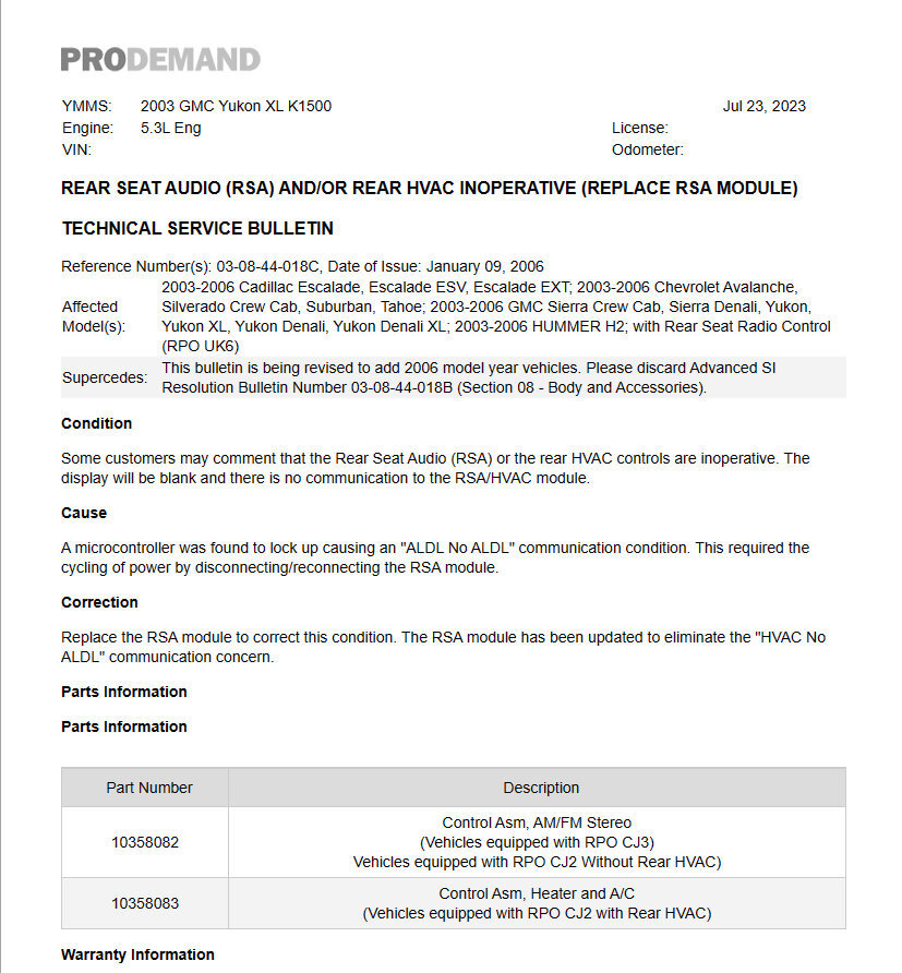

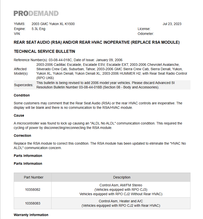

There is a technical Service Bulletin that matches your issue, and this will tell me if it pertains to your particular application.

BRENDON S
  • 653 POSTS
Hello GRAHAM78,
I have added the TSB for you. (see image)
Looks like there is an updated module.

GRAHAM78
  • 10 POSTS
So that would make the overhead controls for the rear not work also? I swapped that with one from a known working unit, it didn't help. But it is not the newest part number.
Jul 23, 2023 at 2:18 AM
BRENDON S
  • 653 POSTS
Hello GRAHAM78,
If it's the old part number and not the updated one, then it is subject to the same TSB and could have the same issue.
Looks like you got power back there, but for some reason there doesn't seem to be any communication.
Since you already swapped it with a known good one though, let me take a look and see if I can find anything else for you.

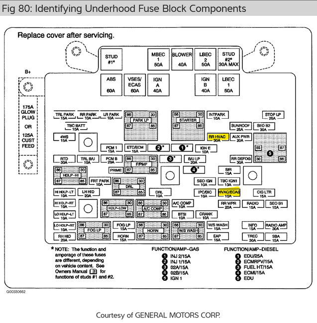

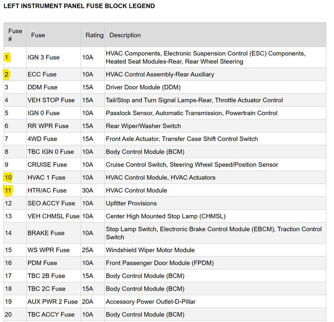

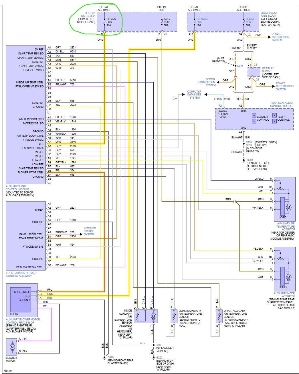

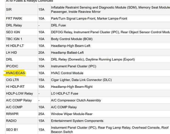

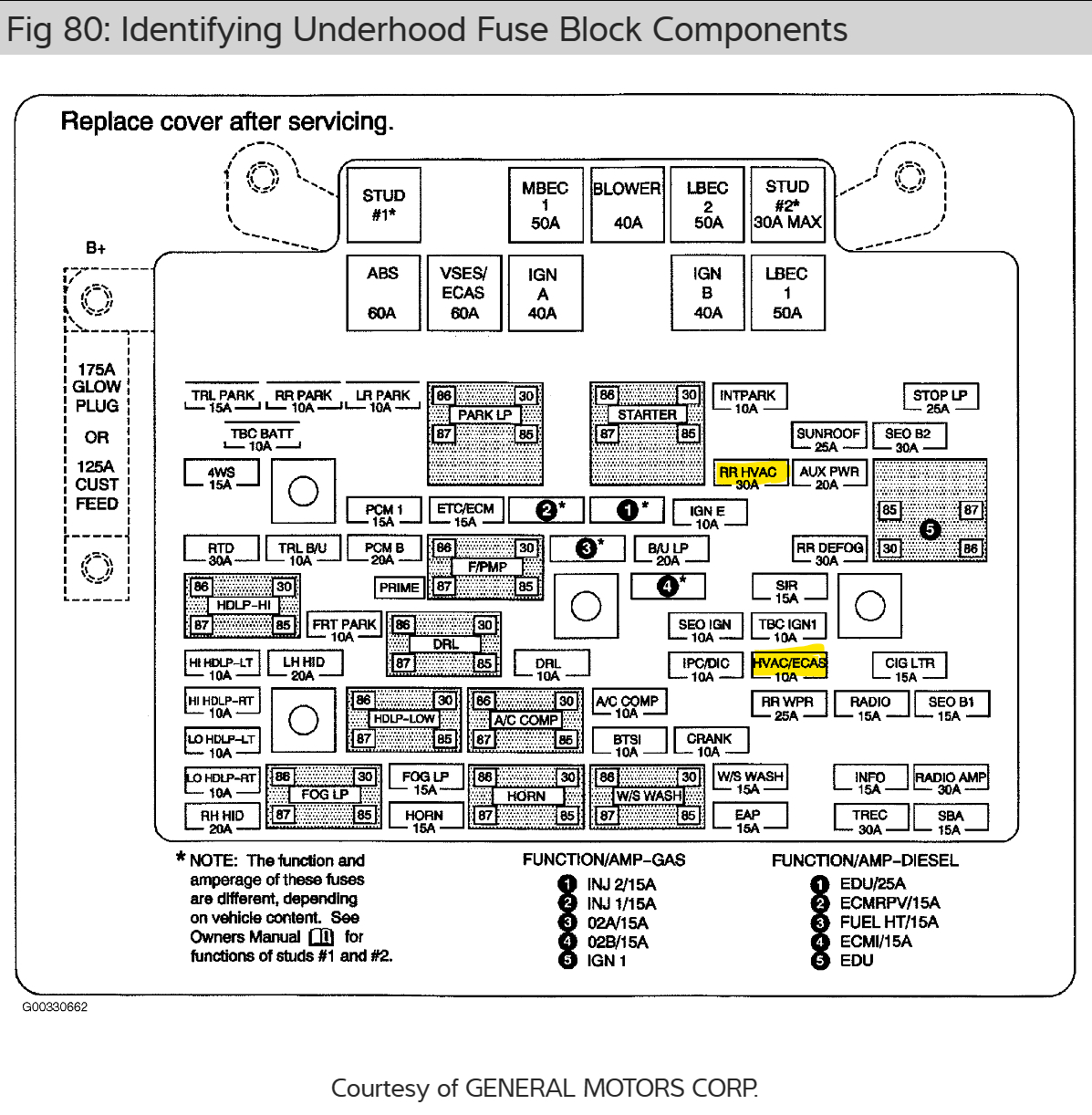

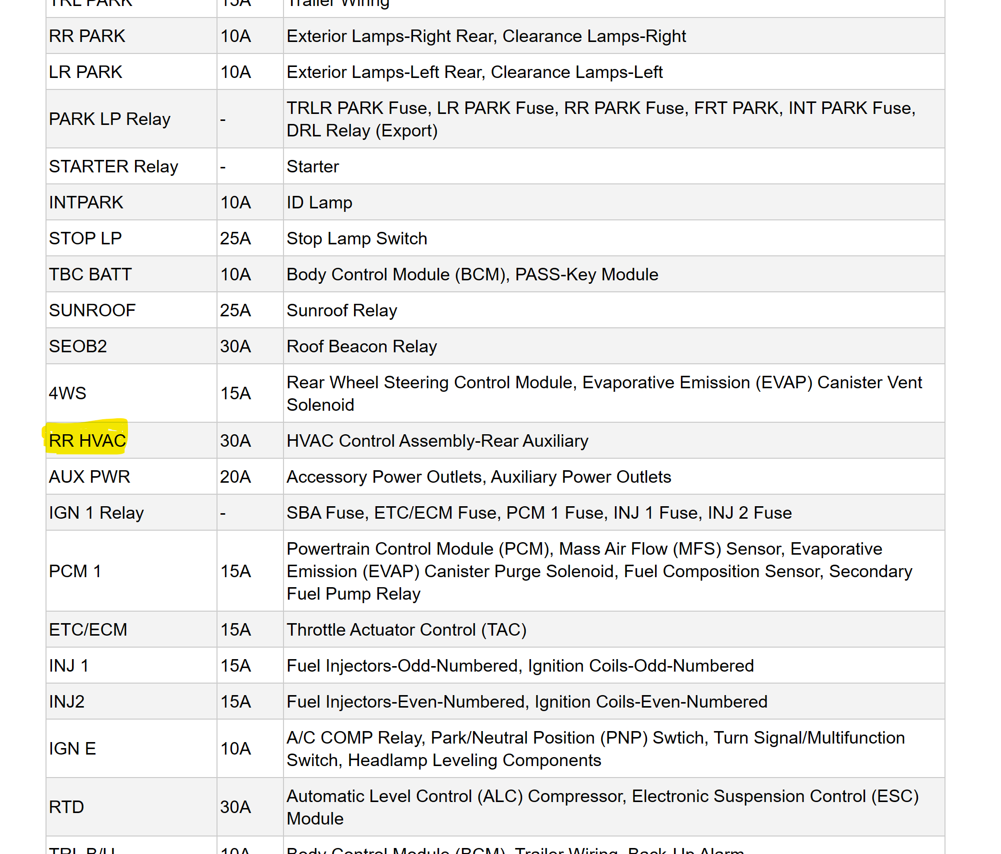

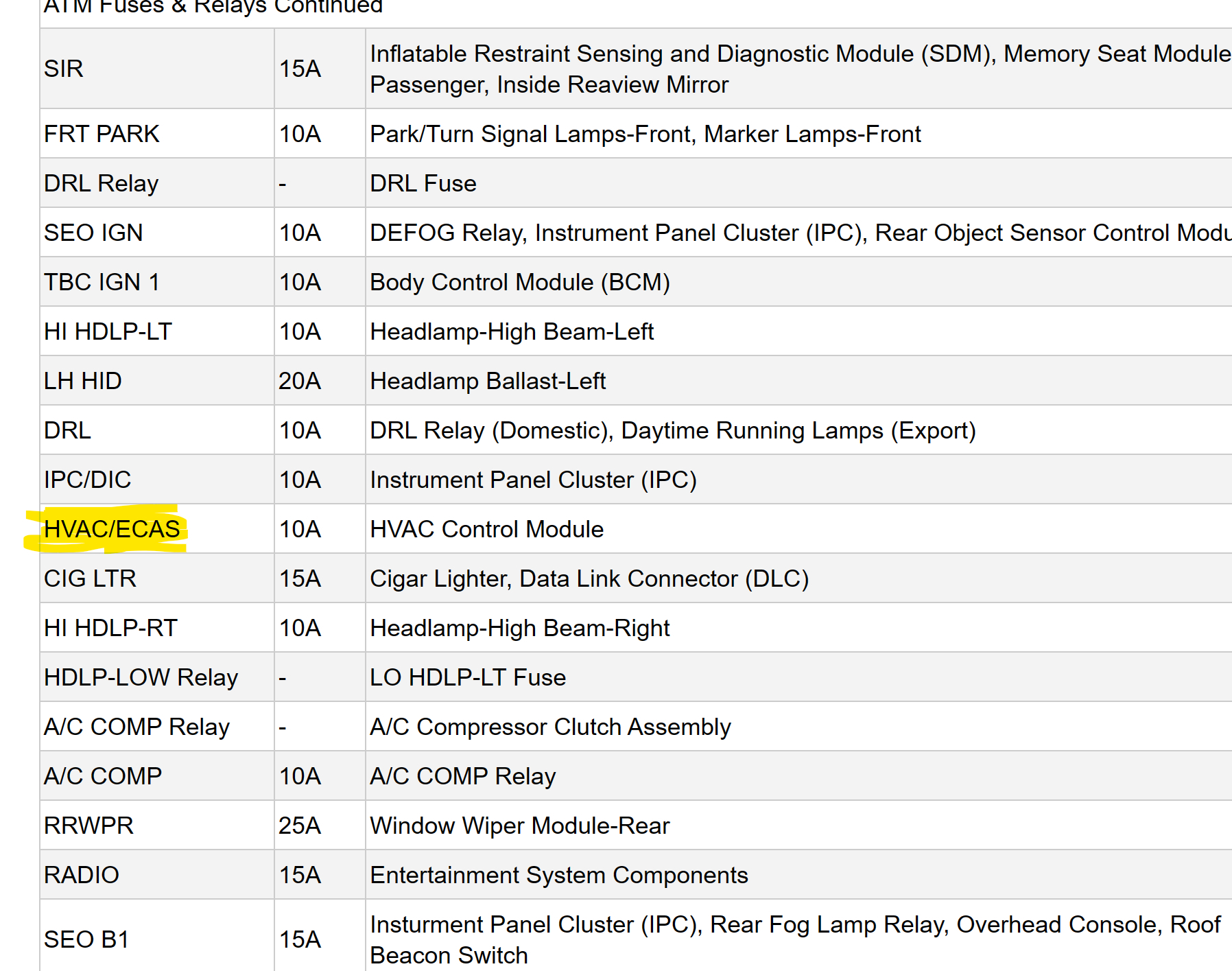

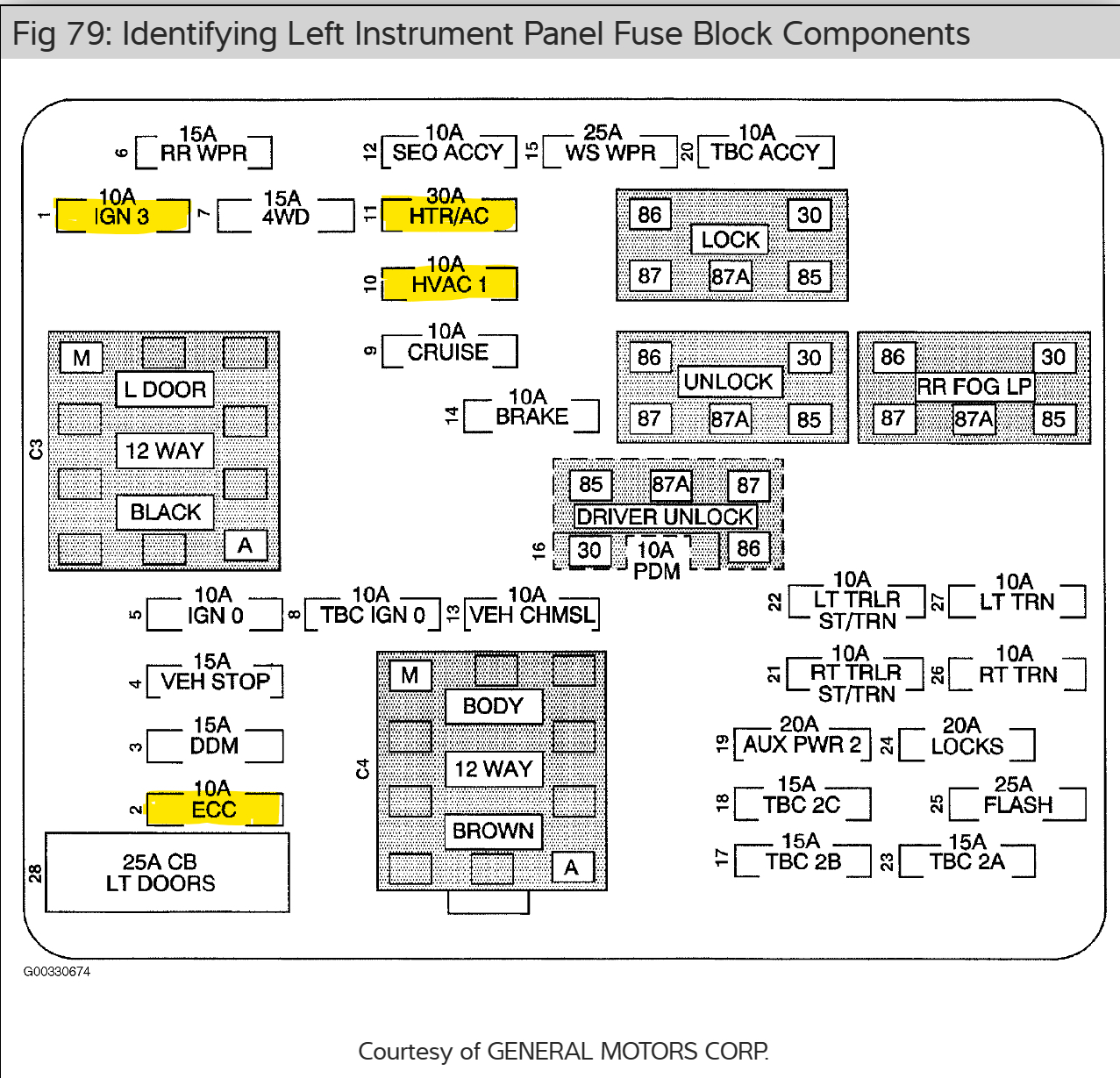

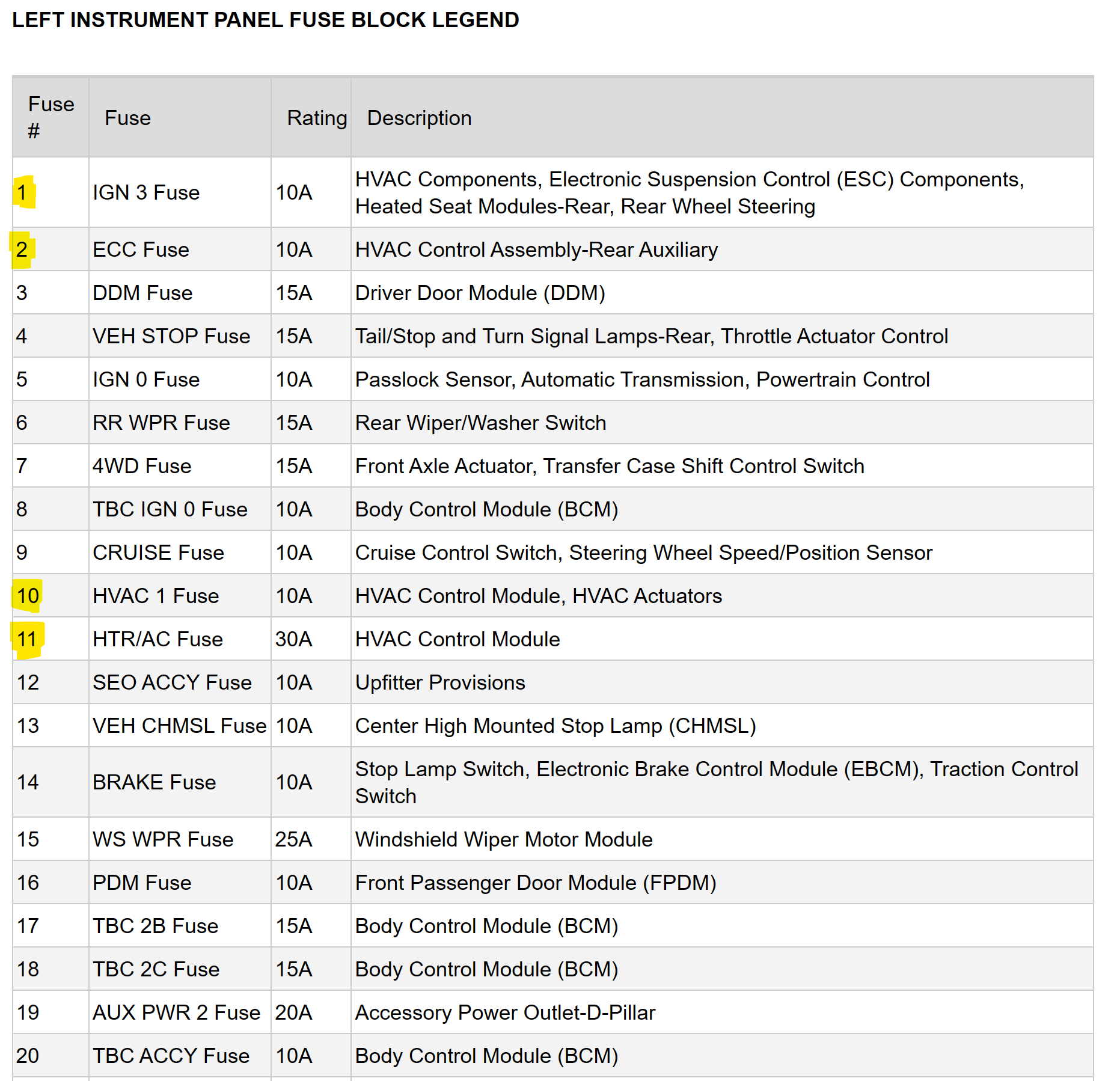

There are a few fuses we should test. I have included diagrams for the fuse box by the Instrument Cluster and Under-hood Fuse Block.
I have high-lighted the fuses you should test using this test:
This uses a test light and is the best and quickest way to check fuses. If you don't have one, you can get one at your local auto parts store. Sounds like you might though.
I have also included legends for the fuse boxes and highlighted the fuses you will be testing. There are 3. The 2 that are not labeled are for the under-hood fuse box.

GRAHAM78
  • 10 POSTS
ECC was the only one I hadn't known to check, and it was bad. Replaced and double checked all the rest for power, all are good and have power now.
