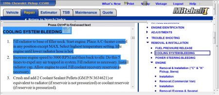

Generic bleeding
https://images.2carpros.com/forum/automotive_pictures/12900_bleeding_cooling_system_3.jpg
