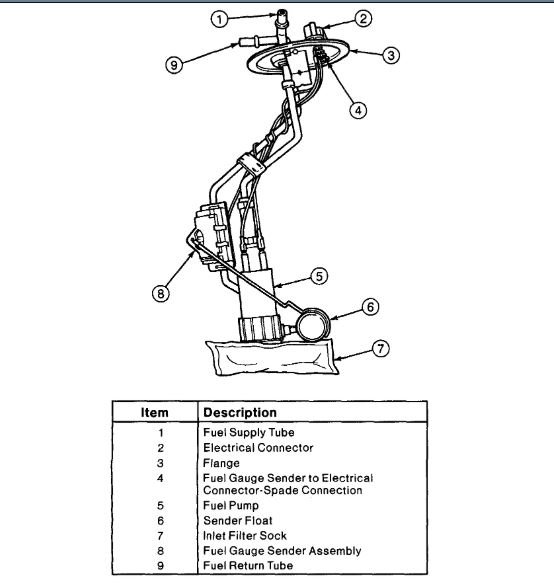

The engine has never failed to start. After attempting to activate fuel pump to drain tank for evap system repair, suddenly with no warning, it refused to start. Checked secondary system with spark tester, there was no spark.

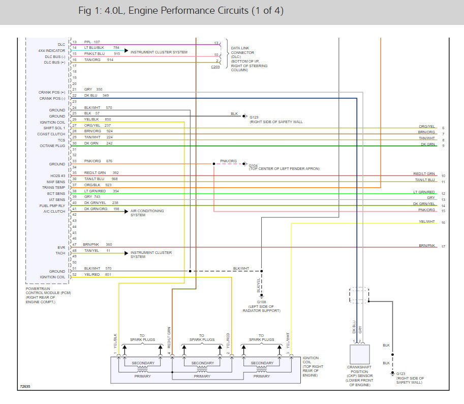

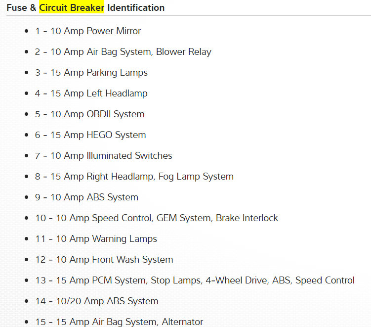

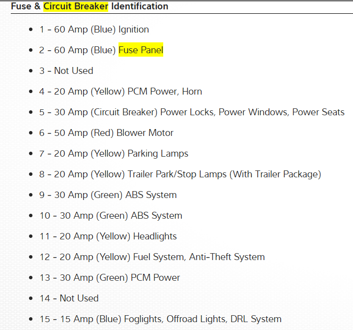

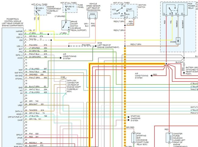

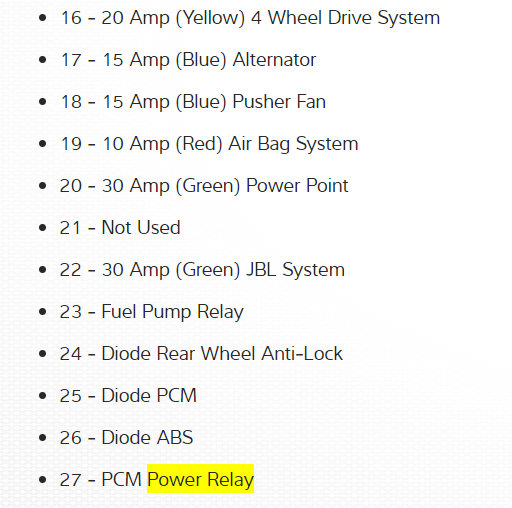

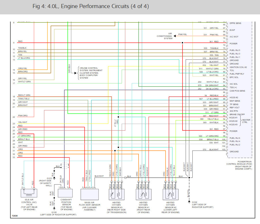

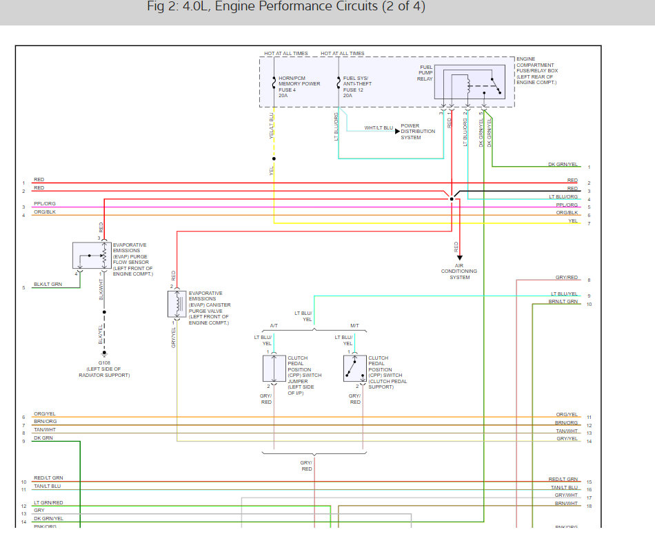

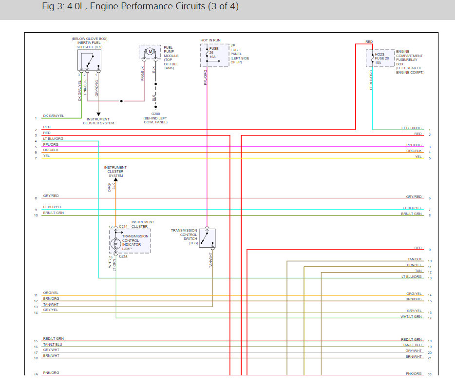

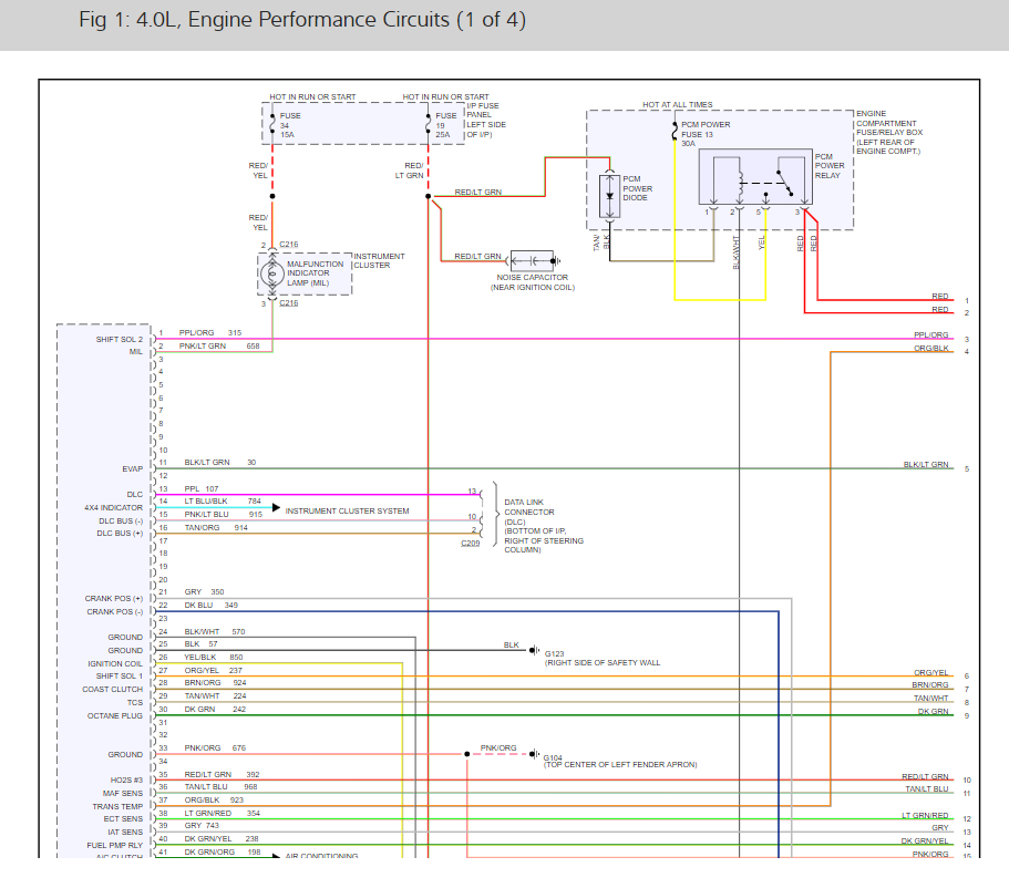

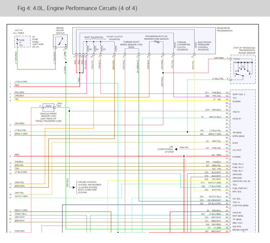

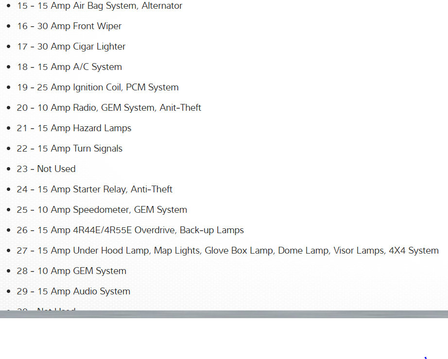

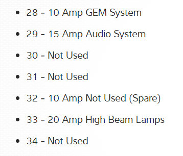

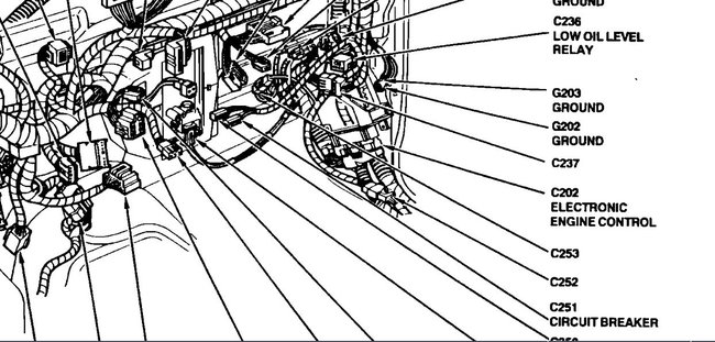

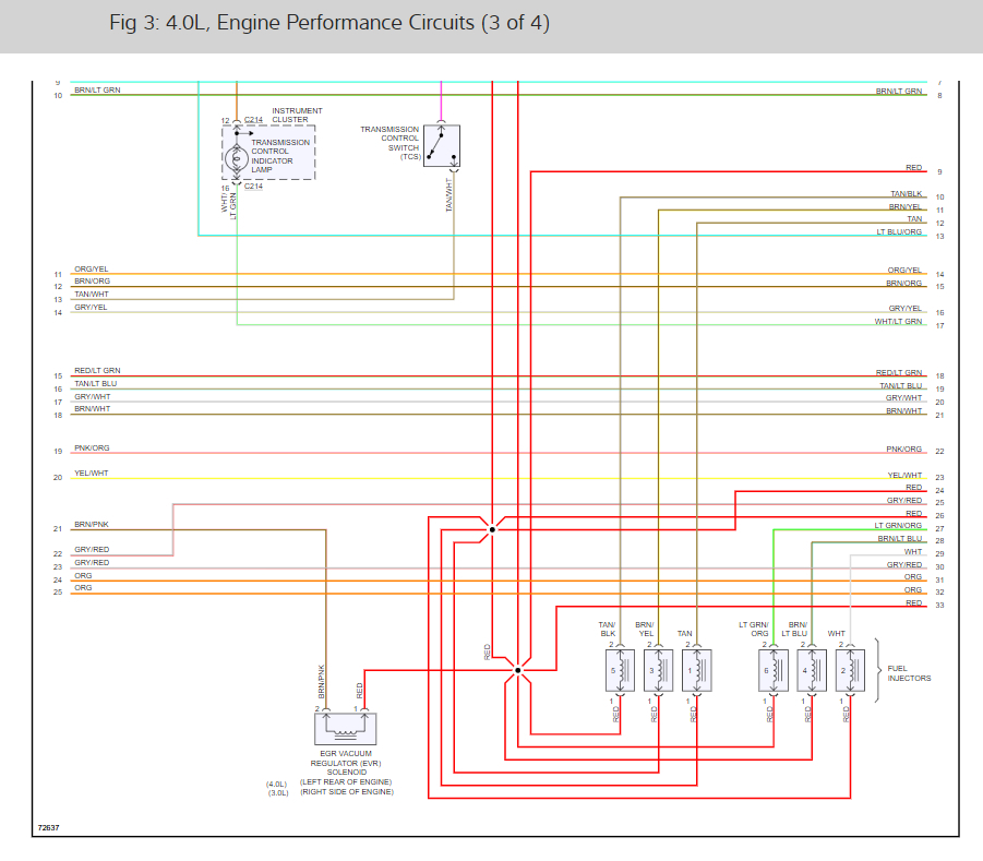

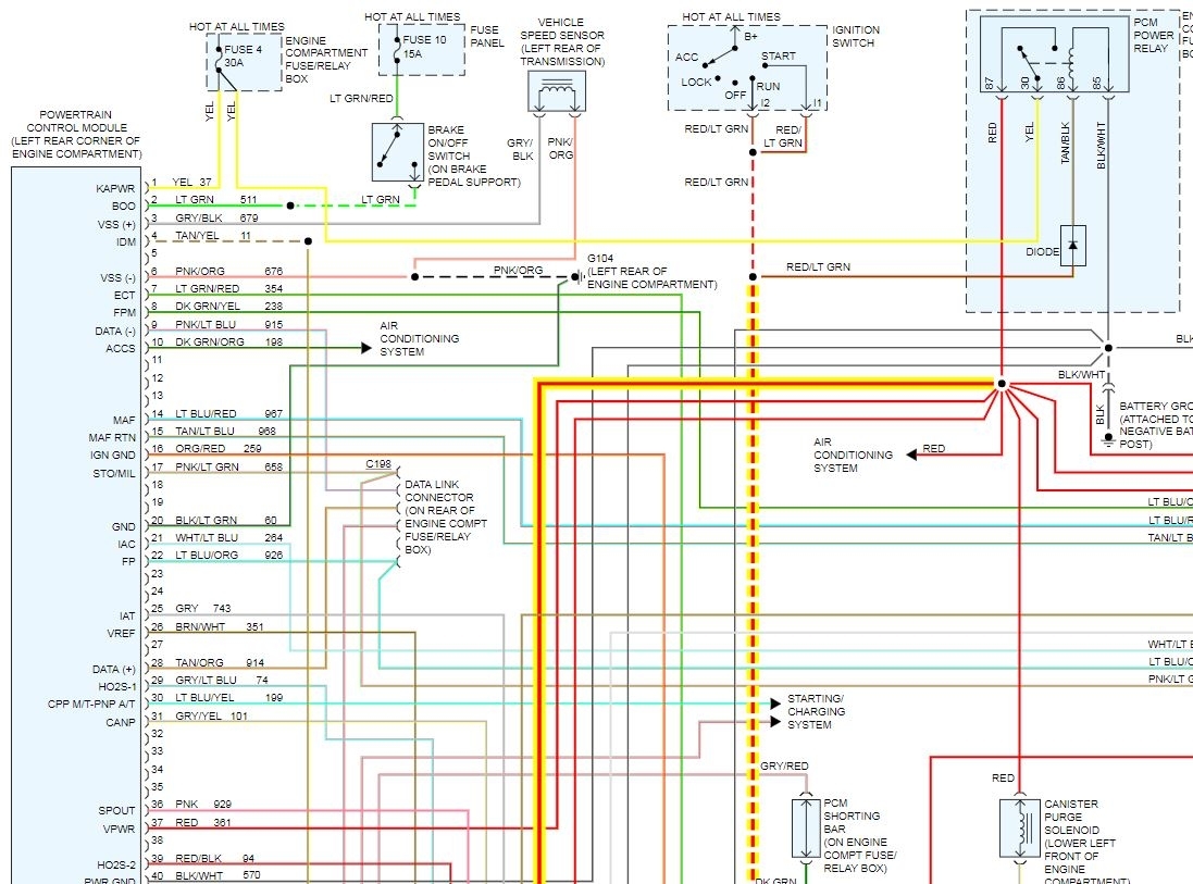

Lets check fuses #34 and 19 with the PCM power relay. Here are guides to help you with the engine wiring diagrams below so you can see how the system works as well as the fuse and relay locations:
and
This can help as well:
Check out the diagrams (below). Please run some tests and get back to us. Check out the diagrams (below). Please let us know what you find. We are interested to see what it is.

Wow! I'm impressed with the response--thank you.The information was excellent, but it applies to an OBD2 system. This, of course, is a 1994 truck; OBD1 --quite a bit different. Might you be able to send the same set for the 1994? Even the fuse box layouts are very different. It would be most appreciated since I don't even have an owner's manual. As soon as I can complete the Evap system repairs, I'll be ready to work on the no start problem.
Again---thank you so much for your willingness to help.

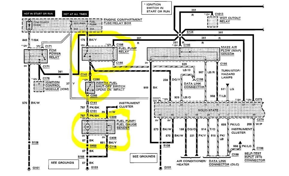

Just thought I'd jump in here. I know you said you currently have no spark, however I'm curious about the other evap system repairs you mentioned. In your initial post, you indicated the engine started and ran fine prior to activating the fuel pump to drain the system for an evap repair. Can you elaborate?
Oct 14, 2019 at 3:54 PM
BYSTANDER
  • 5 POSTS
Masterwrench:
I should have said that a little differently: This situation began when I discovered there was a failure to hold pressure somewhere in the EVAP system---( It turned out to be a failed filler neck hose thanks to California continually reformulating the gas, disregarding rubber compatibility of fuel system parts.) Thanks EPA, thanks carburetor!
Draining the fuel tank was done in case it needed to come out for cleaning.
Up to that point, anytime the engine needed to be running for any reason it never failed to start the entire time it has lived here. When the no start happened, relays checked okay, but spark was a no show. That triggered my mayday.
There may be a clue, the jumper technique used to pump out the fuel didn't work as advertised with key on, fuel pump relay jumpered it would pump for 2-4 seconds then stop instead of continuing to run. Didn't seem right, so turned to good ole' siphon hose which did the job, but still no spark. So, that job's done. Everything seems okay. So, did I miss something? Did I burn something out? I have a feeling it'll be something really embarrassing! Hope not.
Oct 20, 2019 at 5:49 PM
MASTERWRENCH
  • CERTIFIED EXPERT
  • 258 POSTS
Bystander,
Okay, that makes sense. From the sounds of it, since your jumper didn't give you the desired results (running the fuel pump), my guess is whatever you jumped somehow caused the current condition. I would start by checking the power supply to the ignition control module and the coil (see attached diagrams). On the ignition control module, check pin 8 (red wire) with the key in Run or Start. You should see battery voltage here. Also, check the red/light green wire at the ignition coil. This circuit should also have battery voltage with the key in Run or Start.

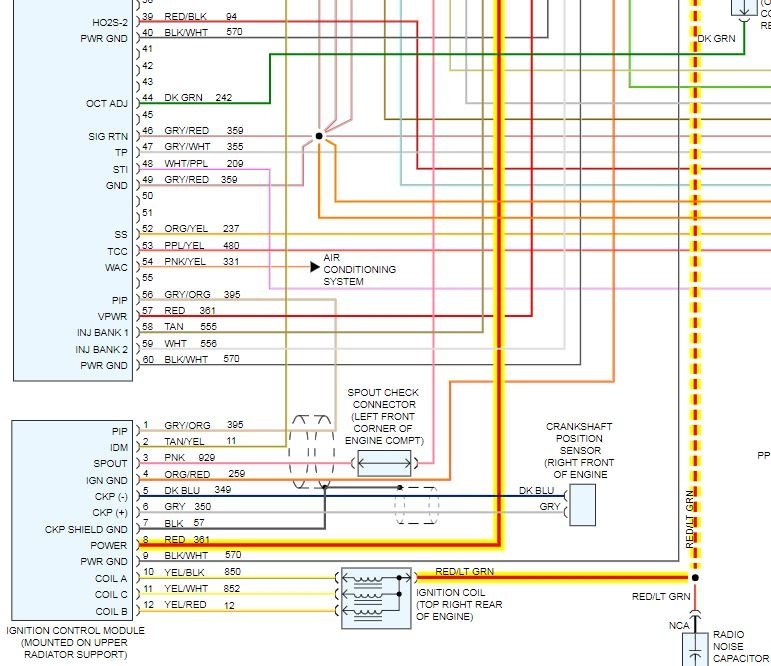

This sounds to me like you have an ignition issue going on. I have included a link that will help you figure out what is going on below:
I have also included a rundown on how your ignition system specifically works in your truck in the diagrams below. Check it out and let us know what you find.

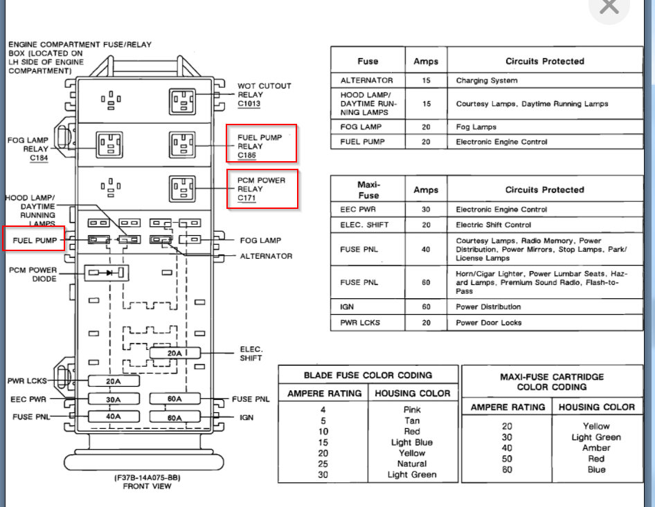

Every now and then I can go to start it and it won’t start, just cranks and cranks, won’t start until I pop the hood and shake the fuse box and it starts. could someone please help?
Mar 2, 2021 at 6:59 PM (Merged)
  • CERTIFIED EXPERT

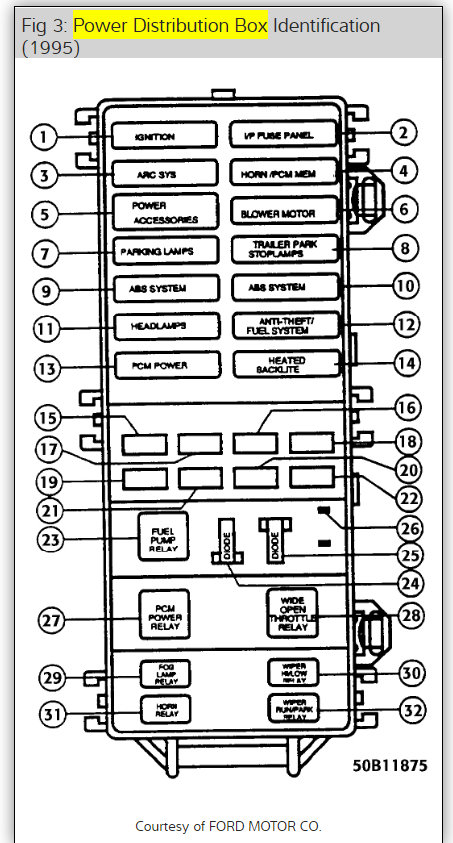

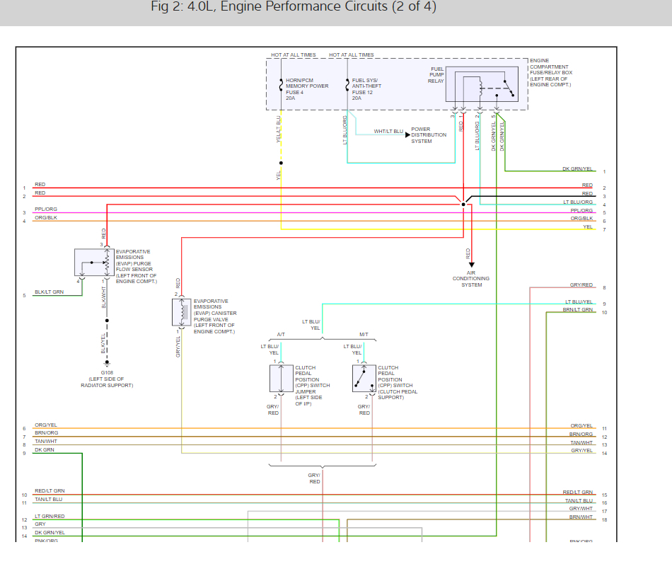

More then likely this is a relay issue. I would think the fuel pump relay is the issue so next time this happens, let's not shake the fuse box, let's open the hood and wiggle each relay one at a time and then try and start the engine. We want to try and narrow this down to one relay so that we can address either the relay or the wiring issue for that relay.
Below is the fuse box for your review. Let us know what happens. Thanks

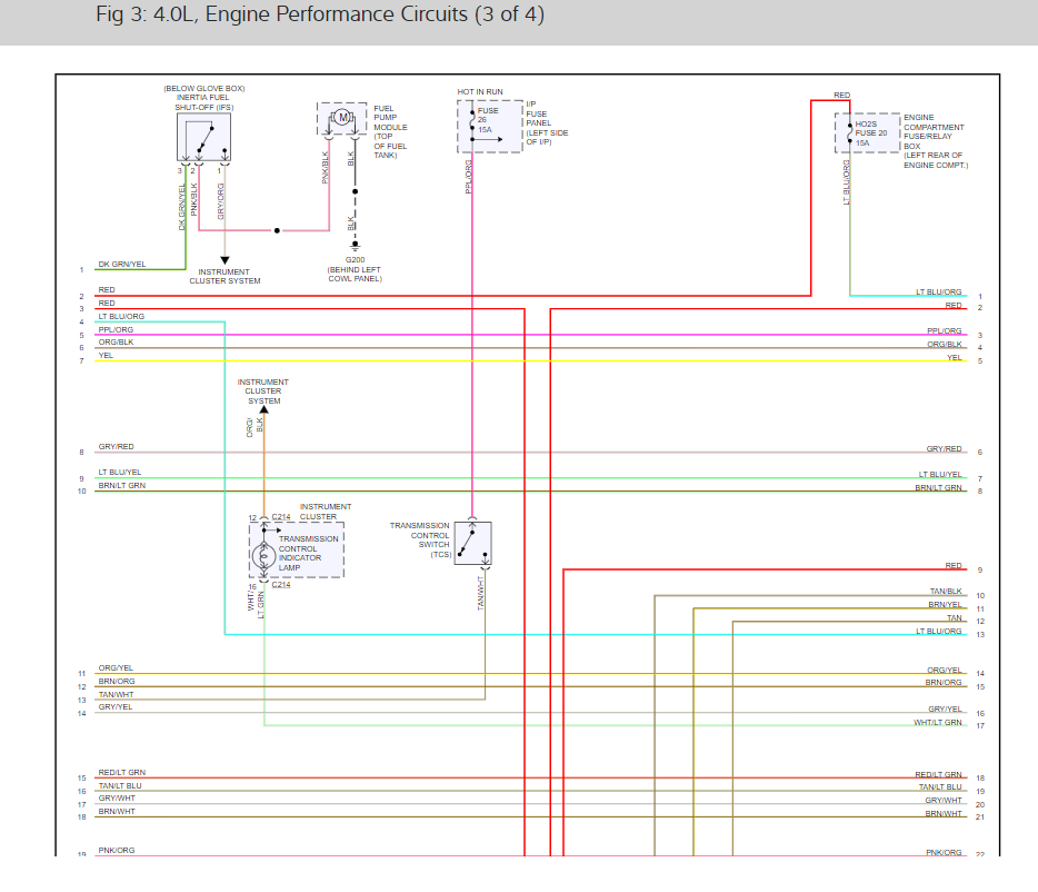

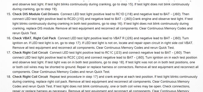

When you turn the key to the on position without cranking the engine over can you hear the fuel pump run in the tank for 5 seconds?

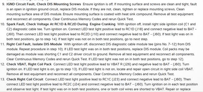

Please run down this guide and report back. scan for codes first see pics for diagnosing

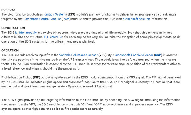

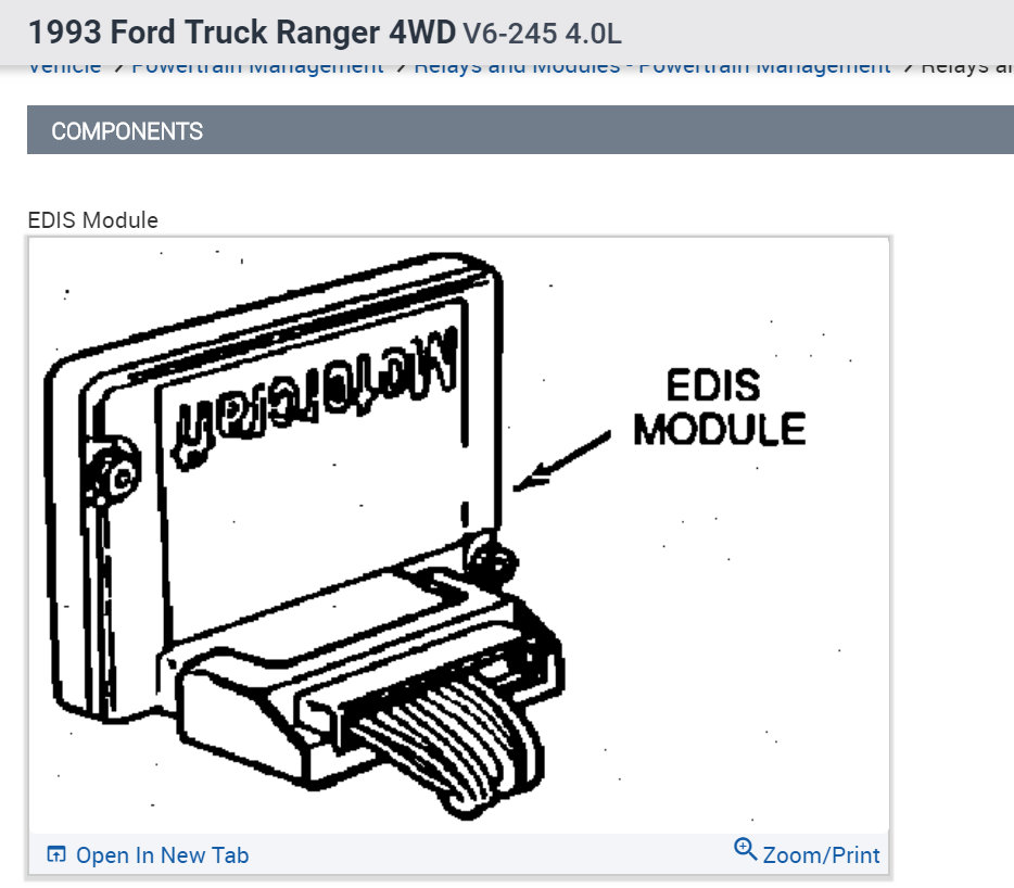

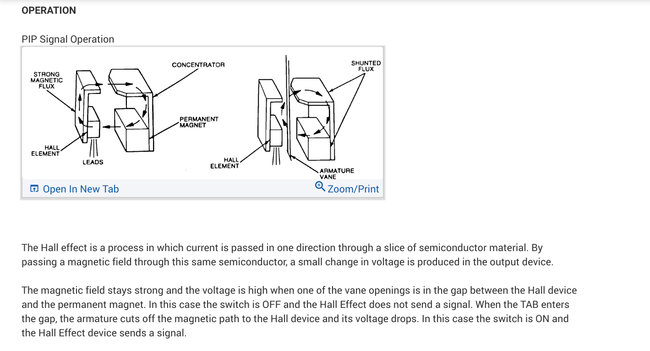

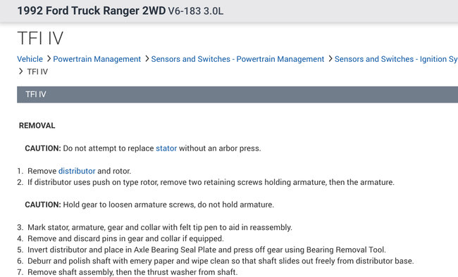

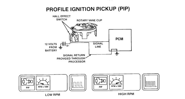

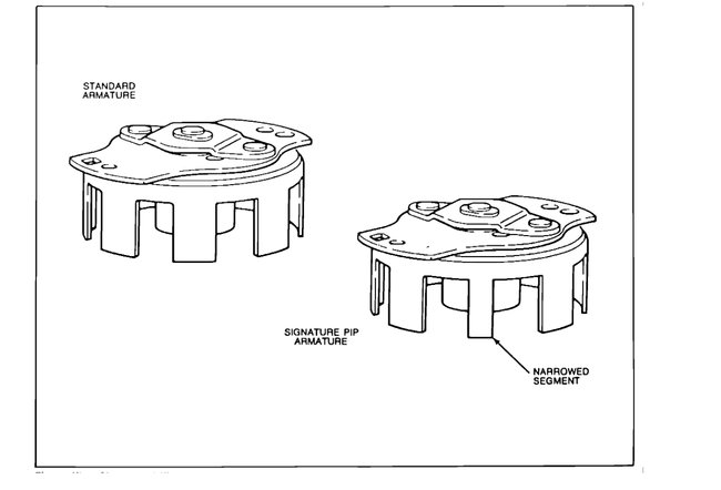

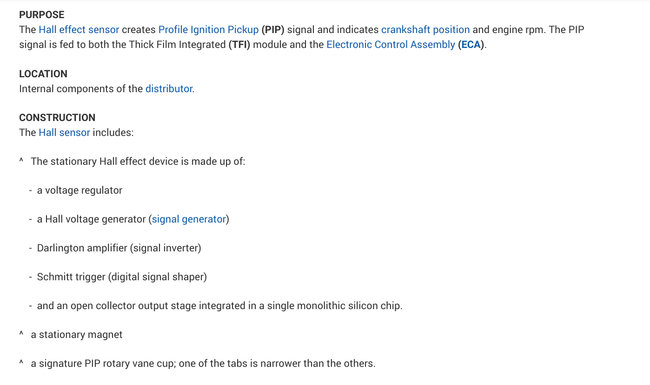

This could be from a couple of different things, your vehicle's Profile Ignition Pickup[PIP] or the Idle Air Control valve [IAC]. First let's start with the PIP which the Power-train Control Module [PCM] uses for ignition timing through the SPOUT. In the diagrams down below I have included the description and instructions on how to replace the PIP in your vehicle. Please go through these guides and get back to us with how everything turns out. We can go from there if necessary.
