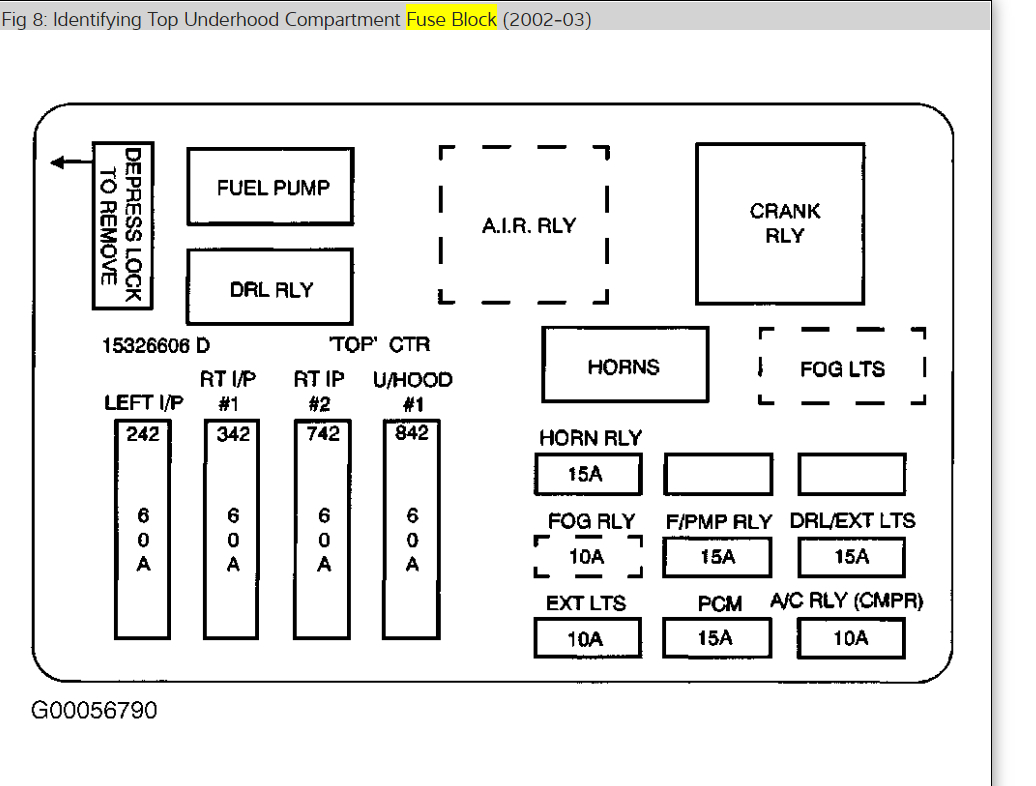

I blew my head gasket about 6 months ago. I finally got a new engine put in. Car ran good but i noticed that when I turned the car off the radio would still be on as well as the lights on the dash. I thought the lock cylinder or switch was the problem so i had both of them changed as well and the problem persists. I don’t have an aftermarket radio. Please help, it's constantly draining my battery.
Mar 23, 2023 at 9:34 AM
  • 54,837 POSTS

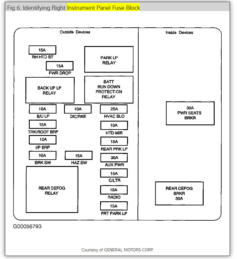

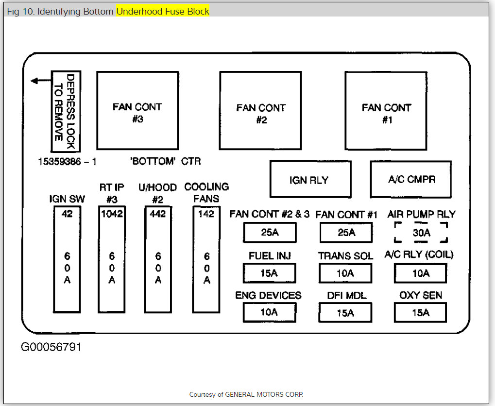

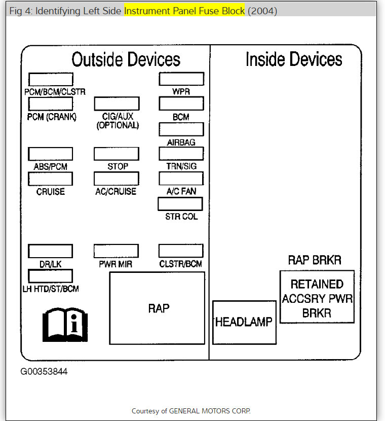

Did the electrical problem happen at the same time as the engine installation? If so, I would recheck the system grounds. Also, we should check all fuses with the key on because if there is a fuse out the BCM may not turn the systems off, this guide can help with the fuse location in the images below:

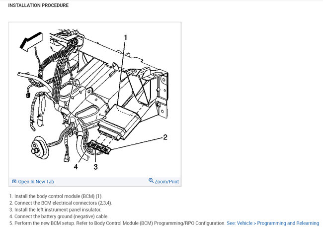

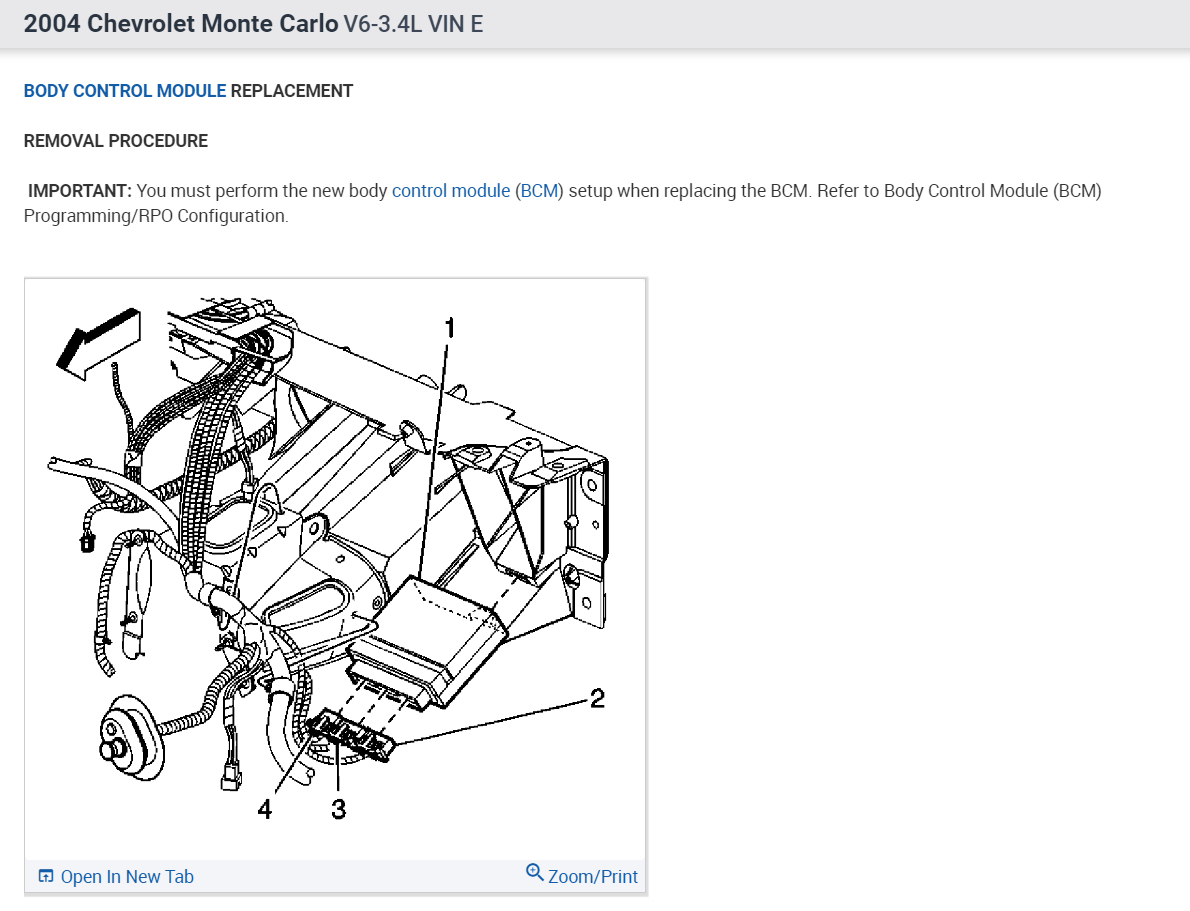

If the fuses are okay, we should do a CAN scan because it sounds like the BCM is out. You can get a CAN scanner (Controller Area Network) from Amazon.
https://youtu.be/u-4syLc-ifQ
and
I included the BCM replacement instructions as well, you can get a preprogrammed BCM by searching Google or Ebay. Check out the images (below). Please let us know what happens.
