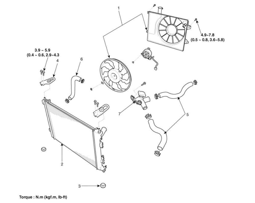

Need change radiator due to small leak from parking curb over time. Can't find video how to ? I'm handy and looking to know if pretty easy ?
Jan 20, 2016 at 2:19 AM
Okay, I attached the procedure below for you for the replacement.
https://www.2carpros.com/articles/how-to-replace-a-car-radiator
https://www.2carpros.com/articles/coolant-flush-and-refill-all-cars
Removal and Installation
1. Disconnect the battery terminals.
2. Remove the air cleaner assembly.
3. Remove the battery and battery tray.
4. Disconnect the fan motor connector (A)
5. Loosen the filler neck assembly mounting bolts (A).
6. Remove the cooling fan assembly (A).
Tightening torque:
4.9 - 7.8 N.m (0.5 - 0.8 kgf.m, 3.6 - 5.8 lb-ft)
7. Remove the under cover.
8. Loosen the drain plug, and drain the engine coolant. Remove the radiator cap to help drain the coolant faster.
9. Disconnect the over flow hose (A) from the filler neck.
10. Disconnect the radiator upper hose (A).
11. Disconnect the radiator lower hose (A).
NOTE:
When installing radiator hoses, install as shown in illustrations.
12. Disconnect the ATF cooler hoses (A/T only).
13. Remove the head lamp.
14. Remove the front bumper.
15. Remove the radiator upper bracket (A).
16. Separate the condenser from the radiator and then remove the radiator assembly (A).
17. Installation is the reverse order of removal.
18. Fill the radiator with coolant and check for leaks.
NOTE:
- Bleed air from the cooling system.
- Start engine and let it run until it warms up (until the radiator fan operates 3 or 4 times).
- Turn off engine. Check the coolant level and add coolant if needed. This will allow trapped air to be removed from the cooling system.
- Put the radiator cap on tightly, then run engine again and check for leaks.

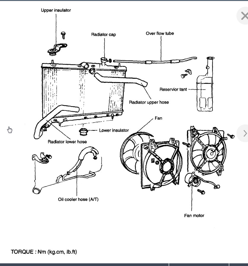

SHARON ROSE
I'm a newbie and made a newbie mistake replacing the radiator on my car listed above. I didn't take close enough notice when I took off the transmission cooler hoses and now can't tell which is which to attach to the right fittings on the new radiator. Can a pro please tell me from where they attach to the transmission down to the cooler which is which? Like, does the right from the trans attach to the right on the cooler or do they cross over? Really don't want to mess up my transmission by attaching outflow to inflow and vice versa.
Feb 12, 2021 at 1:52 AM (Merged)
I attached the illustration and instructions but they are not extremely detailed. The lines should "fall" into the location that they belong. Basically they should not fit in either location because they are molded/hard lines correct?
Get a couple pictures of what you are dealing with and we can figure it out.
Worse case, get everything hooked up except for these two lines. Run both of them into separate buckets and start the engine for a couple seconds. This will cause the transmission oil from the supply line to shot into the bucket. Clearly nothing will come out of the return line from the cooler.
Let me know and we can go from there. Thanks

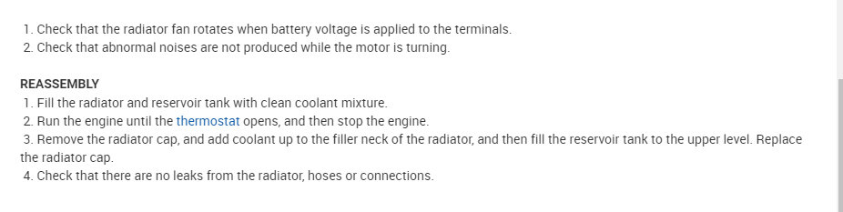

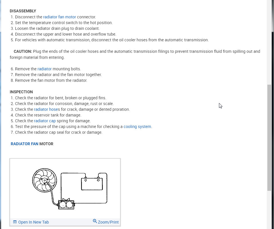

LUCKYME0428
Engine Cooling problem
2001 Hyundai Elantra Automatic
My radiator blew out and I decided to change it myself with the help of my brother. We chaged it and thought everything was fine but then the car started overheating very quickly, blowing cold air out of the heater settings, and revving up the engine in two seconds cycles (that is it revs it up it comes down it revs it up down up down u get the picture). I came back to your site did some research and thought that maybe there was air in the line, we followed your instructions to get the air out but the car is still doing the same things. Please Help.
Feb 12, 2021 at 1:53 AM (Merged)
KHLOW2008
  • 41,814 POSTS
Hi luckyme0428,
Thank you for the donation.
When engine is cold, did you check the radiator coolant level at the cap?
If level is full and overheating occurs, did the fans start working?
Did you test if the radiator fans are working?
When the radiator blew up, the engine could have overheated and damagd the thermostat.
Do initial check first before going to thermostat test which would require removal of it.
Let me know what you find out.
LUCKYME0428
i did check the radiator coolant levels at the cap.
the fans did start working.
and since my first post i changed the thermostat.
but the car is still overheating.
KHLOW2008
  • 41,814 POSTS
When fans are workings, do they stop intermittently when temp gauge shows high?
Is air blown through the radiator very hot?
Do you need to top up coolant after running engine?
Is coolant being forced out to the reserve tank?
LUCKYME0428
no the fans do not stop intermittently.
i dont know about the air being blown hot. (I'm afraid to let the car get hot again).
I do need to top off the coolant after runing the engine.
coolant is being forced out the overflow tank.
KHLOW2008
  • 41,814 POSTS
Situation don't seem optimistic.
Engine is overheating and pressure buildup in cooling system.
If the radiator cap had not been replaced, then it could be bad. Check the seals for wear or tears.
If the radiator cap is not the problem, you have blown the head gasket caused when the radiator blew.
Check for water contamination in the engine oil and get a test done for hydrocarbon leakage into cooling system. Ther should be a kit available at your local parts store.
