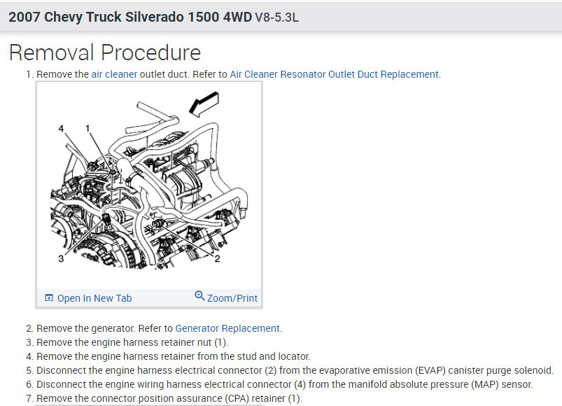

Drove truck home from work (1 1/2 hour drive). Everything normal, no problems, no doors, no alarms, nothing wrong. Next morning, when checking fluids before leaving for work again, found reservoir starting to change state into a " light/slushy type form. Drove other car to work. Came home checked engine oil condition, no change in color, odor, or viscosity, checked transmission fluid same results, checked actual fluid in radiator, no change, no harm was done.
Drained all existing coolant from radiator, after cleaning out overflow with room temperature water, also, flushed all hoses in and out of coolant system. After allowing all to completely empty itself, I refilled with new dexcool coolant, only bumping engine at first to move fluid level so able to top off system. Then at idle only, while watching and listening to engine, allowed to idle with cab heat on until change in cab temperature from cold to just passed warm present. Then shut off engine, had to lay down before leaving for work again. Haven't actually driven this vehicle yet, still investigating what/why/how this occurred.
Respectfully request your input if possible. Thanks.

Do have any leaks in the cooling system? Has the coolant level stayed the same or are you having to add coolant? The reason I ask this is the reason when Dexcool brand coolant can cause problems is when air is introduced to it. Air causes Dexcool to thicken, clog, discolor and wreak havoc on the cooling system.
This guide can help us see if the head gasket is blown
You might want to first check the coolant overflow bottle to see if the cap is providing a tight seal without cracks or damage allowing air to be introduced to it. Hope this helps and thanks for using 2CarPros.

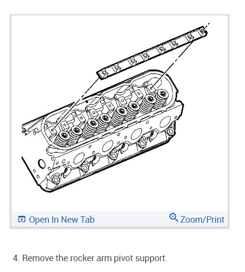

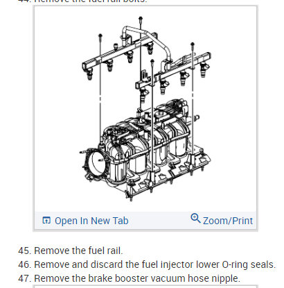

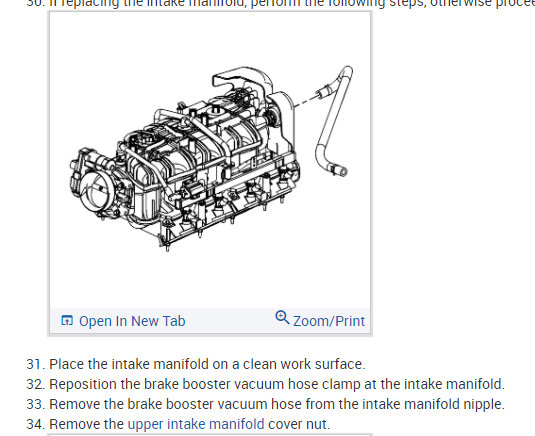

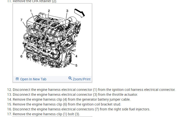

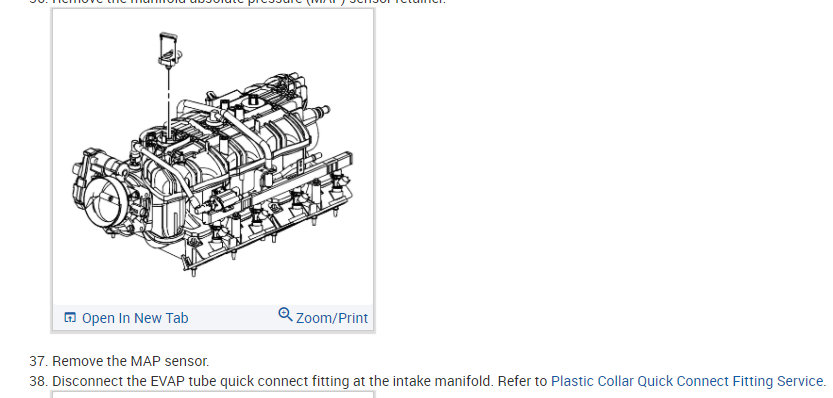

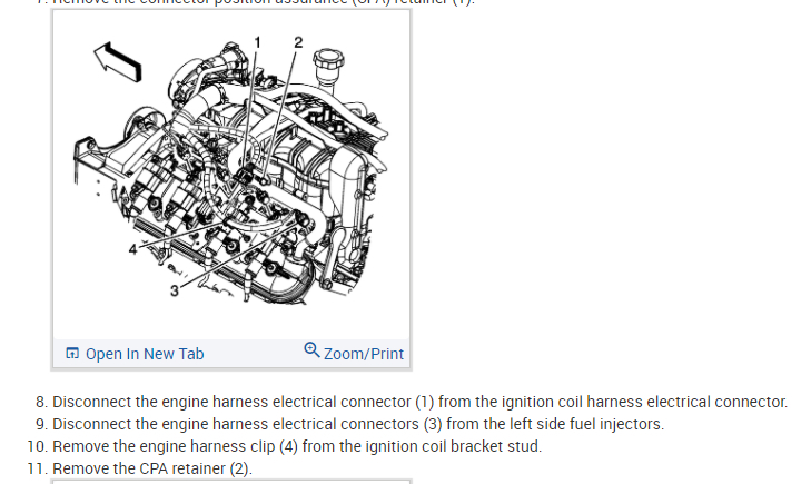

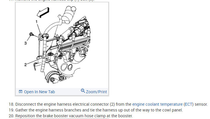

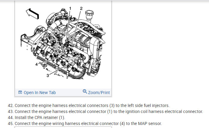

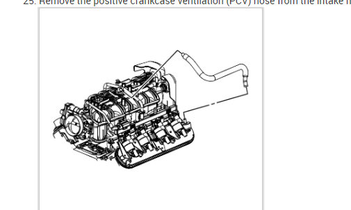

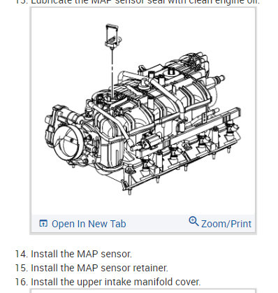

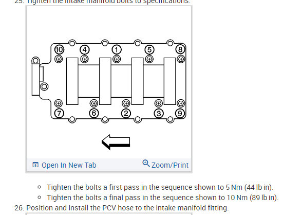

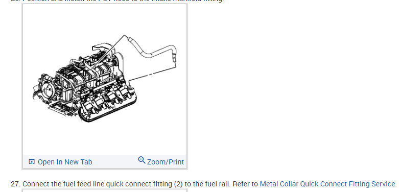

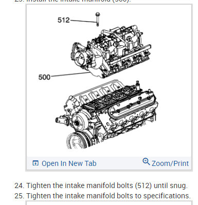

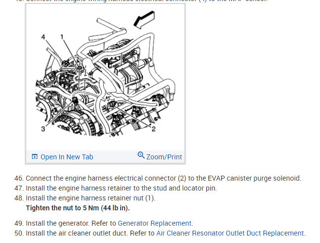

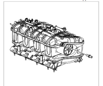

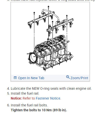

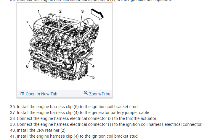

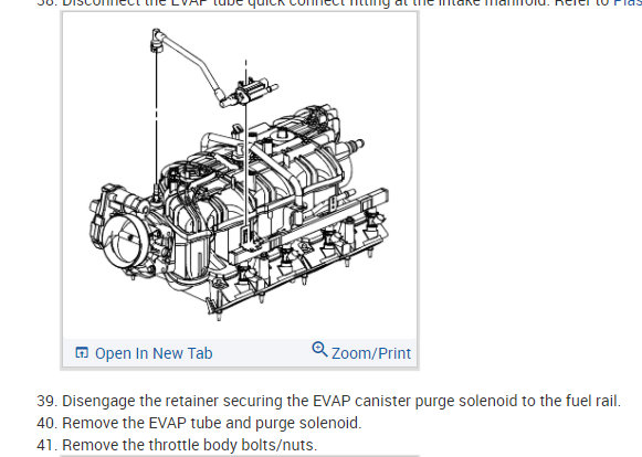

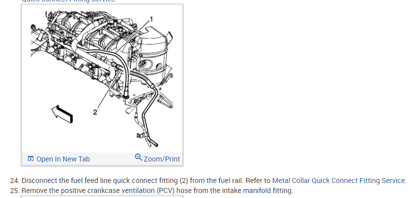

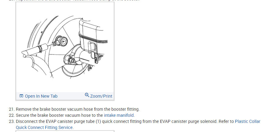

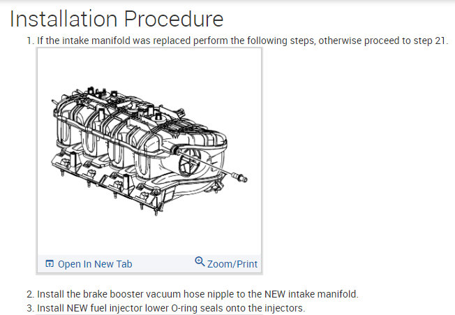

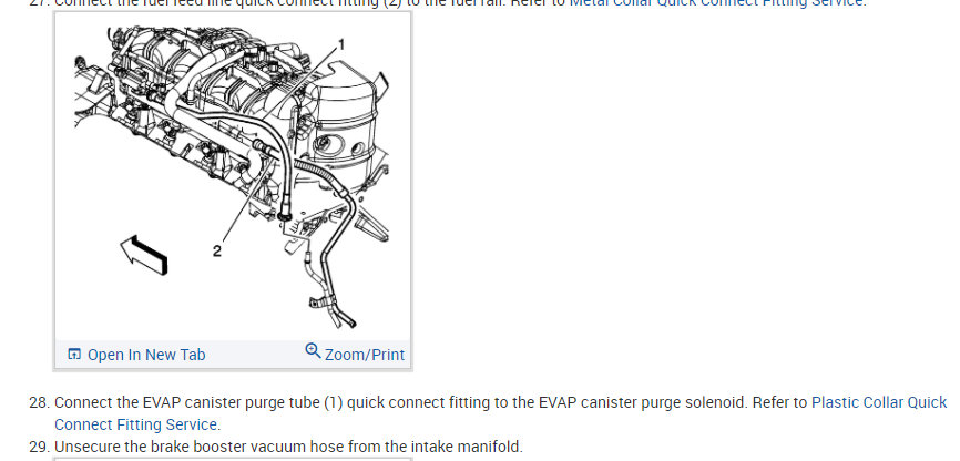

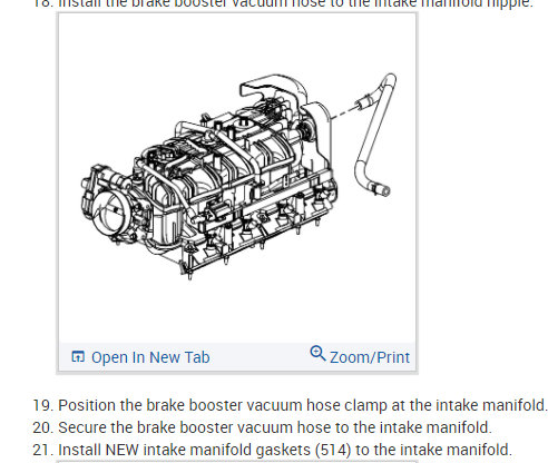

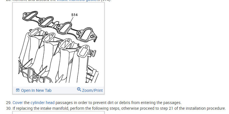

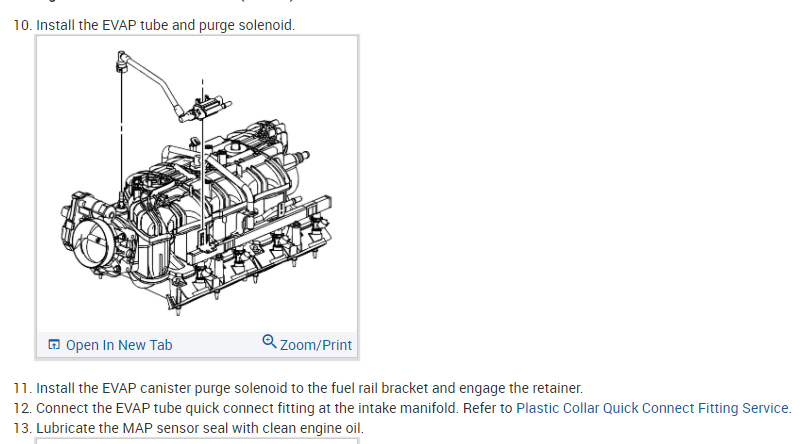

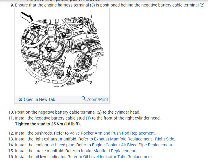

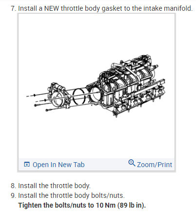

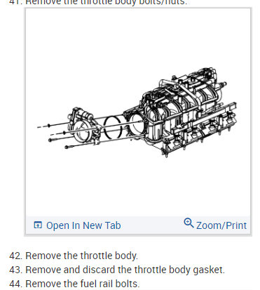

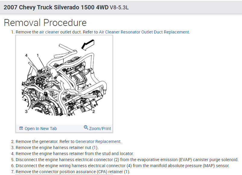

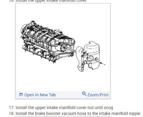

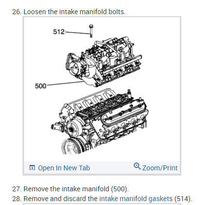

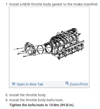

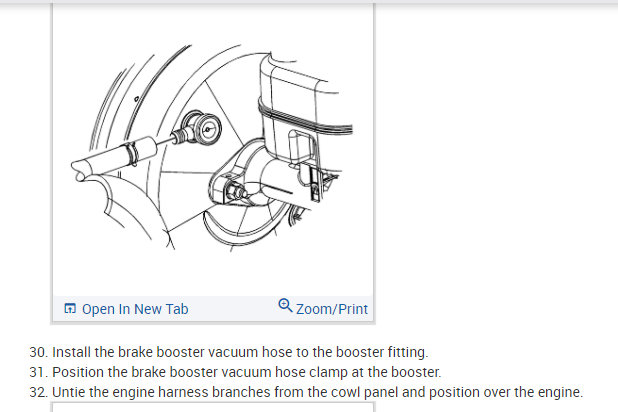

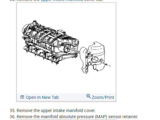

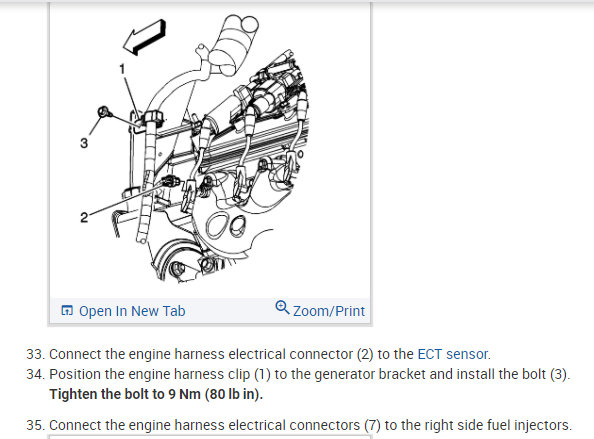

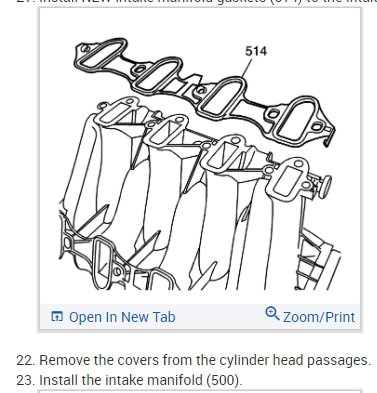

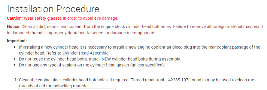

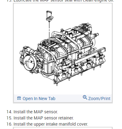

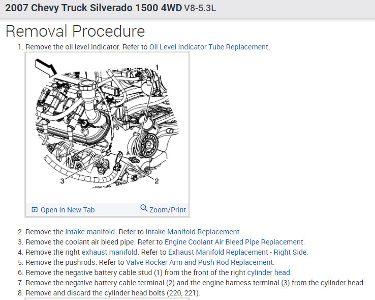

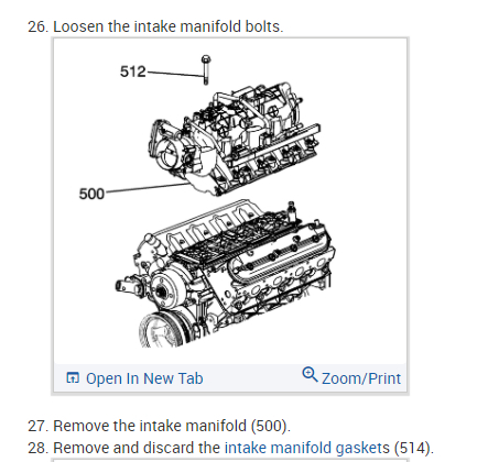

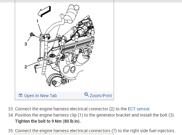

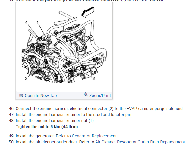

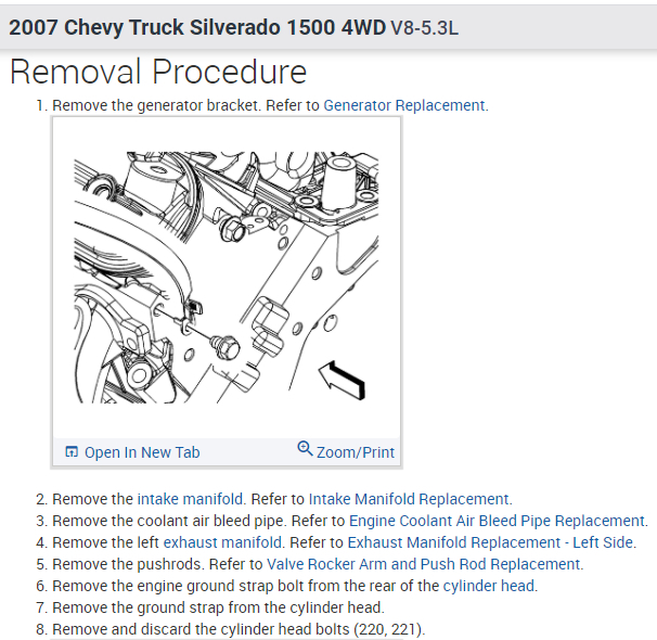

I'm attaching repair instructions for replacing the head gaskets if needed. To get started you will need to remove the intake manifold. Here is a tutorial showing what is involved:
https://www.2carpros.com/articles/replace-intake-manifold-gasket
I've attached picture steps below for removal and replacement of the intake manifold for your truck. Hope this helps and thanks again for using 2CarPros.
Danny-
Jan 29, 2021 at 10:33 AM
DANNY L
  • 5,648 POSTS

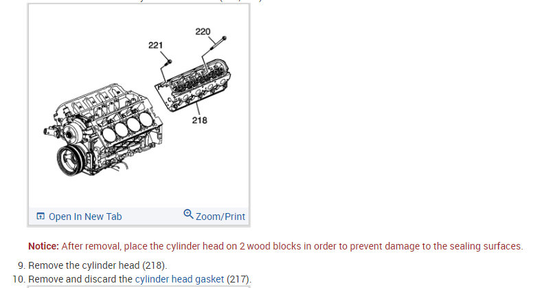

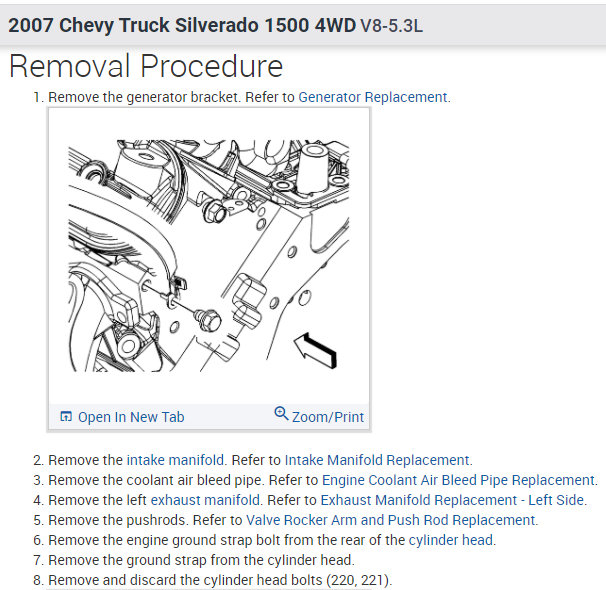

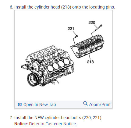

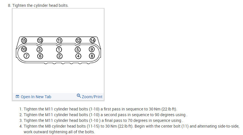

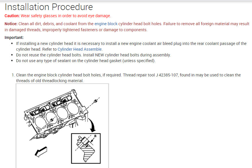

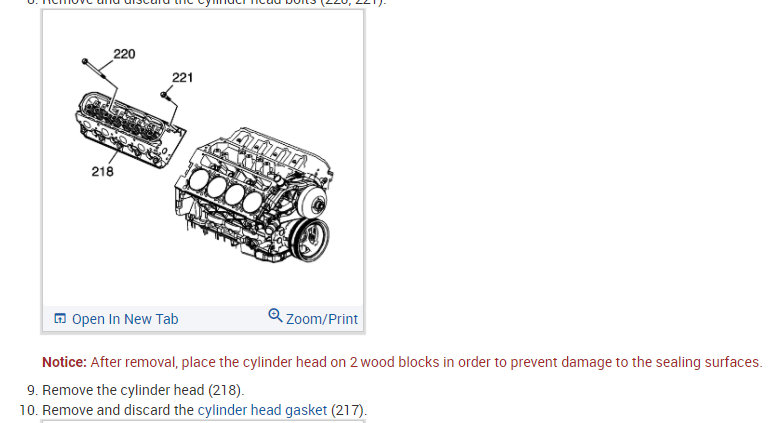

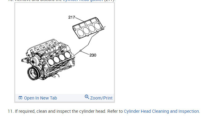

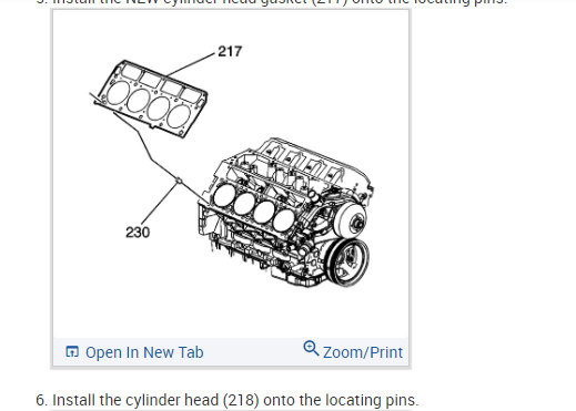

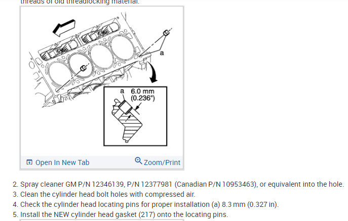

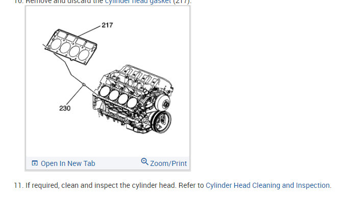

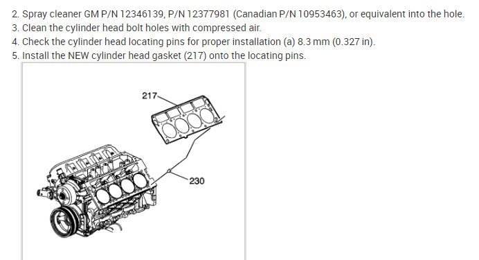

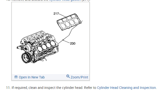

Hello again.

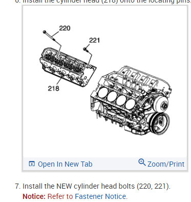

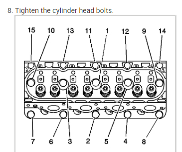

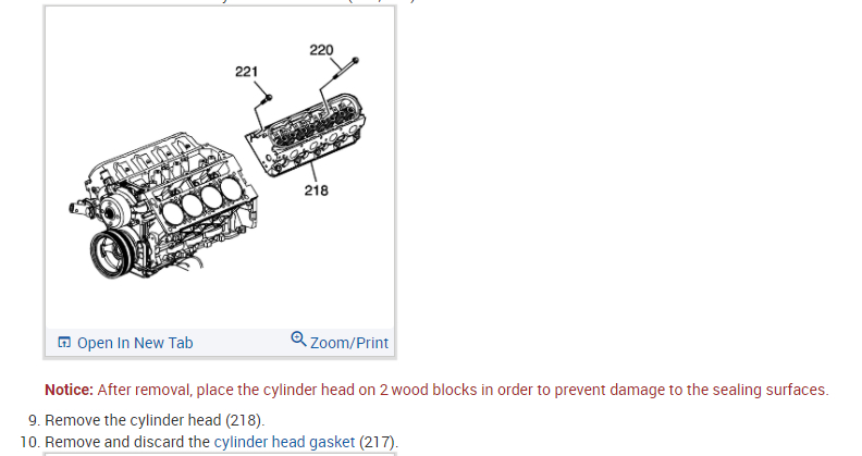

This is a continuation from last post. Here are the picture steps below for the head gasket replacement for your truck. Hope this helps and thanks again for using 2CarPros.
Jan 29, 2021 at 10:38 AM

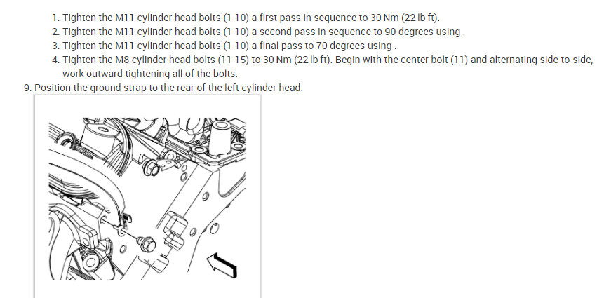

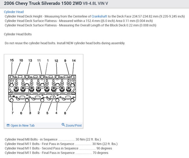

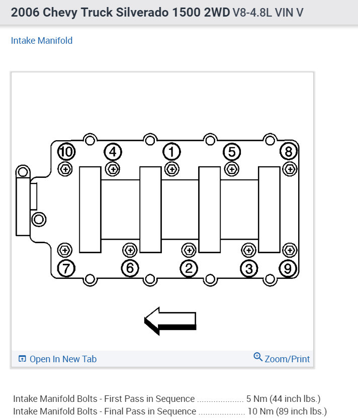

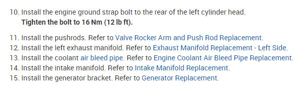

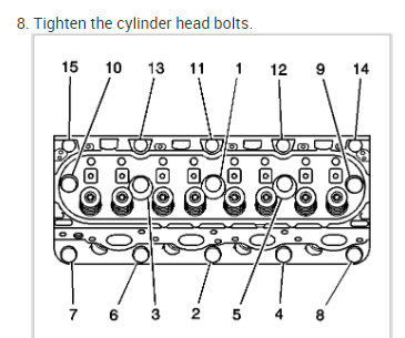

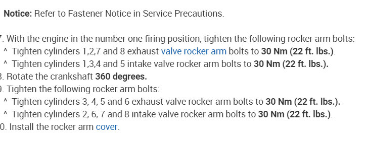

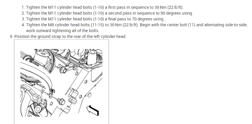

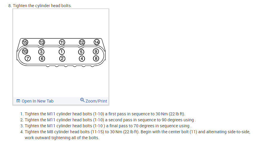

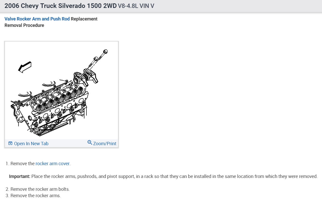

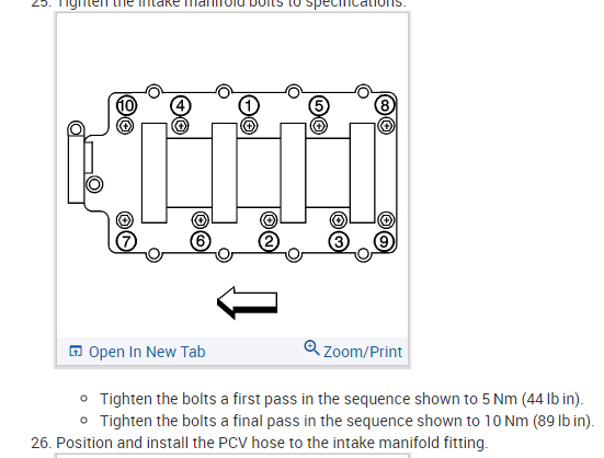

Replacing the head gaskets on my truck. I have found torque specs for the 5.3, but cannot seem to find any for the 4.8. Are they the same and if not what are they? I am needing:
head bolts
intake manifold
rocker install sequence
Feb 3, 2021 at 2:03 AM (Merged)
HMAC300
  • 48,601 POSTS
4.8 is same as a 5.3L. Here are diagrams below to show you the torque specs for the head, intake and rocker arms with a video to show you how to use a torque wrench correctly.
https://youtu.be/juOClONIWeY
Check out the diagrams (Below). Please let us know if you need anything else to get the problem fixed. Cheers
