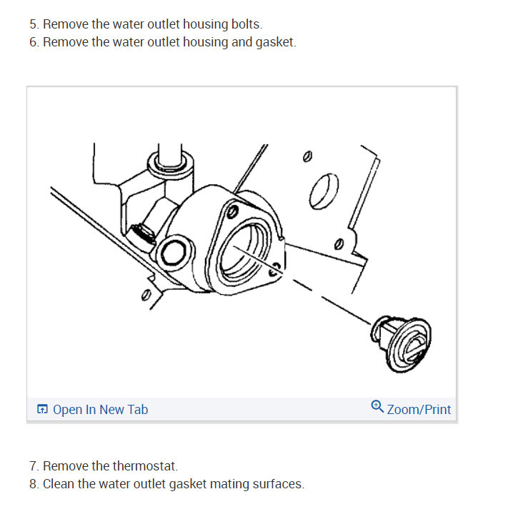

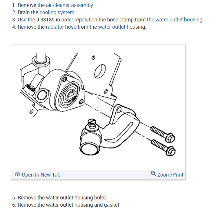

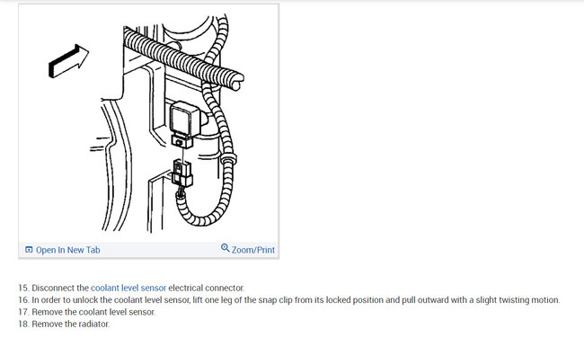

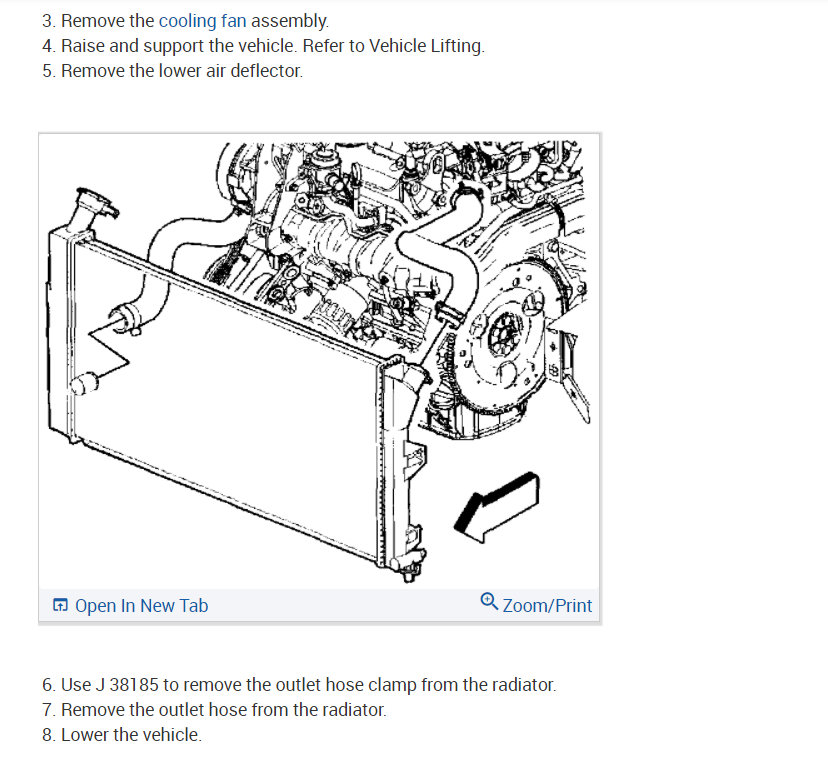

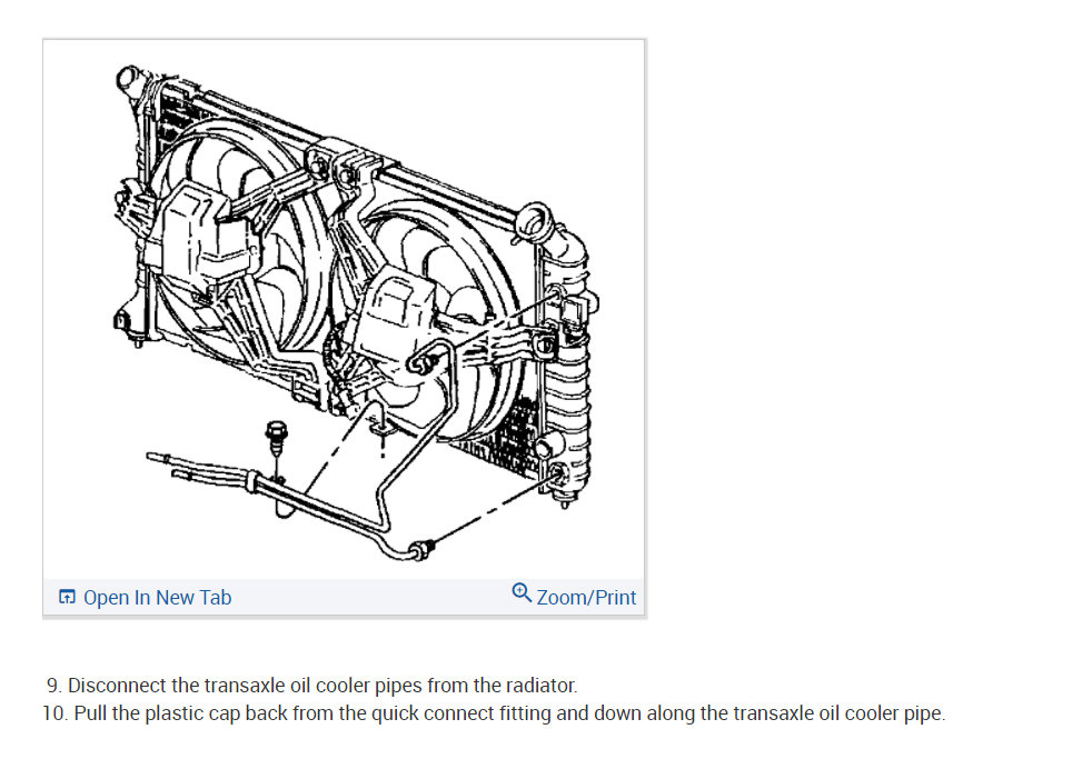

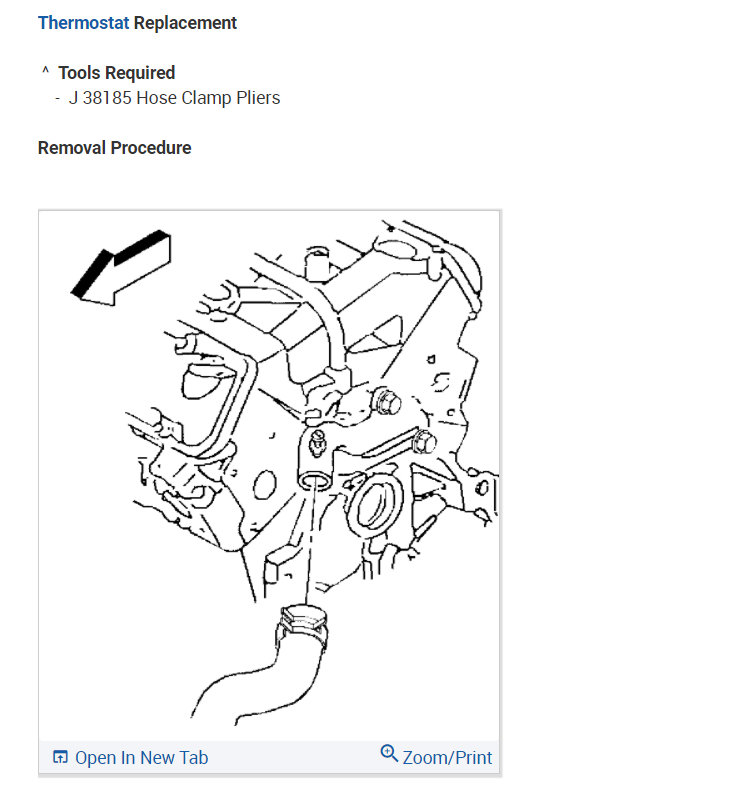

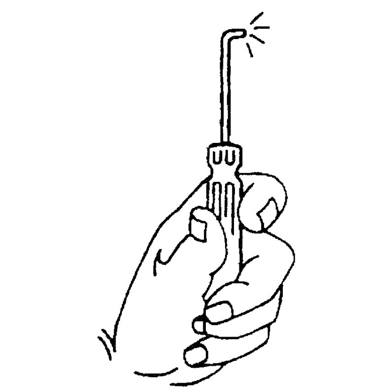

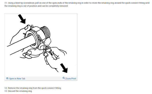

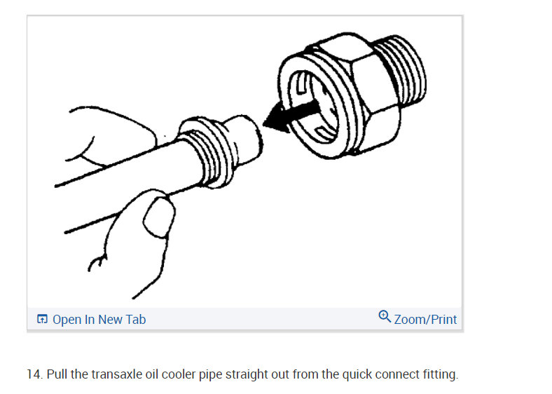

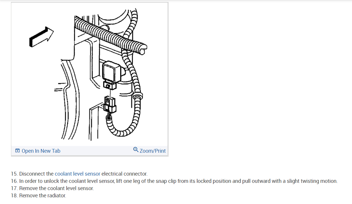

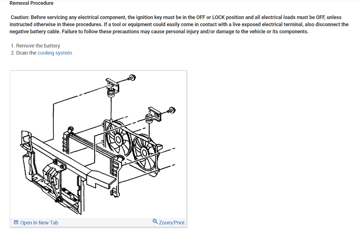

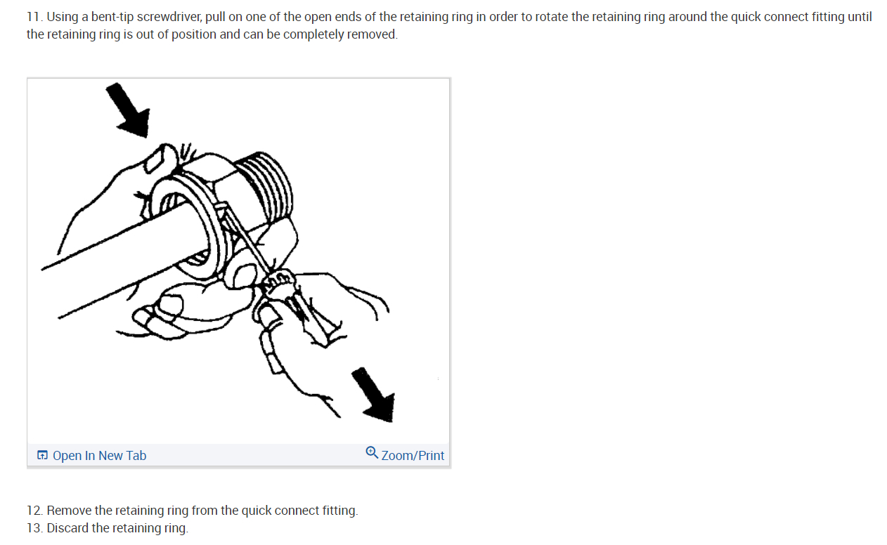

I need to know how to replace a radiator and thermostat.
May 8, 2021 at 5:52 AM
Good afternoon,
I attached the procedure for the radiator and thermostat replacement below for you to view.
https://www.2carpros.com/articles/how-to-replace-a-car-radiator
https://www.2carpros.com/articles/coolant-flush-and-refill-all-cars
May 8, 2021 at 9:39 AM
RAZZOCAMRICH
Thanks ASEMASTER6371. That helped out a lot. I appreciate the help.
