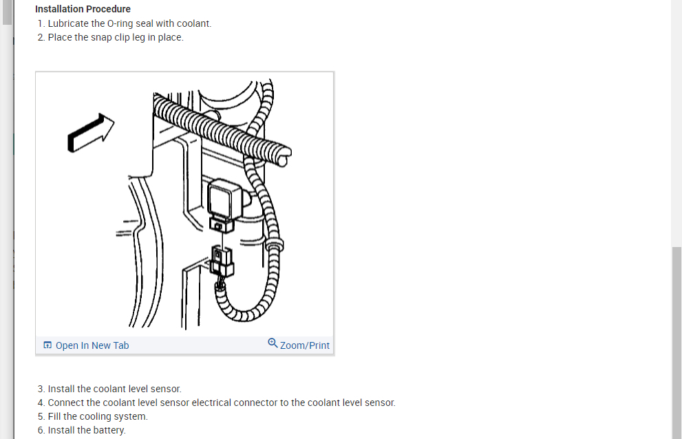

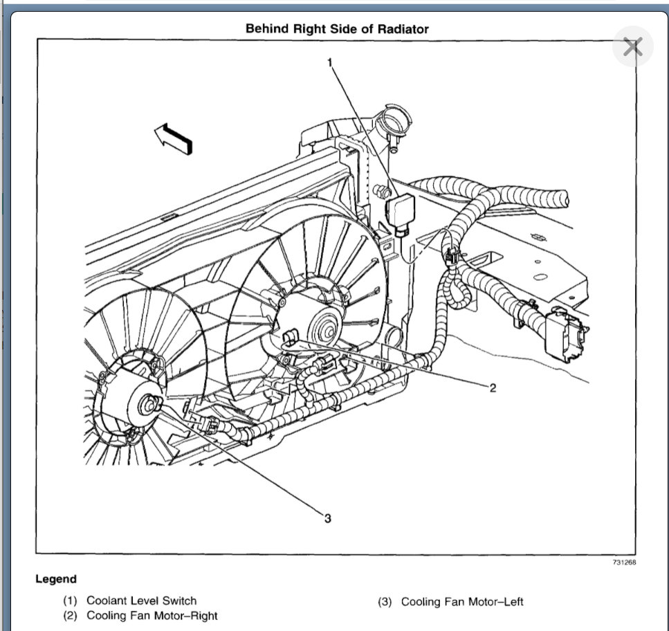

Where is the sensor located and is replacement difficult
Oct 25, 2009 at 7:36 PM
JDL
  • 16,098 POSTS

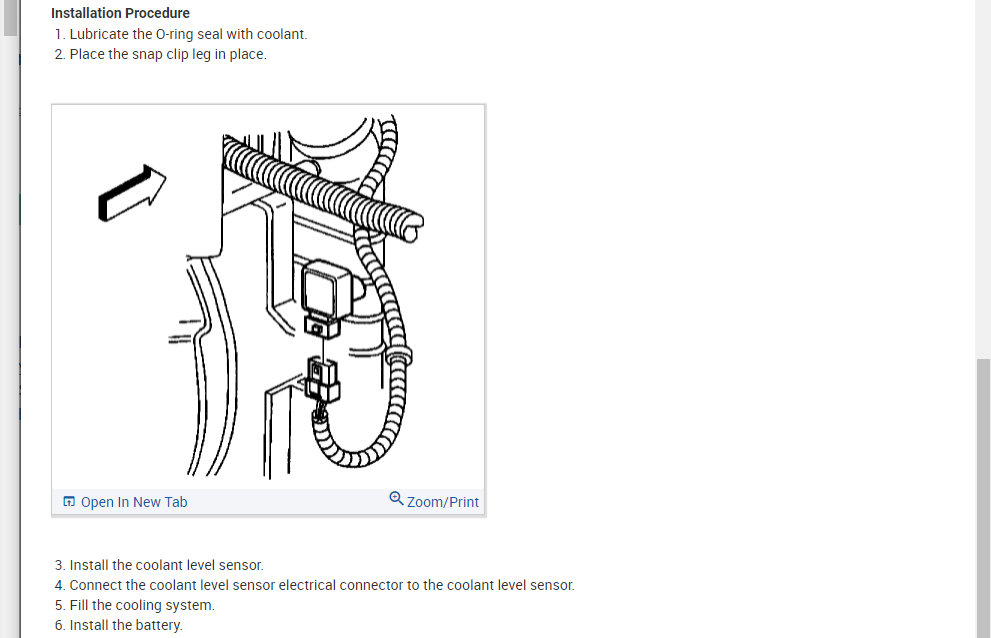

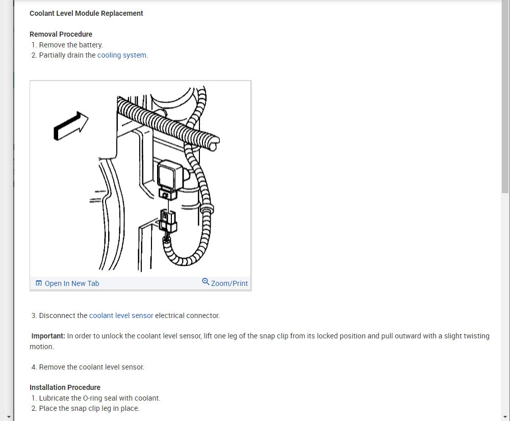

This sensor is located on the right side behind the radiator.
I am attaching all the info below from the manual.
However, while you are doing this, you may want to check the coolant and replace it while you are doing this. Here is a guide that will help with this.
https://www.2carpros.com/articles/coolant-flush-and-refill-all-cars
Please see the info below on how to replace this and let us know if you have questions.
Thanks

Try removing the lowcoolant sensor from the reservoir bottle and cleaning it.
If that doesn't work, replace the sensor.
May 26, 2021 at 12:24 PM (Merged)
DOPPLERFX
I had the same problem shortly after correcting a lower intake manifold leak that had allowed oil to enter the coolant. The oil apparently fouled the sensor. I can't remember if I tried to clean it or not, but I do know that I ulitmately replaced it and the problem went away for good.
The sensor is on the passnger side of the radiator below the radiator cap. It is black and square and has a single plug at the bottom. It is held onto the radiator by a metal retaining clip. Remove the clip and the sensor pulls out of the radiator. Disconnect the wire by pulling carefully on the plastic lock and pull on the plug. Fluid will leak out to level of sensor. Drain or place catch basin below sensor plug to catch radiator fluid.
