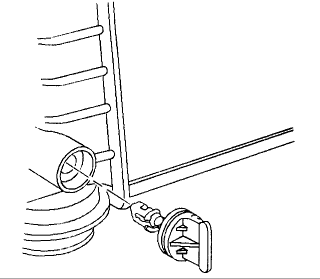

I need to do a coolant flush on the car, it keeps overheating.

Here is a guide to help you step by step with instructions in the diagrams below to show you how on your car.

The drain plug is on the lower left tank of the radiator here is a guide and a diagram (below) to help you see what to do.
https://www.2carpros.com/articles/coolant-flush-and-refill-all-cars
I prefer to pull off the lower radiator hose. Drains a lot faster. To drain the block you should remove the block plugs on them if possible. If not just ad water and run it through the system. And re-drain and refill with proper coolant.

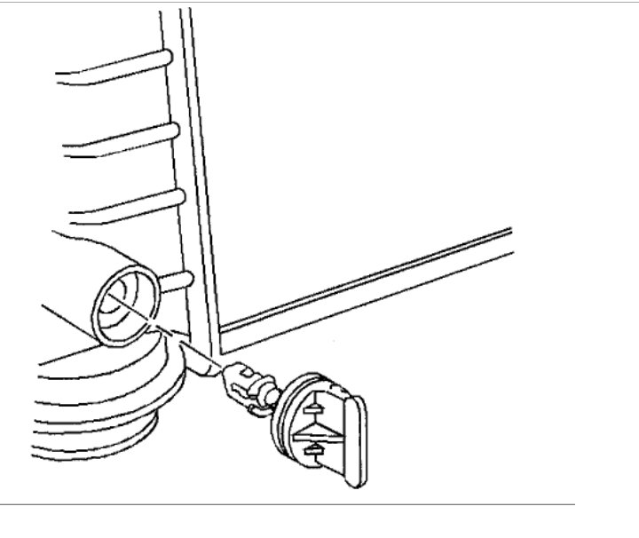

Could you please tell me where the radiator drain is located on my 2000 century. thanks so much

Hello It should be located at the lower drivers side of the radiator.
https://images.2carpros.com/forum/automotive_pictures/248015_84980747_1.gif
Hope this helps

Where is the drain for the Radiator. or does it have one?

It should be on the lower driver's side. It will look like a wing nut. If there isn't one, you may have to remove the lower radiator hose to drain the system.
