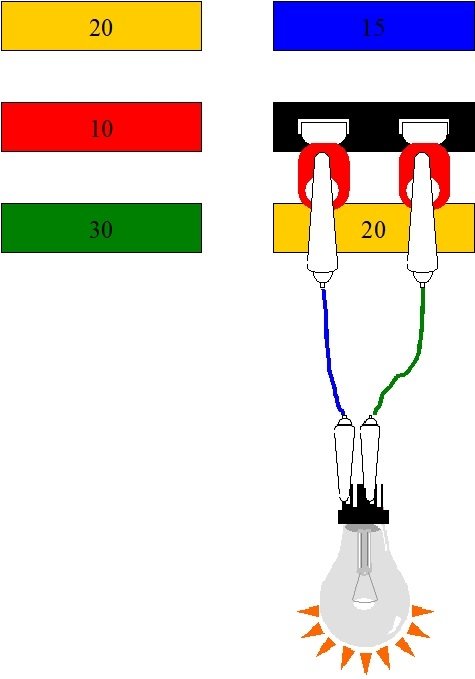

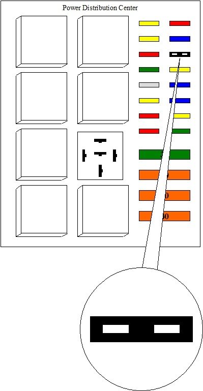

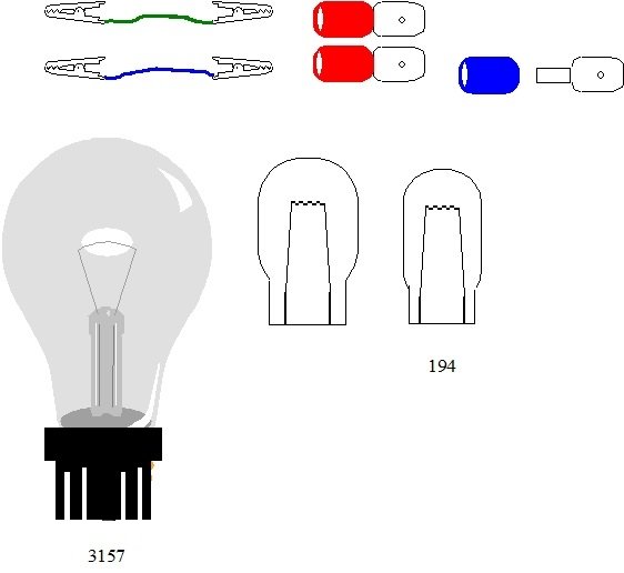

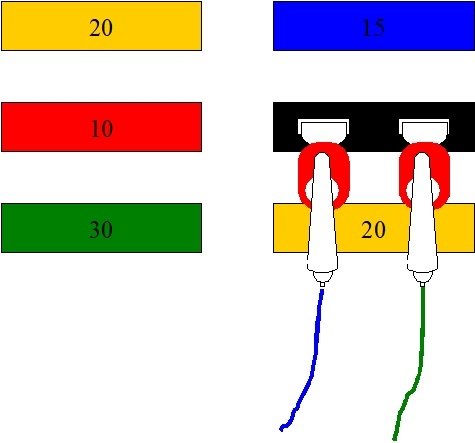

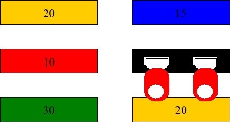

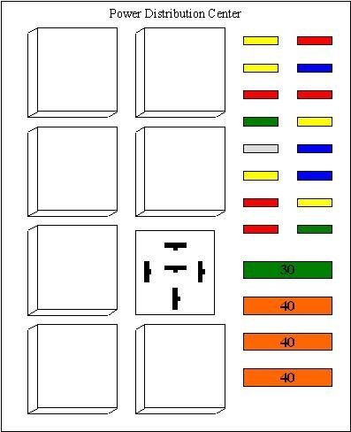

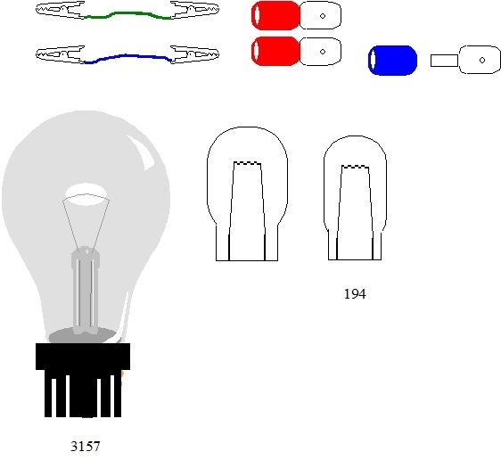

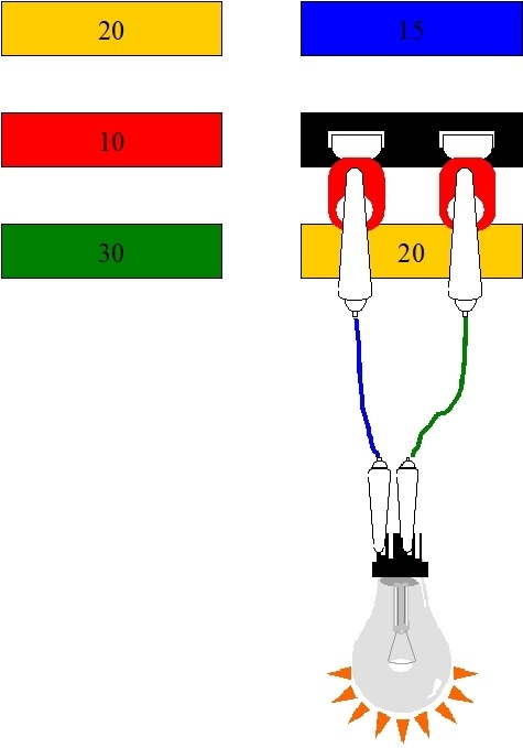

You came close to doing my trick for finding shorts. Instead of a jumper wire across the fuse socket, use a 12-volt light bulb. A 3157 brake light bulb works well. It will allow you to power-up the circuit without wasting a lot of fuses, and that bulb will limit current to a safe one amp. When the short is present, it will do the same thing a door switch does for the dome lights. The test bulb will be full brightness and hot, so be careful where you lay it. I made a test harness out of a right rear Dodge Viper harness where I could plug in up to five bulbs in parallel depending on how current needed to flow in the circuit under test. It was long enough to reach down to the fuse box, and to be hung from the rear-view mirror. You'll need to be able to see the test bulb(s) from where you're working. Now you can unplug things, wiggle connectors, move wiring harnesses around, or anything else that might affect the short. When you do something to make the short go away, the test light will go out, flicker, or become dim.
These drawings show each step of the process. There's probably more included than you need, but this might help others researching this topic.
