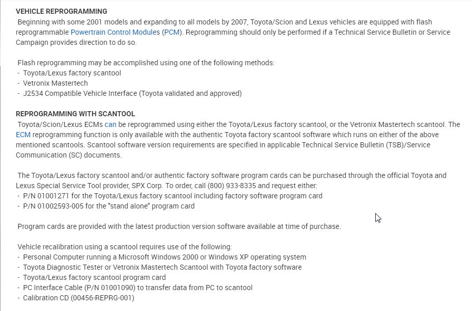

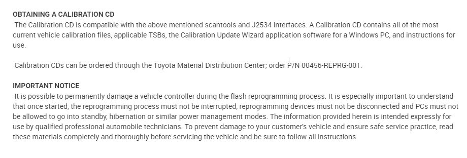

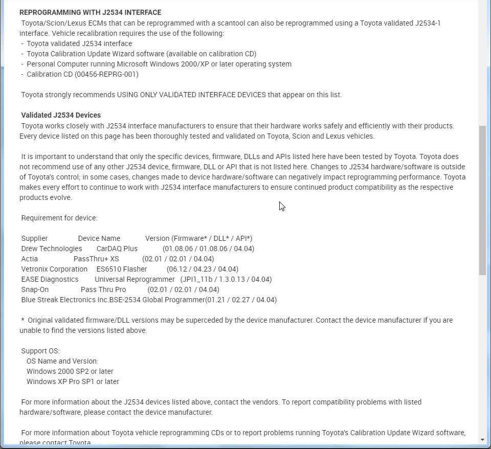

I am attaching the information about flashing this ECM. I would recommend you contact the company you bought it from and make sure it was not pre-programmed. Most of them that you buy online are already programmed. So if yours is then it is either the wrong software installed in it or the ECM could be defective. I would start with the info that the original ECM starts the vehicle and this one does not.
If it is not programmed then take a look at this info to get it flashed. You will need the capable scan tool or the CD option that it talks about.
