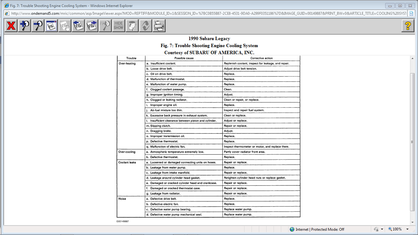

Car overheated, did a exhaust gas combustion test and it showed to be positive. Pulled engine removed heads had them leak checked surfaced and valves ground. Replaced all needed gaskets and seals, coated head gaskets with copper coat and torqued heads properly. Replaced engine, evacuated the cooling system with a vacuum coolant tool it held 30 inches of vacuum for as long as I wanted to let it, filled the system with the proper mix and it still overheats. New water pump new thermostat new timing set and a new radiator.

This could be a problem with the serpentine belt tensioner allowing the serpentine belt to slip and not adequitely spin the water pump. Another thing you might consider is making sure that there are no air pockets in the cooling system not allowing the coolant to circulate. The best way to do this is fill the system from the highest point in the system with the radiator cap off. When coolant starts to come out of the radiator cap hole, the system should be full of coolant and air pocket free. You might also consider doing a flush and fill. I know basically your whole cooling system is new, but maybe you have scale and deposits in your block, clogging the water jacket ports. The last thing I can think might be your problem would to be to double check to make sure you have the correct temp thermostat. Let us know what you find out.

Water pump is driven by the timing belt, all timing components have been replaced. Correct thermostat temperature is in, this is the second thermostat as a precaution 170 degree. Vacuum filled cooling system to eliminate air pockets. While the heads were off I cleaned all the water cooling jackets with a brush and then chemically flushed the engine after install prior to filling with coolant. All hoses are also new.

Run the same combustion gas test and see if it's still leaking under compression. (A cheat to test this is to put a balloon over the coolant fill, if it inflates really fast you have a leak) Have seen head gaskets leak like a one way valve before on them. Have also seen blocks crack and only leak under pressure.
Whose water pump and gaskets did you use? Some of the aftermarket parts are real junk.

Have you pressure tested the radiator cap? Have seen bad caps cause fluid to over flow and overheat. Also check the coolant temperature sensor. It could be giving a false reading.

Did you replace the water pump the impeller? It could be degraded not circulating the coolant correctly.

if the temp guage goes up and you do not loose fluid then the first thing I think about is the thermastat. If you are looseing fluid then I would have the system pressure checked. A number of things can make it overheat, !. not enough coolant, 2, clogged system, 3, a bad themstat. With the thermastat is usually the problem that I would change first first

I have a subaru legacy 1990 overheating, automatic, all wheel drive. I have changed the thermostat 3 times, water pump, timing belt, got timing reset, filled system and bled, blown out the heater core and put in an expensive head gasket sealer all to still overheating after 15 mins of driving. I am at a loss. The bottom radiator hose stays cool, I don't know if that's normal. Please give me an idea as this is my kids car and we need another 6 months out of it if possible. Changed all the above and still overheating I don't know what to do now. The overflow bottle fills up overflows and then sucks back in after it cools down. Also the heat will blow hot and then go cold before it starts to overheat.

Sounds like you need to get the radiator unclogged. Lower hose should warm up with the engine.

but at the same time one half of the radiator is hot and the other half is cool to the touch. It shouldn't be-should equally be hot across the radiator. That coolant is not circulating. take the thermostat out and run it if its still doing it make sure the water pump is doing its job if it is-try bleeding it for airlock and report back
Water pump check:
One way to test for a bad water pump is to squeeze the upper radiator hose when the engine is hot and idling. Careful, because the hose will be HOT! If you do not feel much coolant circulating through the hose when you rev the engine, the pump may be bad. The other cause might be a bad thermostat that is not opening properly (remove and inspect the thermostat), or a clogged radiator.

Try replacing the thermostat-and check if the water pump is doing its and fan coming On on time if okay try bleeding the cooling system-don't work get it block and pressure tested-

If you see bubbling in the coolant reservoir when the engine is cold, suspect the head gasket. Also, there won't be any steam and the coolant and hoses will still be cold.
Your mechanic will use a special tool to check for combustion gases leaking from the cylinders into the cooling system. It is a glass cylinder with two chambers partially filled with a dark blue liquid. Air is drawn through the fluid from the radiator. If combustion gases are present, the fluid will turn bright yellow. That will be conclusive of a leaking head gasket.
