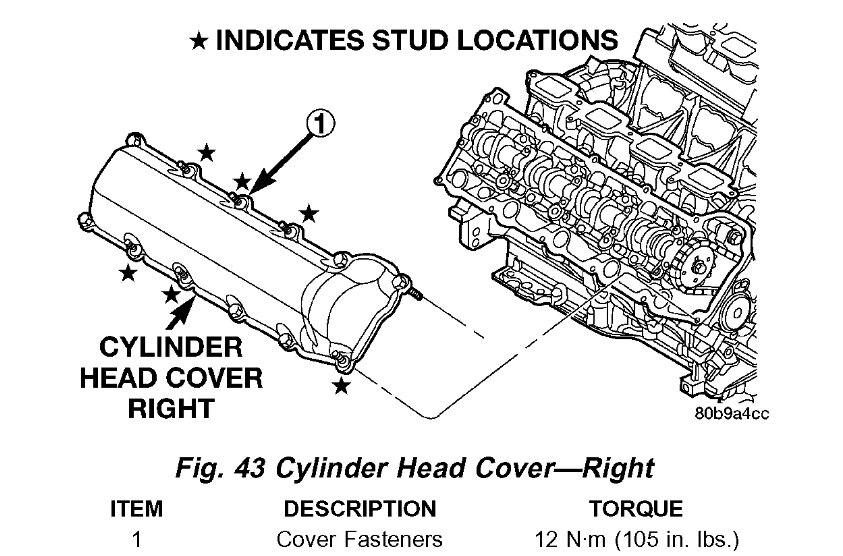

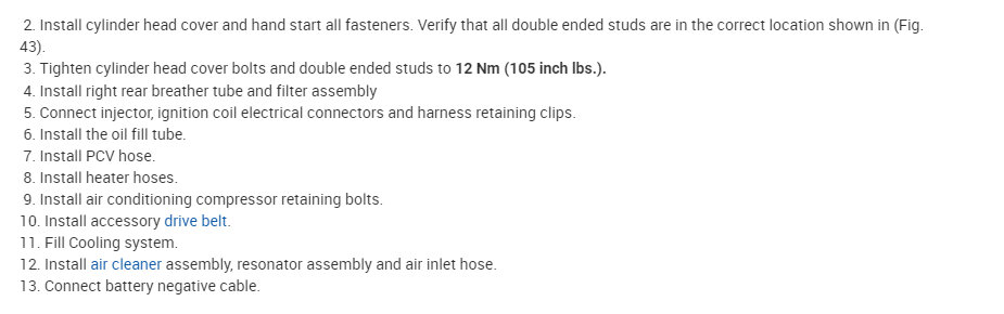

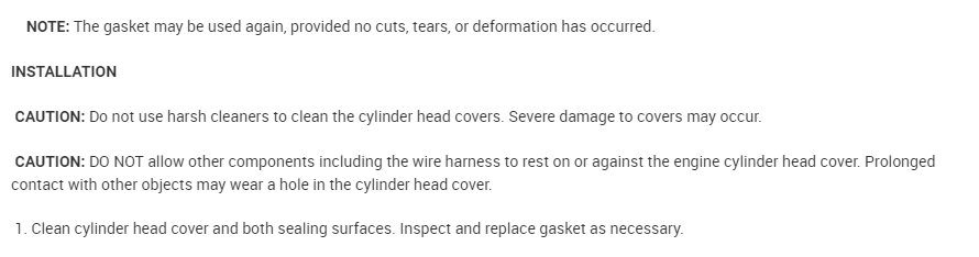

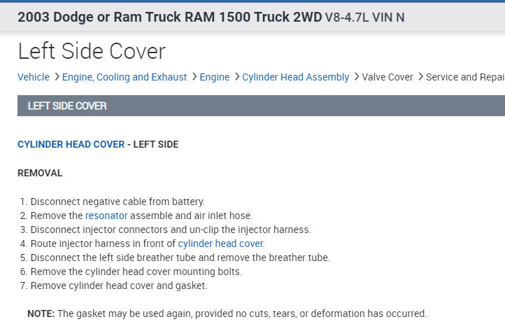

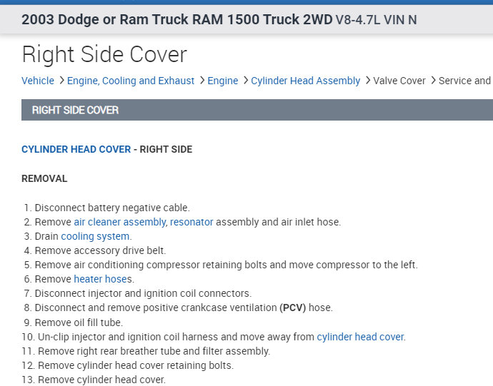

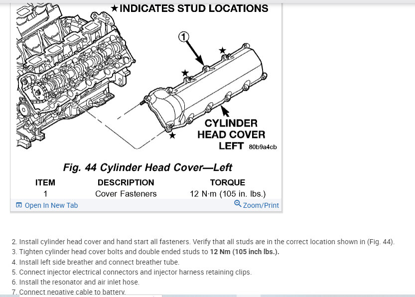

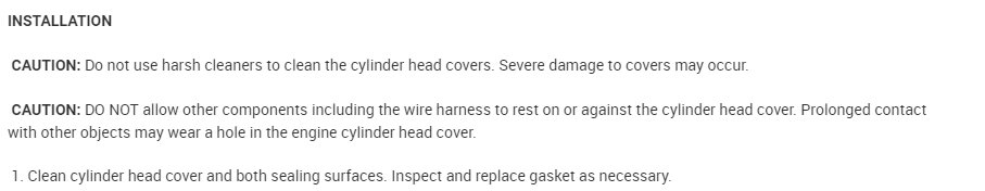

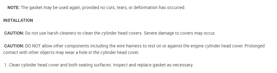

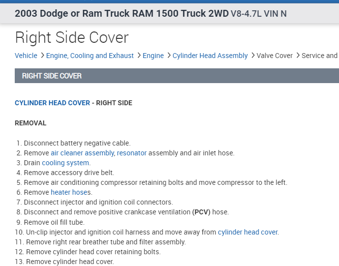

What you need to do is remove the valve covers and inspect the seals. Once the valve covers are removed, visually inspect the valve stems and the area where the valve stem meets the valve guide. Look for signs of oil accumulation or residue on the valve stems or around the valve guide area. If you notice excessive oil buildup or visible damage to the seals, it may indicate worn or damaged valve seals.
I attached the directions below showing how to remove and reinstall the valve covers. Note that it is broken down for each side.
Let me know what you find or if you have questions.
