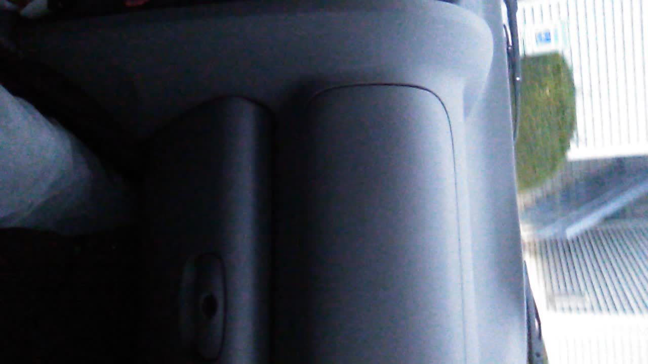

I just started having an issue when I step on gas pedal, I'm hearing what sounds like an electrical short. When I stop accelerating, noise stops. I looked around the net, but what I saw mentioned the engine stopping. which it did not stop. I checked recall info and called my dealer. They said my car (verified by VIN #) doesn't have any recalls on it that are undone. What could this be? Is it serious? Thanks!

Hello, so there is no 2.3-liter V6 Santa Fe, I think you mean 2.7Liter. And is this the GLS or LX model? I will try to help you out, but if you had a wire shorting out, it would most likely blow a fuse.
There is a 2.4-liter engine
Also, some more information would help, is this possibly a very fast clicking noise? And where exactly is the noise coming from?

It's a GLS not LX. okay, maybe it's a 2.4 liter. The noise sounds like it's coming from near where the glovebox is. It didn't sound like clicks; it literally sounds like something electric sounding shorting out. I don't know how else to describe it. I looked at more stories online. Could this be caused by dirt in my fuel injectors, and should I try adding fuel injector cleaner? Also, I had AC replaced over the summer. Recently I have been driving with heat and or defrost when I start the car in the mornings. Thanks very much!

If you did smell electrical burn, then yes that's a major concern. it's hard to say what it can be, cars have miles of wiring in them, are you able to take a drive with someone who can do a video so we can at least hear the sound.

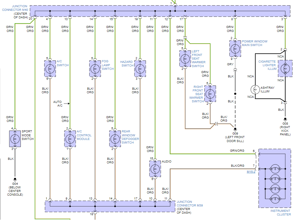

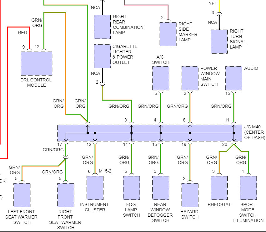

The only real part of the electrical system behind the glove box area is the blower motor for the heating and A/C system. Does this vehicle have Automatic HVAC or Manual? Meaning can you set the temperatures different for the driver side and the passenger side?

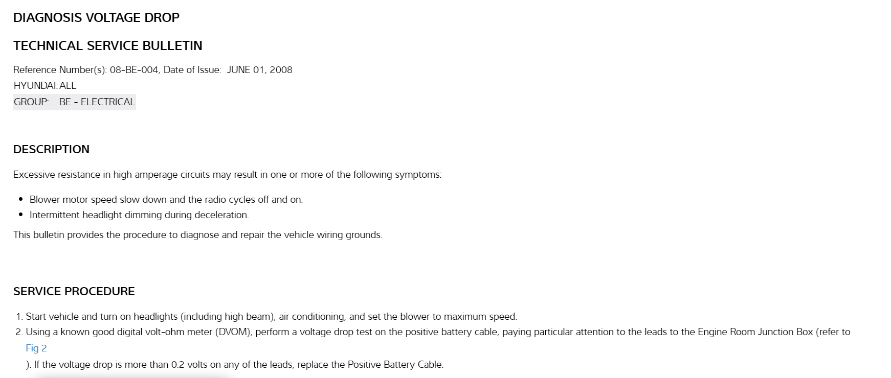

The technical service bulletin (first pic) is for poor Ground wire issues that can cause the blower motor or headlights to have issues. But what you're describing sounds more like a power wire shorting to ground somewhere in a circuit before the fuse, that's the only way a short to ground would happen. Otherwise, a fuse would blow.
Nov 22, 2021 at 7:06 AM

Do you think I should just have it towed to a shop at this point? I'm getting concerned re driving with the burning smell-I can see if I can keep my cell recording driving myself, in a minute but don't want to endanger anyone asking them to ride with. Two other very recent details: 1: I had asked the place I bought my new tires this summer to check air pressure and tighten the lug nuts 12 days ago, since a couple months had passed since buying new tires
2: while driving a couple weeks ago, I hit a puddle that was in a dip, though I didn't notice the strange sound until about 2 days ago. I'll go try to record doing a lap at 35 mph and hope phone keeps filming/recording-not sure this will work but will attempt it. Thank you!

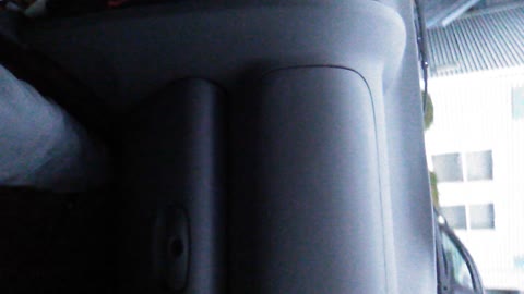

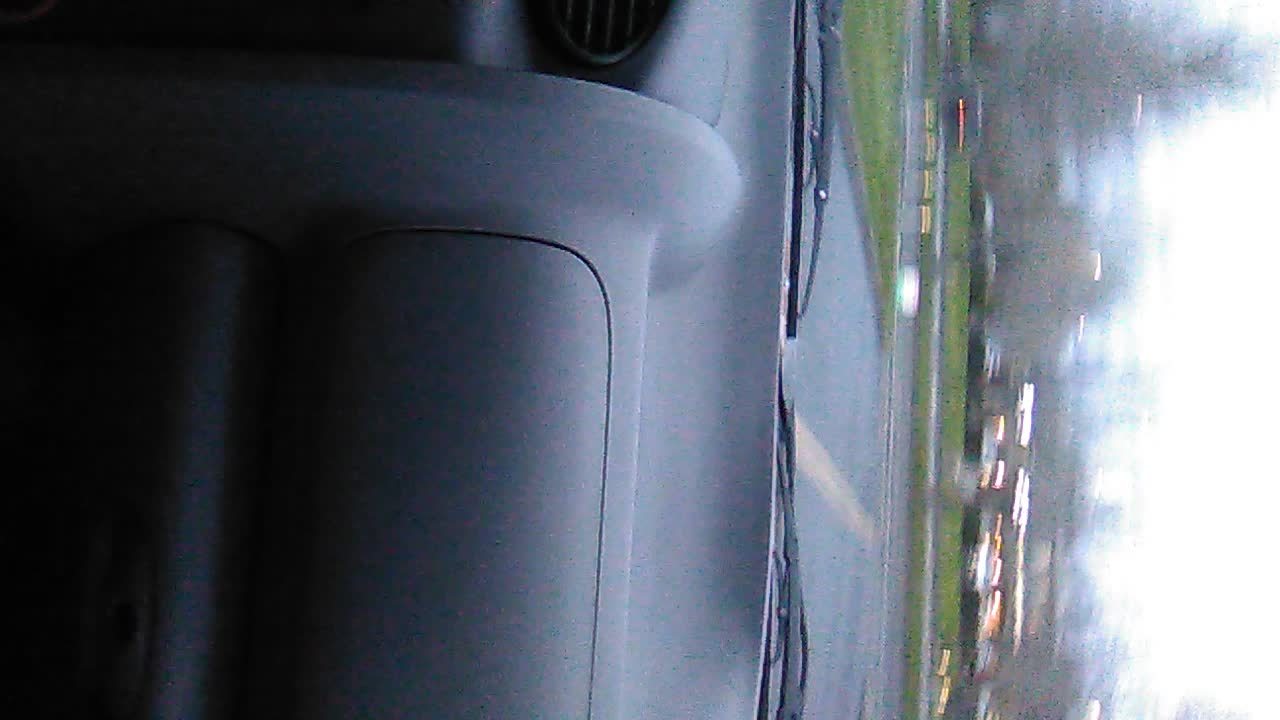

Ha! Just got a decent recording! Sending now.
Nov 22, 2021 at 8:24 AM

here's 1 recording-had to reenter it there are two more. this one is the shuffling sound video; sorry it didn't upload right first. Video #3 you can really hear sound the best.

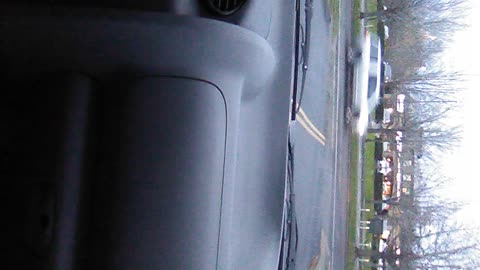

here's recording #2:

here's recording #3 one of the 3 recordings sounded like a "shuffling noise" when replayed, which is not how it sounds in the car-the other 2 recordings captured the zapping sound better, 1 better than the other.
Nov 22, 2021 at 8:44 AM
BBW54321
  • 17 POSTS
#3 is the best clip to hear the sound!

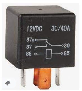

Okay, that to me sounds like a relay turning on and off really fast, that's not an electricity jumping to ground. What an automotive relay does is turns on a high current circuit using a low current circuit. They do this so that things like computers in the car can turn on Higher current circuits without damaging the computer. Relays over time develop carbon build up on the contacts and this causes them to not be able to keep their connections made. Thats what I am hearing, although I'm not in the car with you. So, what ever circuit this relay controls may not be shutting down because the circuit is not really being turned off, it's on again, off again, on again, off again, and happening so fast that the component it controls just isn't shutting down. For instance, if that was controlling your heater blower motor, it's just not fully losing power as an example. But it will need to be diagnosed since it's hard to tell which side its actually coming from. But I have heard them do that many times. It's a sign of it starting to fail. I would also have the charging system checked, specifically that the alternator is not putting out any AC voltage ripple and it's putting out the correct DC voltage. But take it to a technician you trust. Don't let them sell you a bunch of stuff you don't need, if you're in doubt of what they say, just ask us. We're always honest here. We're not selling anything. Just helping people. Here's a guide to relays except yours is under the dash somewhere. Most likely in the fuse panel. If you can access it while this is happening, you'll be able to feel the relay itself doing this. Added a picture of an automotive relay too.
Let me just add that if there is a loose ground wire for this relay, it will cause the same condition.

If they can do diagnostic work, an oscilloscope is needed to check Alternator AC ripple.
You can explain the situation and see what they say. I only mention the Alternator because that and the battery can cause so many more problems than people realize. If there is low system voltage for one, then all the voltage in the whole car is going to be low. AC ripple destroys Automotive computers because they are designed for DC voltage only. I'm sure an Alternator shop does more than just charging systems.
What you can do is on your way to the shop, turn some things off, see if the clicking stops.
It should not cost much to replace a $15.00 relay: they just need to figure out which one it is. Going through the wiring diagrams I could probably tell you how many are under the dash, but they can take care of that. I'm assuming the reason it's happening more when you accelerate is the alternator is putting out more current, and this relay is warming up faster and the problem is presenting itself more. Unless it's a bad ground wire that's just vibrating more with the engine at higher RPMs, so 2 scenarios there. But i don't think and hope it doesn't cost you much at all.

Thanks very much again! So, it turns out that the strange noise was actually being made by a tab on the rear-view mirror! The shop didn't even charge me for the diagnosis, and I am extremely grateful!! So, the very strange issue ended up not being something serious, and your terrific help brought goodness!! May you remain wonderfully blessed and stay healthy please!
