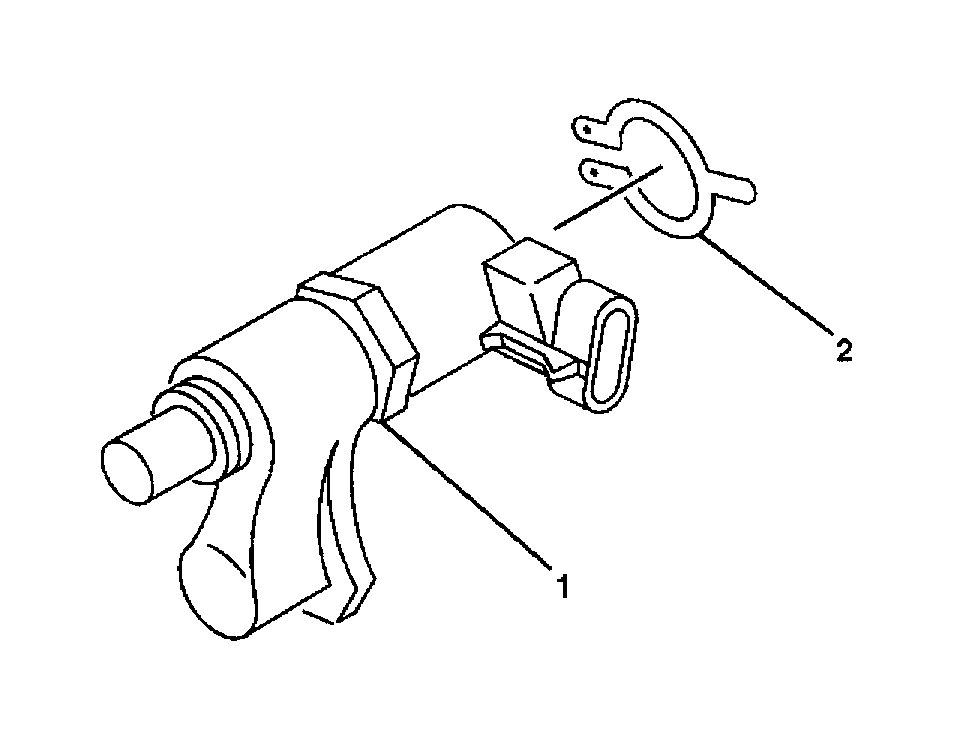

What is the solenoid/sensor attached to my pump inline with the high pressure line?Any pump replace video I can find online? The truck in the video does not have it. I cannot get it off old pump to swap over and i would like to replace it anyway to eliminate a possible weak link. I spoke to GM and the parts guy said it is a superseded part. Any information?

I believe you are referring to the pump flow control valve. Here are the directions. The attached picture correlates with these directions.
Power Steering Pump Flow Control Valve Actuator Replacement - On Vehicle
Disassembly Procedure
1. Remove the electrical connector from the variable assist steering actuator (1).
2. Remove pump assembly from the vehicle, if the variable assist steering actuator (1) is not accessible.
3. Remove the retaining ring (2) from the variable assist steering actuator (1).
Important: Note the orientation of the variable assist steering actuator discharge fitting.
4. Remove the variable assist steering actuator (1).
5. Remove the O-ring seal from the variable assist steering actuator.
Assembly Procedure
1. Lubricate and install the new O-ring seal with power steering fluid.
Notice: Refer to Fastener Notice in Service Precautions.
2. Install the variable assist steering actuator (1) to the pump assembly.
Tighten the actuator to 62 Nm (46 ft. lbs.).
3. Install the negative battery cable.
Important: If a new variable assist steering actuator (1) is being installed, position the electrical connector before installing the retaining ring (2).
4. Install the electrical connector to the variable assist steering actuator (1).
5. Install the retaining ring (2) to the variable assist steering actuator (1).

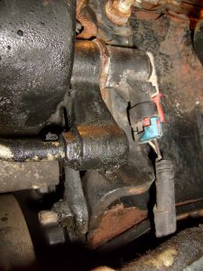

You were exactly correct the shaft on the power steering unit is sheared. I can not find a power steering pump with the EVO electrical plug receiver on. Does the EVO inlet from the old pump thread off? Can I thread it onto the new unit? A GM dealer told me my GM pump part no. 26069033 has been discontinued. Maybe I'm asking the wrong questions but all I can find is the pump without the EVO (what I call the electronic plug attachment) on the unit. What are my options. Thanks for the great diagnosis!!! john Picture shows bottom of pump with electrical line and fluid line

That is the valve that controls the pump pressure at times when in use.
