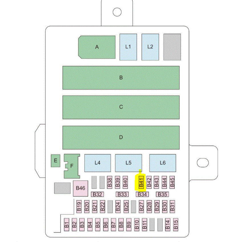

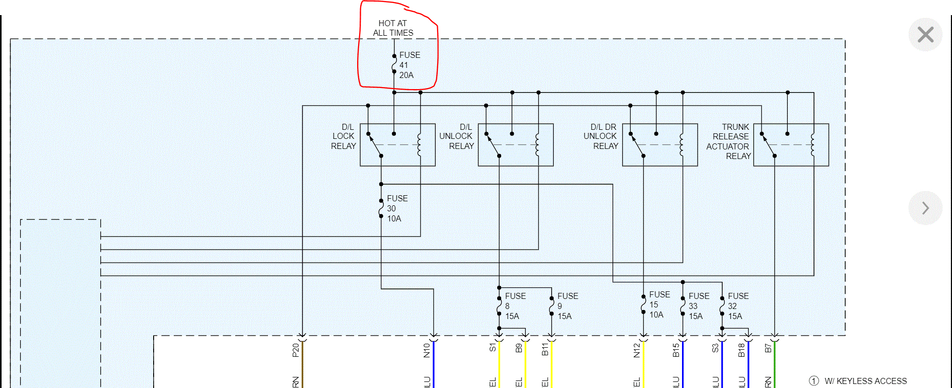

The only thing working on my key fob is the unlock button. And inside the car on both door panels I can’t lock or unlock the car. Also when I put the car in drive my doors won’t lock. So basically I can’t lock my car.
Aug 9, 2020 at 11:47 AM
  • 110,236 POSTS

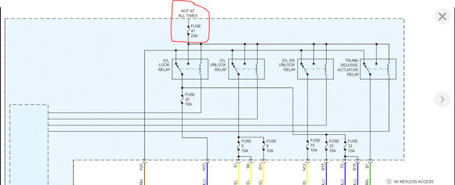

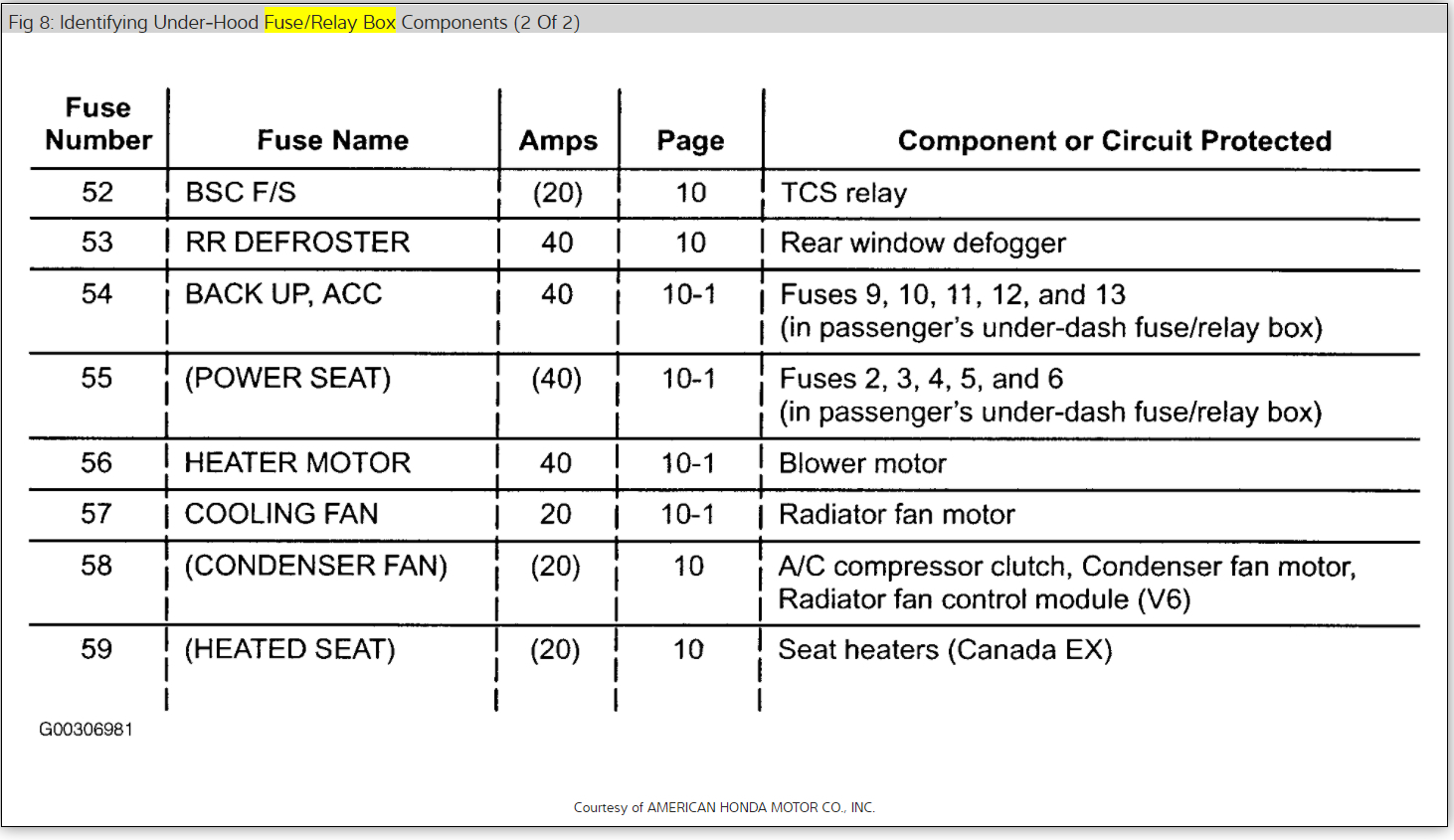

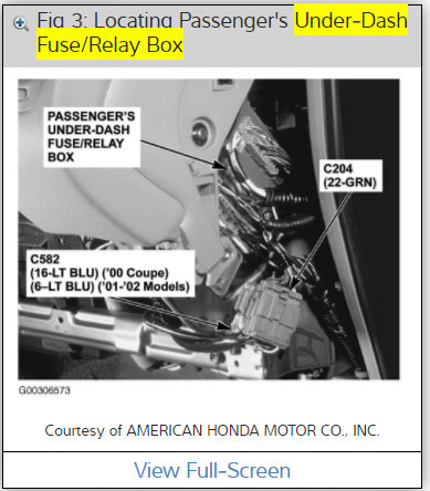

I looked up the wiring schematic for the power door locks. It is six pages long. LOL There are multiple fuses throughout the system. What I want you to do first, is check fuse 41 in the fuse/relay box under the left side of the dash. That fuse powers all of the relays for the locks. See the attached pics. Pic 2 shows the location. I highlighted the fuse to check. If you are not in the US, I need to know because the locations are different. Also, I am basing this on a 4 door sedan and not a coupe.
Now, in addition to just checking the fuse, I need you to confirm there is power to the fuse. Here is a link that shows you how that is done:
Do this and let me know what you find.

Okay, and if something is wrong does that mean I need to get a new fuse or what I’m taking it to the dealership in the morning. How much does it normally run for this type of fix?
Aug 9, 2020 at 2:33 PM
  • 110,236 POSTS
The fuse is something you can do yourself. I suggested starting with that fuse because it powers all of the relays. Since none of them are working, the fuse is the first thing to check simply because all of the relays wouldn't have gone bad at the same time.
A relay isn't expensive at all, but I don't think that is the issue. I have a feeling it's something simple.
If you have a chance, let me know what they tell you.

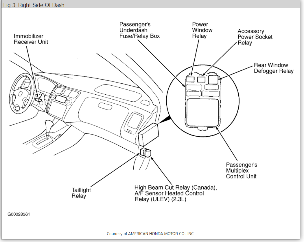

CITIZENK
Both of the rear door locks are not working. They will unlock lock/unlock when I manually push the individual doors button by hand. They do not work when using the front driverside master locking button and they do not work when using the keyless entry. I have chcked the fuses and they are good. I have little to no experience working on cars and would like to know possible reasons for the door lock failures as well as the difficulty of each possible solution. Thanks!
Jan 21, 2021 at 4:43 AM (Merged)
KHLOW2008
  • 41,814 POSTS

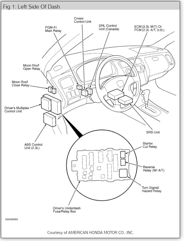

Hi citizenk,
It sounds like the drivers multiplex unit is going out but there are three fuses that need to be checked before. Here is a guide to help test the fuses with the fuse locations and the door lock wiring diagrams so you can see how the system works and which fuses to check.
Check out the diagrams (Below). Please let us know what you find. We are interested to see what it is.

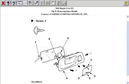

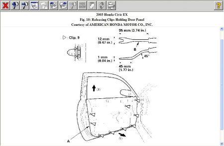

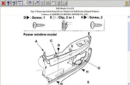

when i use the remote to lock the doors,just the lock of right door works,left not,so i want to fix it ,but firstly i have to know how to disemble the left door ,then i can check what ' problem with the lock.thanks a lot.
Jan 21, 2021 at 4:44 AM (Merged)
KHLOW2008
  • 41,814 POSTS
Hi yongtao,
https://images.2carpros.com/forum/automotive_pictures/192750_InnerHandle03Civic_1.jpg
https://images.2carpros.com/forum/automotive_pictures/192750_SwitchPanel03Civic_1.jpg
https://images.2carpros.com/forum/automotive_pictures/192750_PanelClipsDoor03Civic_1.jpg
YONGTAO
thank you!
