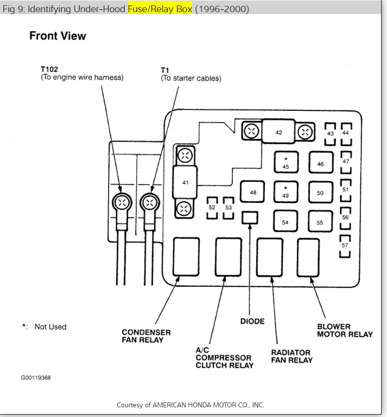

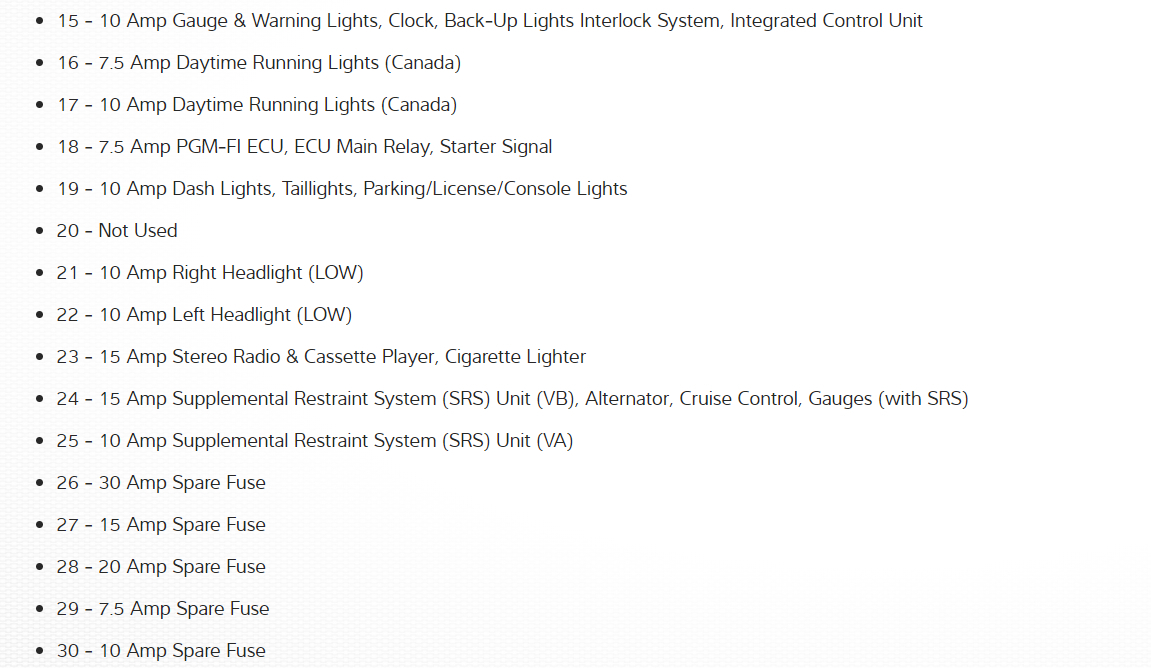

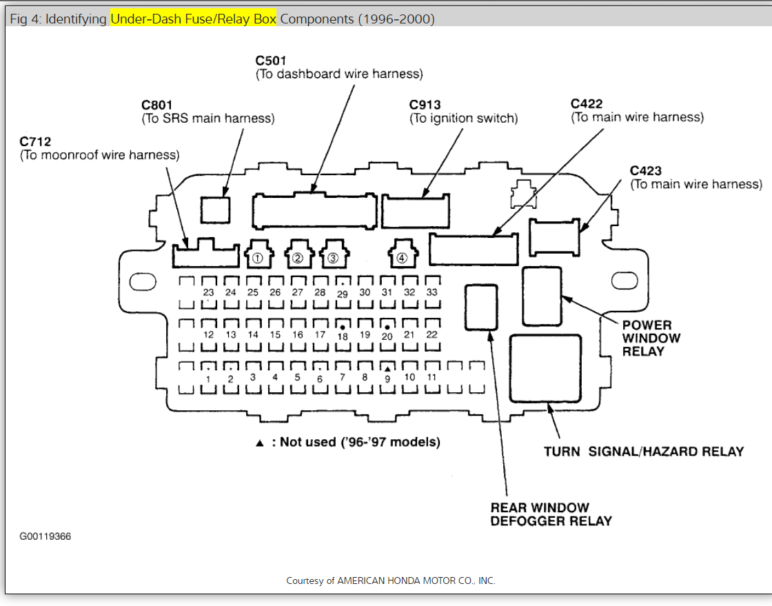

Hello. My power door locks recently stopped working completely. I havent had any glicthes with them before. I checked all my fuses and can't figure out what is wrong. I am still able to unlock the doors manually. Thank you
Tuesday, March 23rd, 2010 AT 1:40 PM
26 Replies
KHLOW2008
  • 41,814 POSTS

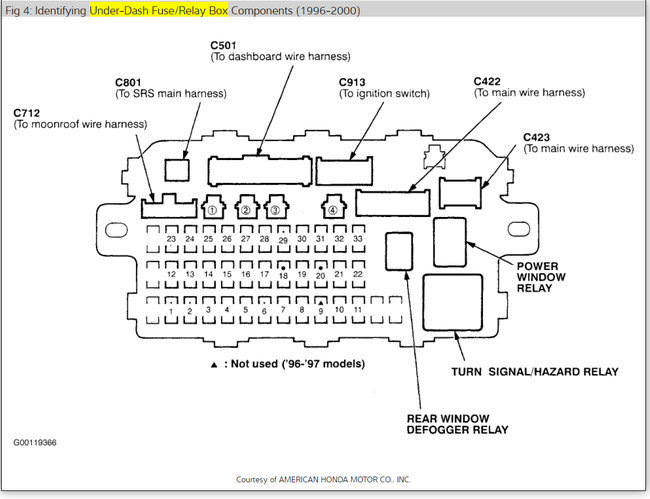

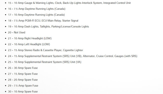

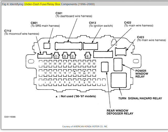

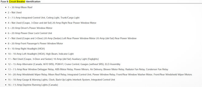

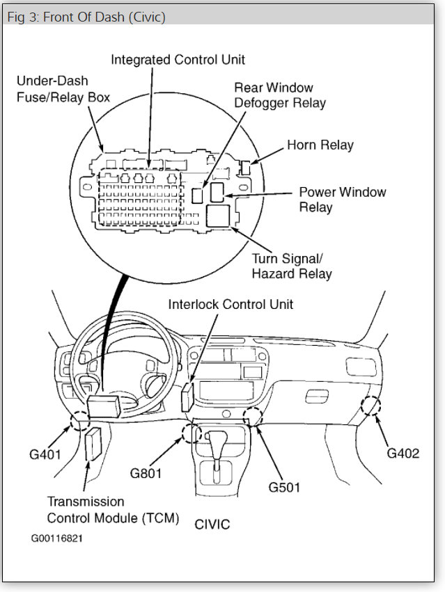

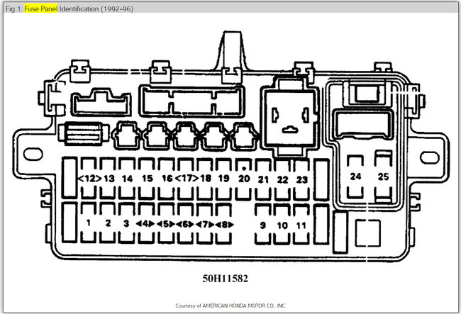

Hi MicNB,
The power door lock fuse in # 51 ( 20 A) in underhood fuse box. The item likely to cause the problem would be the control unit, located at front of driver door, behind the door panel. Here is a guide to help test tit with the fuse location in the diagrams below.

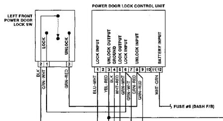

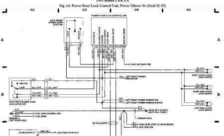

ACROCK
The electic door locks just stopped working. I used a v/o meter to check the seitch on the driver door and it show the switch is working properly. Then I tried checking the door lock actuator on the driver side door there was only one position that the switch showed continuity. I do not know where to begin to check the door lock control unit that is in the driver door. It is a united technologies unit. I got a unit out of a 1992 Civic but it is a Mitsubishi unit and the electronics inside are completely different even though it uses the same plug for both units. I have even checked the fuse and it is fine.
+2
Thursday, January 21st, 2021 AT 1:20 PM (Merged)
KHLOW2008
  • 41,814 POSTS
Hi Acrock,
Is there any power supply to control unit?
Did you test the actuators?
https://www.2carpros.com/forum/automotive_pictures/192750_Civic93CentralLock01a_1.jpg
+13
ACROCK
I have tested the actuator switch in the driver door and it will show continuity when the switch is activated. As for power to the door lock control I have not checked that yet. It is hard for me to tell from the diagram which wire is the power wire. It seems to me that if a door actuator was bad it would short out and blow the fuse.
