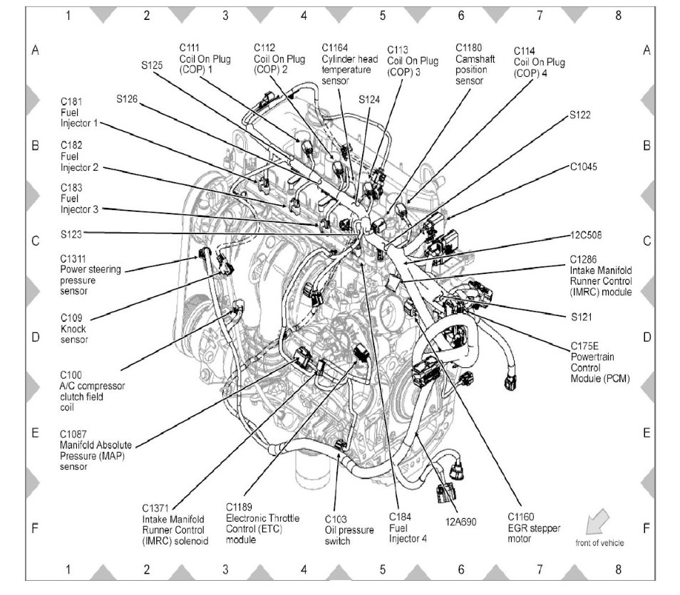

I have a problem with my car.
1. When I start the engine it went off itself if I'm not pressing accelerator .
2. When I have to drive it than I have to move on a higher rev because when it on a normal rev it will went off itself.
3. when I drive it it drops power and start jackie life it short of petrol..

This is common when the throttle actuator needs to be serviced. here is a guide that will help you fix the problem:
