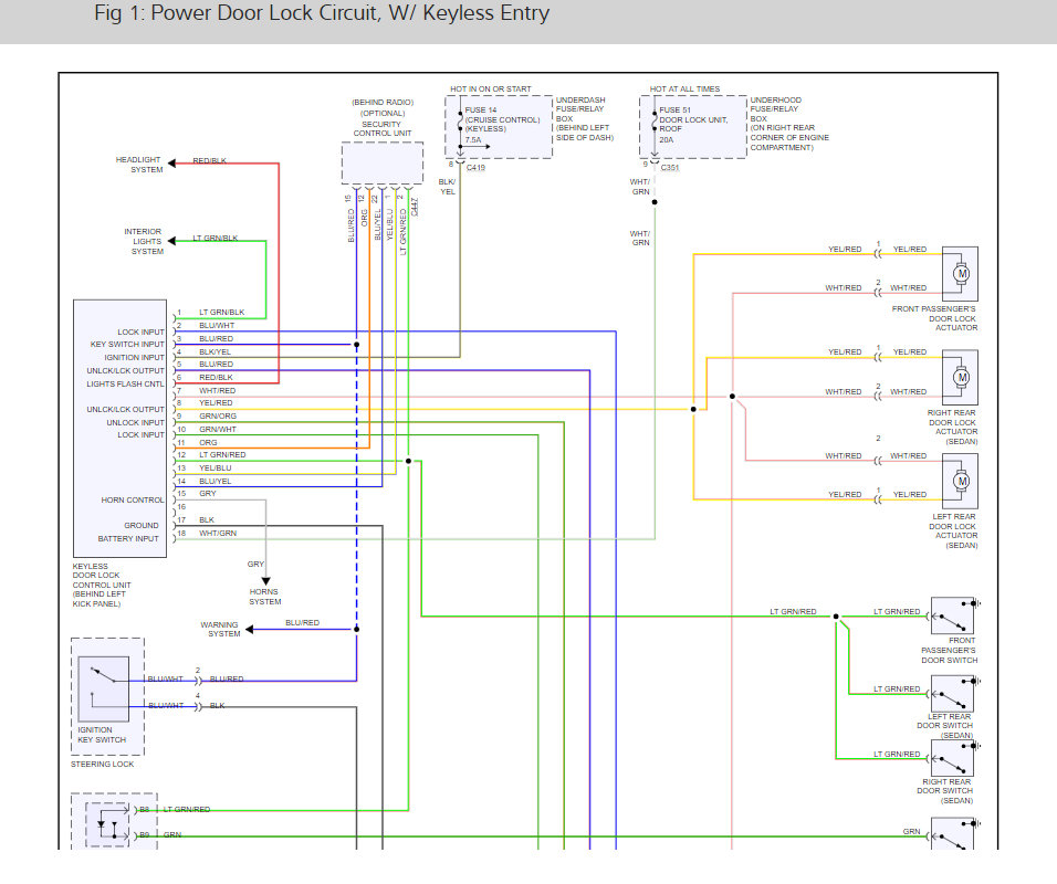

Hi there,

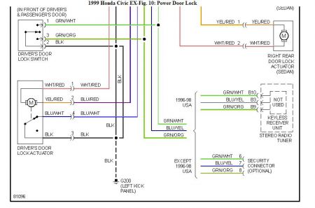

Would a failing driver's door actuator cause the other doors to not lock/unlock, or are most likely all 4 door hosed up? Could you please inform me about this as only my car drivers's side lock/unlock is working.... I checked the switch and then the Door Lock Control unit... Both are working fine. Checked them in my friend's car of the same model and type. I see the fuse are fine and Wiring seems to be ok.... Can I check that the wring and actuator of the other 3 door are ok from the harness of the door control device. What can be the problem??? I appreciate any answer and if possble could you please email me just the doors cirucit diagram.
Jan 21, 2021 at 4:57 AM (Merged)
KHLOW2008
  • 41,812 POSTS
Hi mferna14, Here you are.
https://images.2carpros.com/forum/automotive_pictures/192750_PowerLock99Civic01a_1.jpg
https://images.2carpros.com/forum/automotive_pictures/192750_PowerLock99Civic01b_1.jpg
MFERNA14
  • 5 POSTS
KHLOW2008
  • 41,812 POSTS

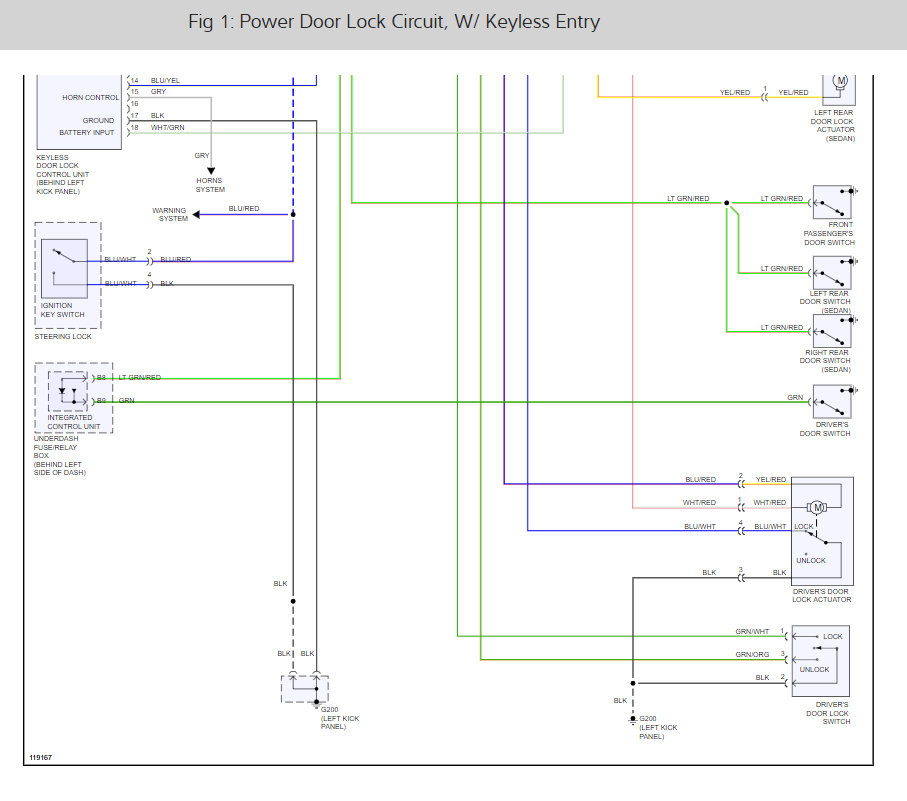

The driver's door lock actuator can be used for locking but not unlocking the other doors.
From the diagram you can see that if the lock is faulty, it would not provide power supply to the driver's door lock switch so it can cause the other 3 doors not top lock or unlock.

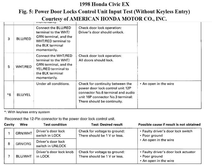

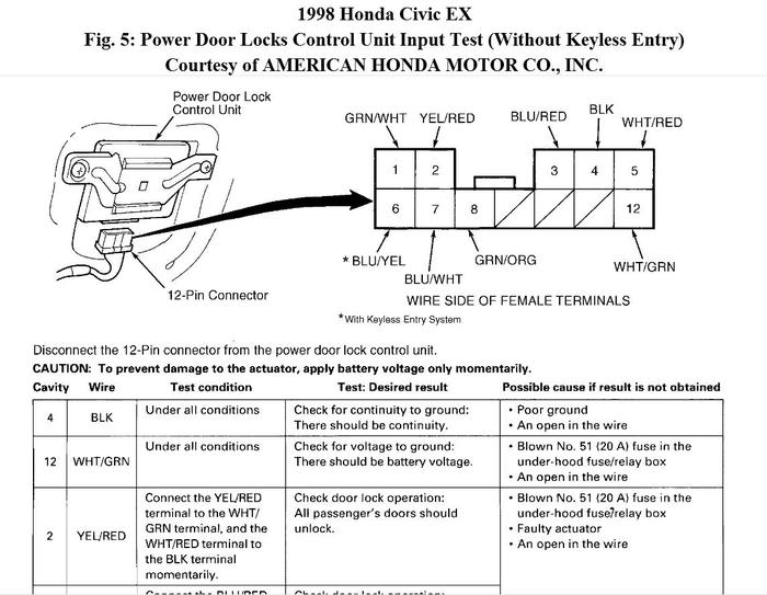

KHLOW2008
  • 41,812 POSTS
Remove left door panel. Using a DVOM, perform power door lock unit input tests. See Fig. 5 . If all input test results are okay, inspect connector and terminals for damage and proper fit. If connector is okay and power door lock still malfunctions, replace power door lock control unit.

Does manual locking of the driver door operates the door locks?
If you have a blown underdash # 51 (20 A) fuse, the central locking system would not operate.
