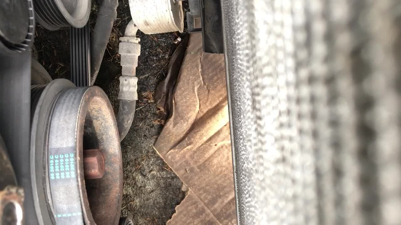

The P0313 is just a generic code of a misfire and low fuel. Have we tried using starter fluid in the intake then cranking the engine to see if it fires for a second or two? Just spray about 3-4 bursts of starter fluid and then crank the engine and see what happens.
Also, can you get a video of what the engine is doing when you crank the engine? Basically I just want to hear what it sounds like.
Apr 25, 2020 at 2:10 AM

Here's a video...

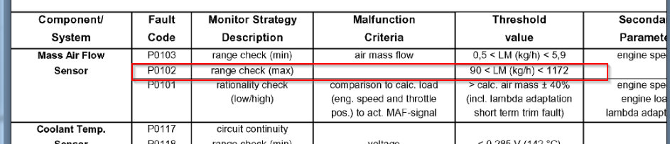

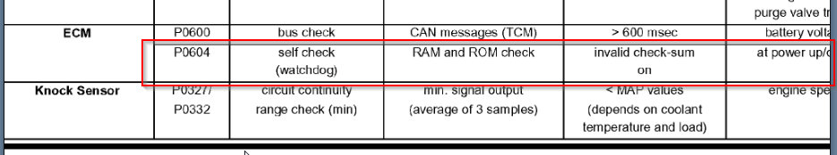

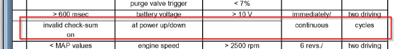

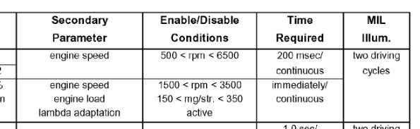

As for this code.
P0604 - Internal Control module Random Access memory error.
It is most likely an internal issue with the ECM. However, I suspect that will clear once you give it a couple drive cycles if it is not a failed ECM. I would just let it idle for a little while and see if the tick and smoke resolve themselves. The smoke may just be water, oil, burning out and the lifters may be tapping a little and could pump up. We want smooth idle and no knocking. You hear this, shut it down.
P0102 - MAF circuit low
Again, I would see if this comes back after a couple drive cycles.
Based on these codes I don't see anything that would give me pause of running the engine. Clearly we want to see the smoke and tic noise to clear up but again, I would just take it a few short drives with easy driving and see what happens.
