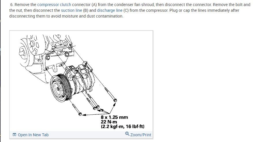

It sounds like the compressor is locking up. Yes, it could be from the added Freon.

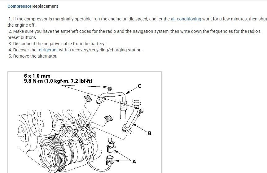

https://www.2carpros.com/articles/replace-air-conditioner-compressor

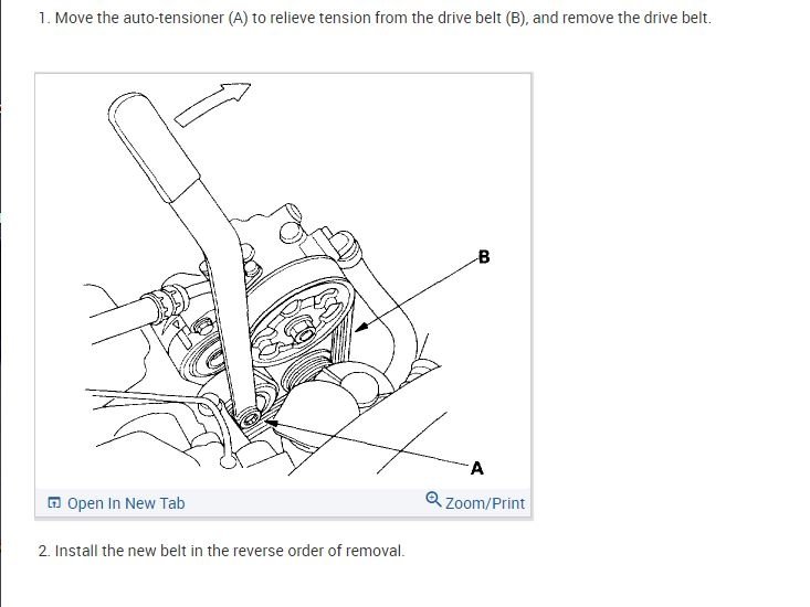

Also, check the belt to be sure it is tight. If it is loose, it will cause this as well.

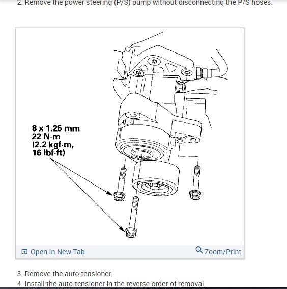

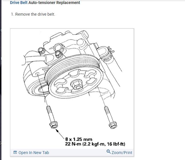

https://www.2carpros.com/articles/how-a-serpentine-belt-works
https://www.2carpros.com/articles/serpentine-belt-tensioner-replacement
