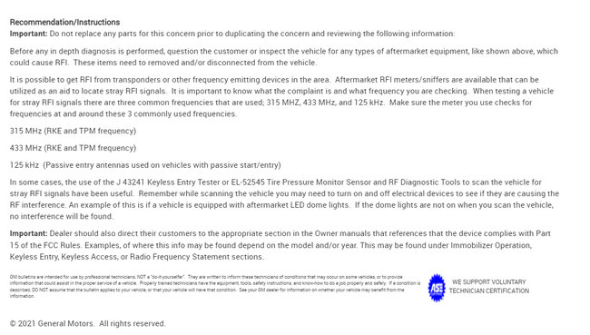

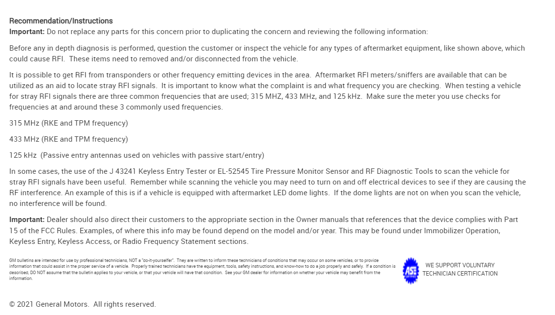

I will get you the wiring diagrams for the crank sensor circuits, but if you dont own any tool, I would recommend you at least get a basic multimeter. One that can read 20volts DC. Even a very basic one from walmart will do. We're only working with a 12volt system, I will also go though the Technical Service Bulletins for any information.
One other thing, do you have anything plugged into the charging ports inside the vehicle, any bluetooth items or anything like that? You dont have any of the items below in your car? Even USB charging devices..

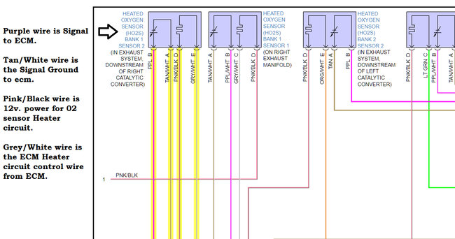

Okay. well, since you are getting these codes together, (p0137 and p0138) which are "signal lower than 0.050v (50mv) for more than 2 min" and "signal higher than 1v for more than 1.5 minutes" I think you have a wiring issue, where the wiring harness is contacting other parts of the harness at different times, for example, for the 02 sensor to read less than 50mv for over 2 minutes, it must be shorting to Ground. 50mv is pretty much nothing. This is the same for the other code as well. For the 02 to read over 1 volt for that amount of time it must be shorting to a power wire somewhere. The criteria states 1v. but that's only the setting criteria, it could very well be 12 volts and it would still set that same code, because it's over 1 volt. I would go under the truck and inspect the wiring harness for the 2 oxygen sensors that are after the catalytic converters. Those are the bank1 sensor (2) sensors. The Bank 1 Sensor 1 are the sensors before the converters. So, there might be a spot where the wiring harness for one of the back sensors has possibly melted and touched the exhaust pipe.
Or one of the connectors for the back 02 sensors has corroded really bad and is shorting out to the heater circuit. All 4 wires for each 02 sensors are in the same connectors for each 02 sensor. So, it can easily short to power and to ground at certain points, turning a corner, or when the harness moves due to vehicle movement. My information is stating that Bank 1 sensor 2 is on the passenger side, after the converter, So check that part of the wiring harness first. The sensor is screwed into the exhaust pipe, Find the sensor and check the wiring for it all the way up as far as you can towards the engine.
Honestly i have no idea how the shop you had it at can say it's a bad ECM without obviously checking the complete wiring harness. Since the new ECM didn't fix the issue, it must be a wiring issue or sensor failure. But to me this sounds like a fault in the wiring harness. The wiring diagram below will help you identify the correct sensor. Let us know what you find.
