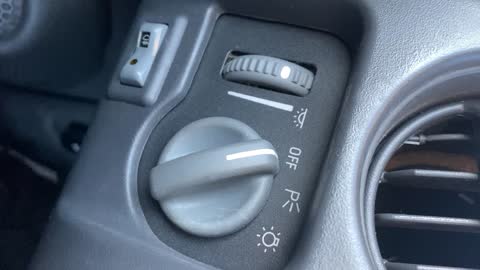

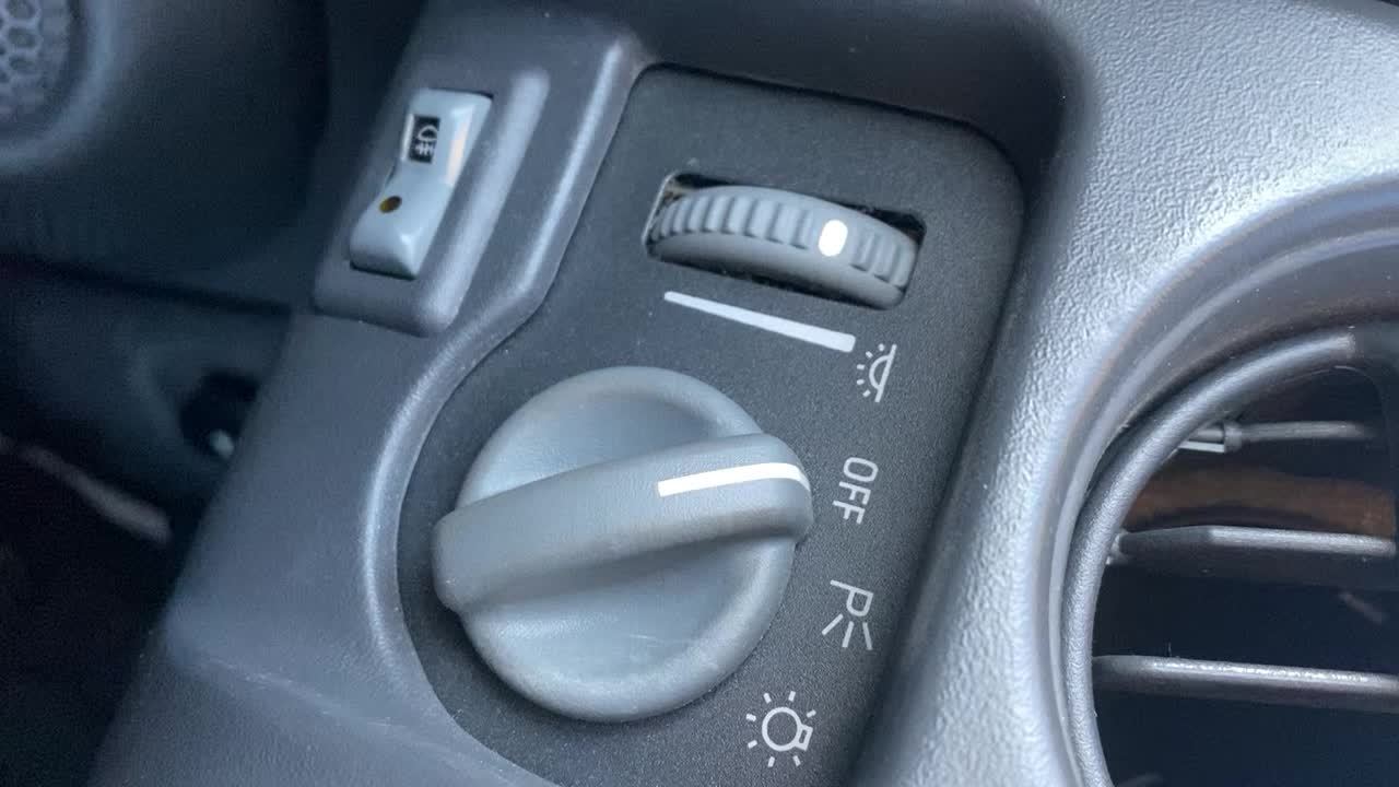

We had a situation where the turn switch inside the car for the headlights was clicking while in the off position. This was at random and noticed while it was driving. It started on its own and stopped after many minutes. As a result, the headlight doors will not go up, their pop-up style, nor are the headlight lamps turning on.
After several looks at fuses and relays, I was able to replace the larger 50A fuse with no luck. But after some sequence of events, disconnected the negative terminal of the battery, removed the fuse, and reconnected everything, turning the switch to turn headlights on allowed the doors to popup but the bulbs were not on. Furthermore, the doors did go down after turning off but never came back up when attempting a second time.
I would find it hard and difficult to think it is the motors that operate the doors since after a sequence of events they did go up/down. There are no sounds of grinding in the motors of the headlights and besides that, both going out at the same time is a little unlikely.
Having said that I cannot seem to know how to troubleshoot the electrical part of this issue.
Since the turn dial switch that turns the lights on/off was clicking perhaps I should start there?
Should that be replaced, or I do have an electrical device to test amps/ohms/voltage, what can I check regarding that?
Thanks.

See if the video works from the clicking heard while driving.

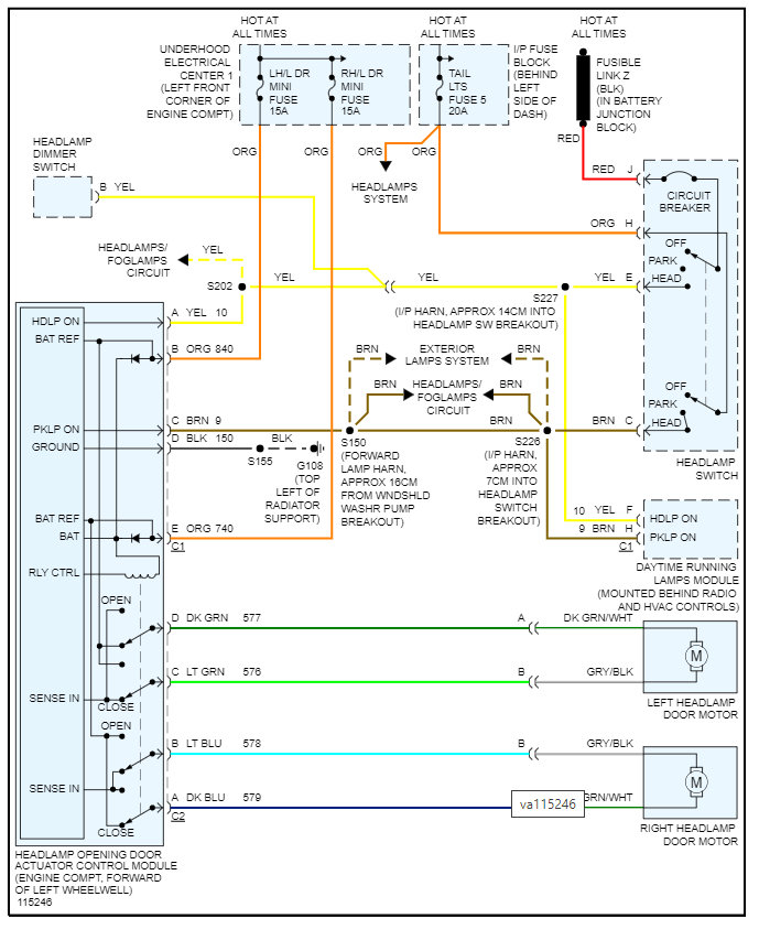

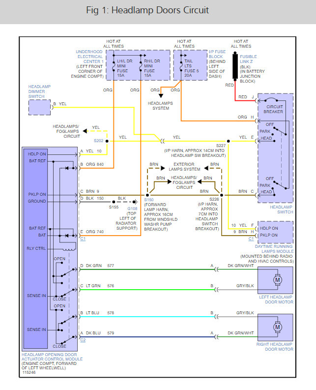

This may be as simple as a switch issue. However, there is some testing that we can do to try and prove this.
Here is a guide that will help with this:

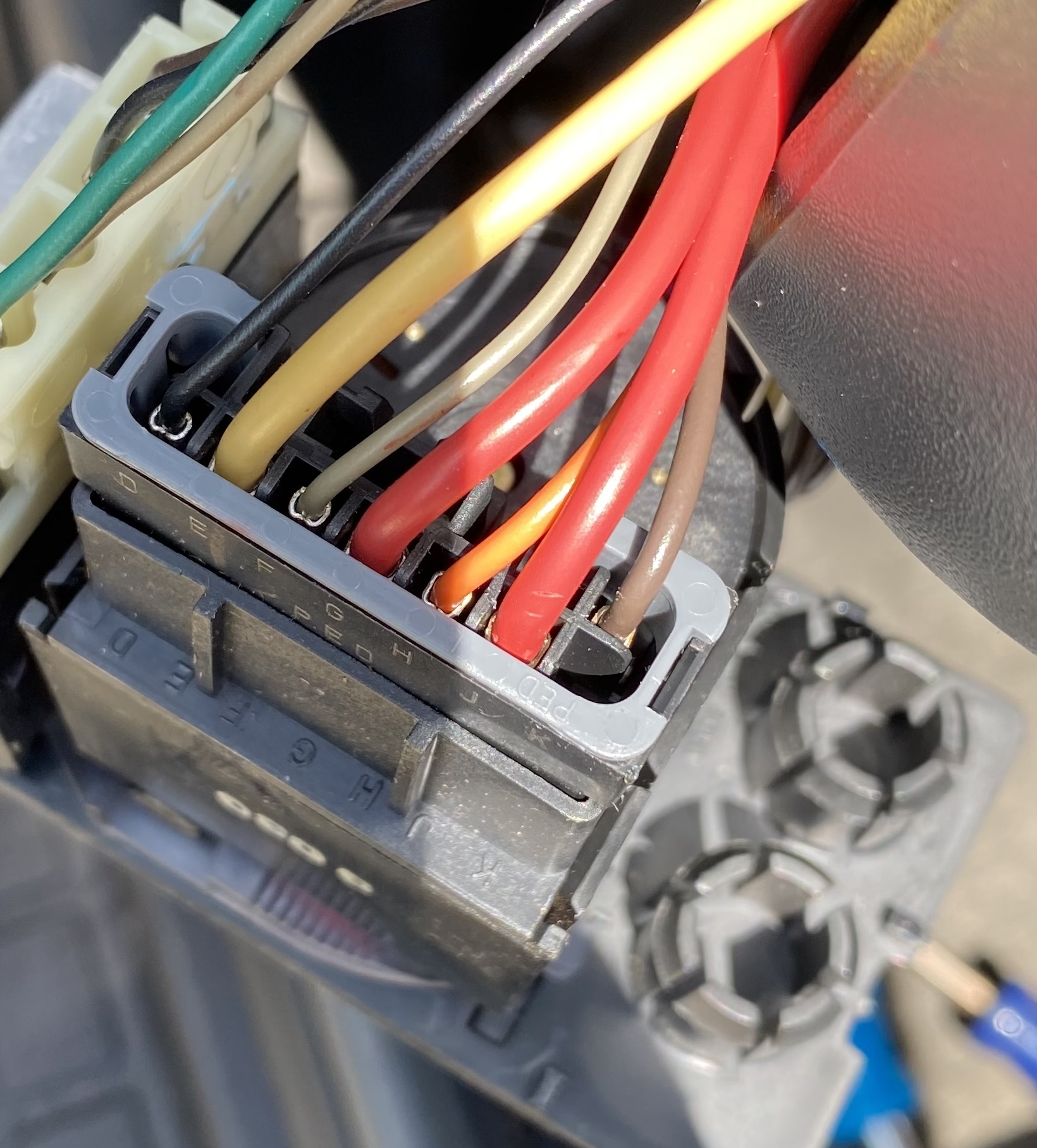

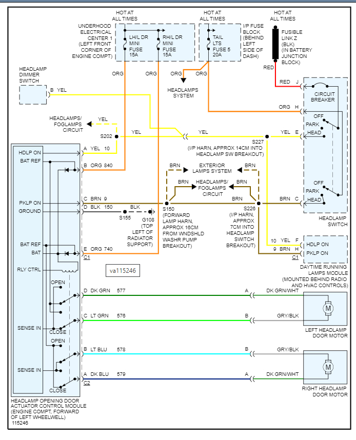

I am attaching the wiring diagram below, but we need to start with the switch. We need to check and see if you have voltage going into it on the red wire on pin J.
Next, we need to turn the headlights on and check for voltage on pin E and C.
Pin E is to open the doors and pin C is to turn the lights on. So, we should have 12 volts on both when they are turned on.
If we do, then we will need to move onto the module but let's start with a switch issue as that makes the most sense.

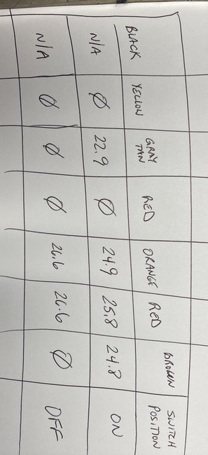

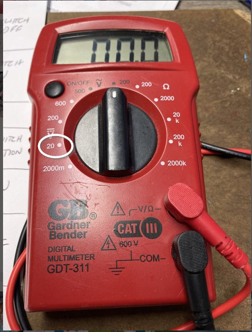

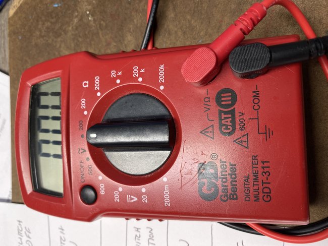

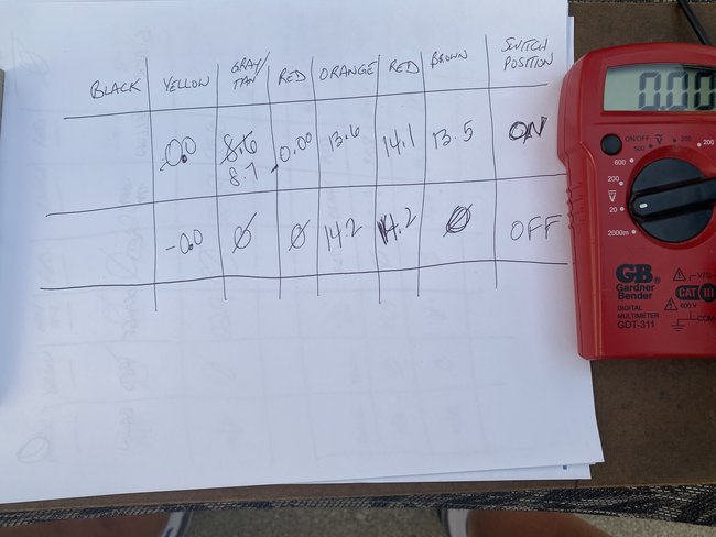

Okay. I am attracting the results of the measurements to the switch. The diagram you sent me only has one red wire, I have two as shown. Perhaps the results will tell you something. I also sent a pic of the meter used and the setting.

You have the meter set on Alternating current. You need to be on direct current. I circled the setting below.
Let's try this again and see what we have. Thanks
Jun 19, 2022 at 10:55 AM

Okay, my mistake. Attached are new results.
Jun 19, 2022 at 11:18 AM
If you take a look at the wiring diagram the yellow wire is the command wire from the switch to the lamps. If you have 0 volts when it is on and off, then the switch or the wiring is the issue.
Have you replaced the switch? If not, I would be replacing that based on this info.

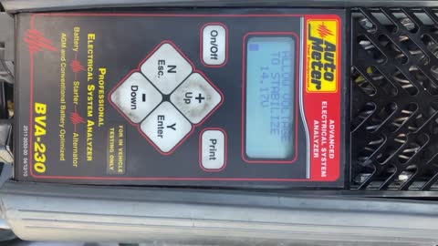

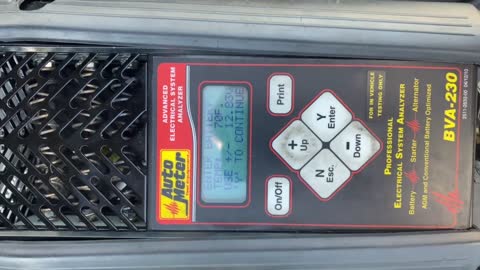

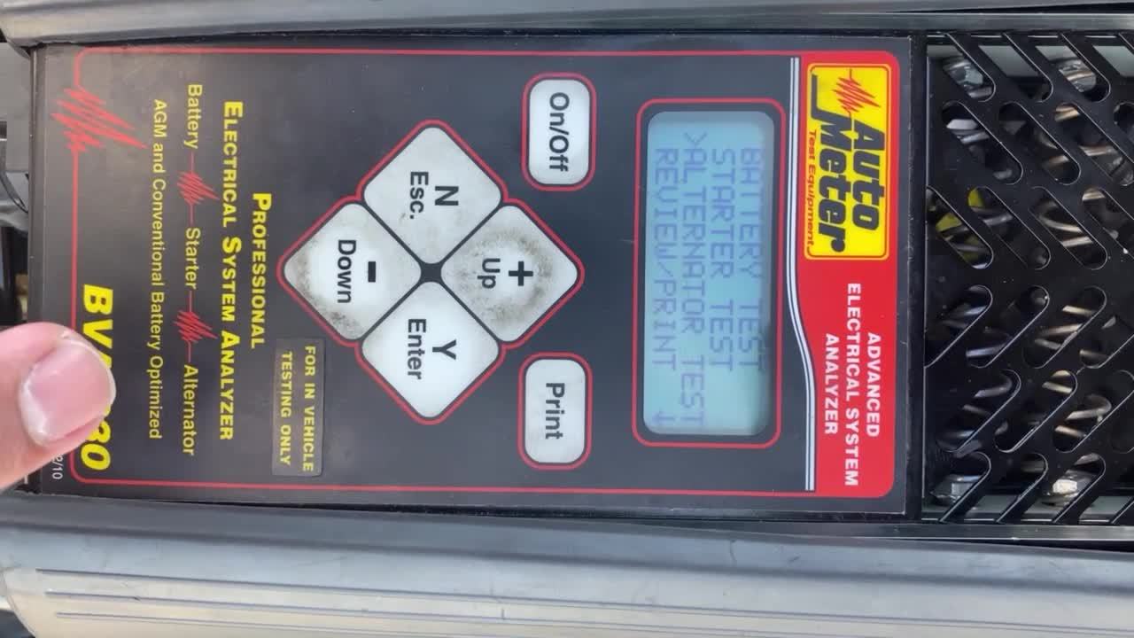

That is strange. However, I am wondering if we overlooked the most basic thing. It would not be the first time but if the battery is drained then there will be all sorts of issues like this. That would explain everything so let's just have the battery load checked.
You can do this test, but the best way is to have it load tested at a parts store.
If we don't verify this first, then we are going to be making more mistakes.
Jun 23, 2022 at 11:44 AM

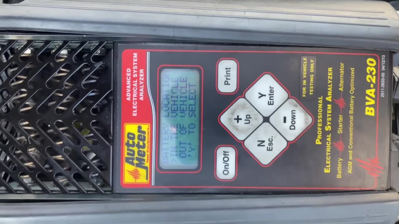

Okay, I will do that, but I should tell you the battery is less than 12 months old.
Perhaps this might explain why the driver power window will sometimes not go back up after the first trip down with no trouble. The only way to have it go up is to press the button every minute or so and then it only goes up a few inches at a time.
Jun 23, 2022 at 12:13 PM
JALFANO24
  • 55 POSTS
Okay, load test completed, and it passed. I will try and load a video of the event. A new battery purchased and installed in 12/2021.

Okay. At this point we are going to have to start tracking the voltage through the system and find out where we are losing it.
Start with the brown wire from the switch to the module.
When you have them on you should have voltage on this circuit so let's start with this and go from there.
If you do, then we need to check the output voltage of the module to the door motors.
See the wiring diagram below.
Thanks

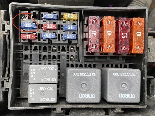

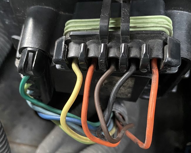

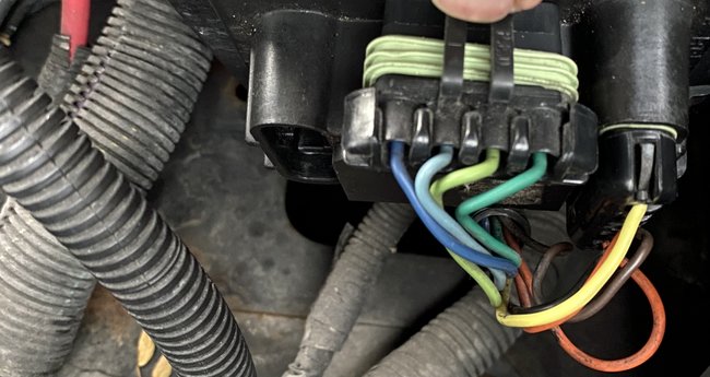

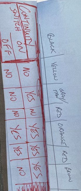

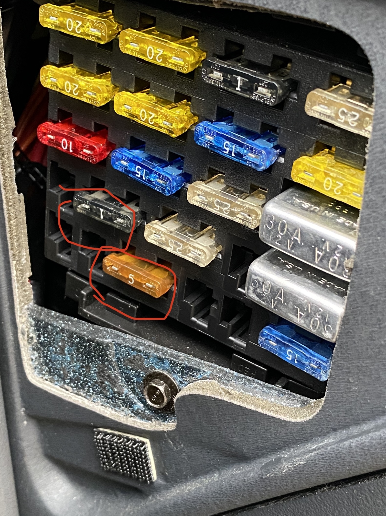

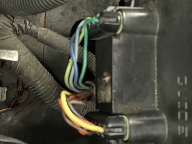

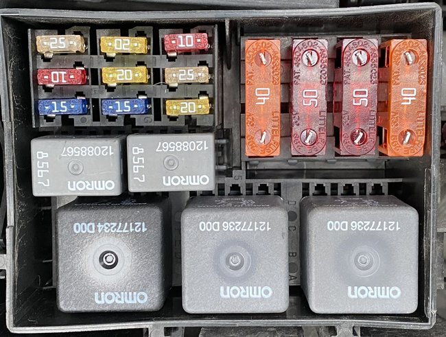

Okay. I'm not sure exactly how to do this but here is where I started: I bought a continuity tester with a simple bulb and tested the following. All three fuse boxes but not the relays, how do I do that if needed?
The three fuses circled in red, did not test for continuity while the rest did. Not sure if this means anything.
And I tested the wiring plugs to the switch and the headlight control module. See pics for results.
Note: The one plug on the headlight control module was unplugged and tested with the headlight switch in the on position, when I plugged it back into the control module the headlight doors went up, headlamps did not go on, and when I turned the switch off, they went down.
Hope this helps.
Let me know where to go from here. I have purposely not dismantled the headlight parts to get to the motor.

Next fuse box, this one under hood.
Jun 30, 2022 at 9:54 PM
JALFANO24
  • 55 POSTS
Trying again.
Jun 30, 2022 at 9:56 PM
JALFANO24
  • 55 POSTS
Second fuse box under-hood.
Jun 30, 2022 at 9:57 PM
JALFANO24
  • 55 POSTS
I should mention that the engine was started and running during testing. Not sure if you were assuming that or not. :)

I think the clicking you are hearing is the built-in circuit breaker inside the switch, can you unplug the headlights and then turn the switch on to see if it still makes the noise? We are trying to see if it is a short in the wiring or the headlight motors. Please let us know.

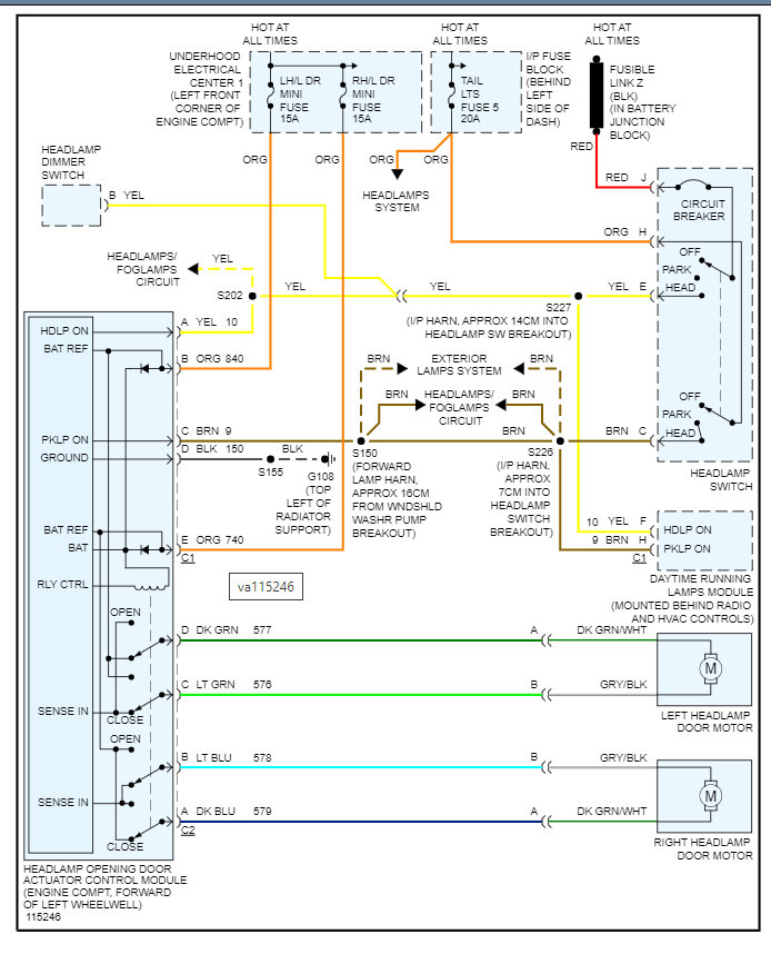

Can you give me a wiring diagram of each motor? Or better yet, can you tell me where the fusible link is located, is there more than one, wondering if it is possible that the fusible link went bad?
Also, please advise how to check to make sure the grounds are ok. I think we need to make sure that everything is grounded. thoughts?
Jul 27, 2022 at 12:20 AM
  • 55,432 POSTS
It is the fusible link Z in the power distribution center. Here is a wiring diagram so you can see how the system works and this guide can help you test for power and ground:
Jul 27, 2022 at 5:55 AM

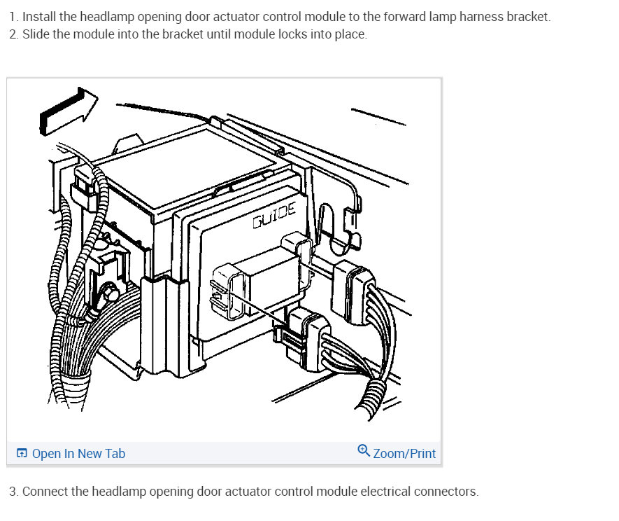

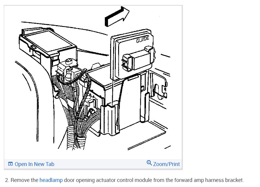

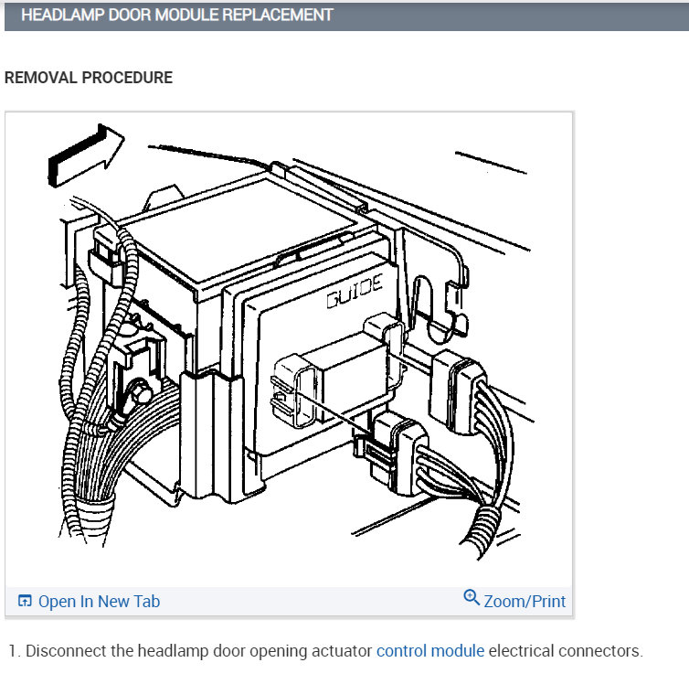

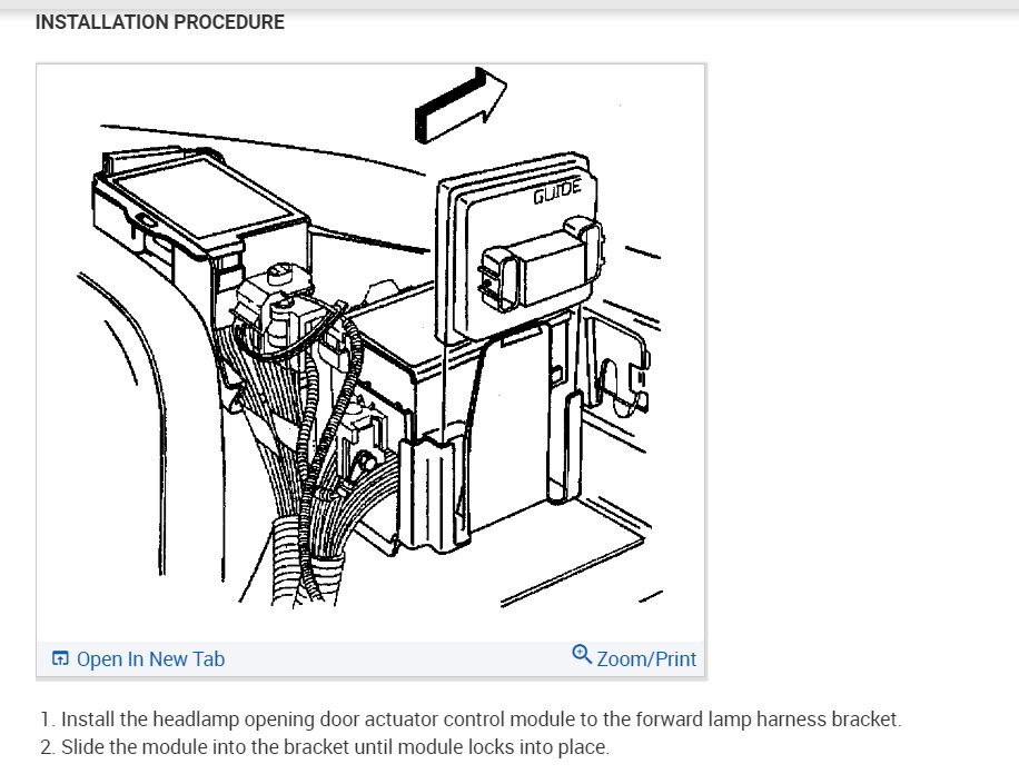

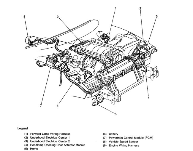

Okay, so, if the headlight lamps will not turn on, is it possible that is why the doors do not swing open? Because the entire time the headlamps have not gone one while unplugging the two connectors on the headlight control module, with the headlight switch on, triggers the headlamp doors to go up. Thoughts?
Sep 18, 2022 at 10:58 PM
  • 55,432 POSTS
Yep, this sounds like the headlamp activation control module is not working. here is the location so you can check it out. Check out the images (below). Please let us know what happens.
