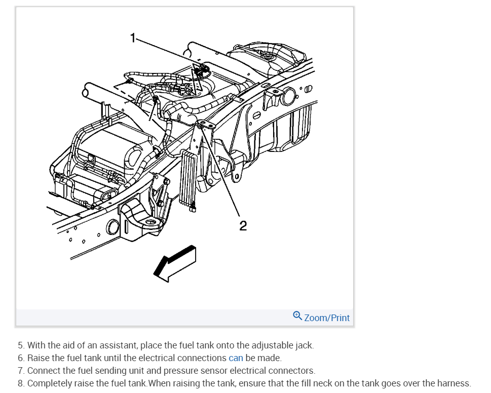

Hi Ken. Well, I didn't have a newer type of fuel pressure tester but picked one up yesterday. It is confirmed about the fuel pump. The pump itself is good but the regulator must be leaking. I tested it just awhile ago engine not running or cranking. I was doing it myself and never got initial reading but the reading I did see was up then slowly went down with key on. Unfortunately this regulator thingamajig along with filter are all in the tank. This technology sucks. From buying one thing to having to buy everything all at once. I hope this will solve all of my issues. But thank you for leading me in the right direction.

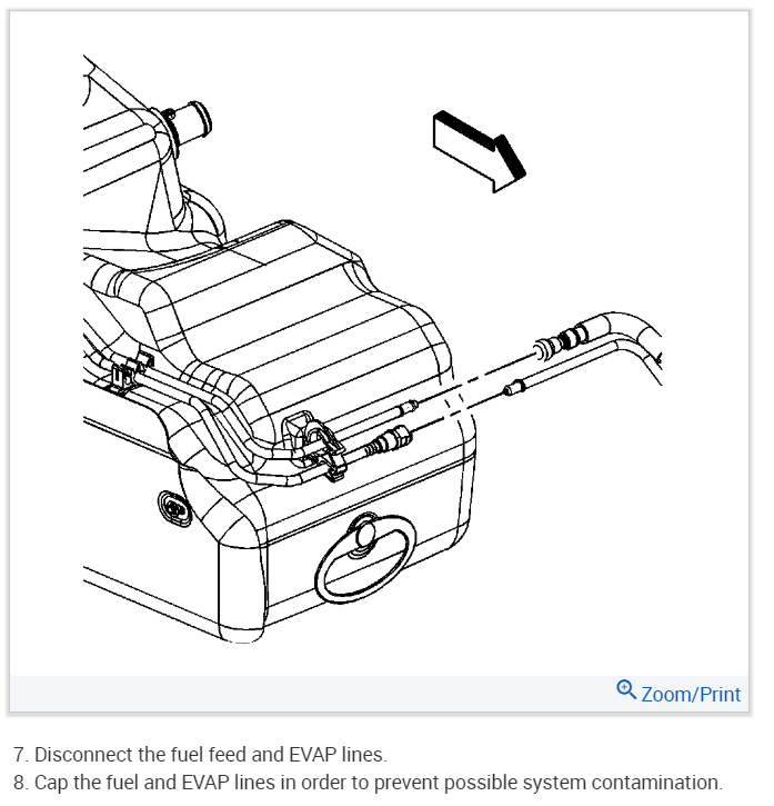

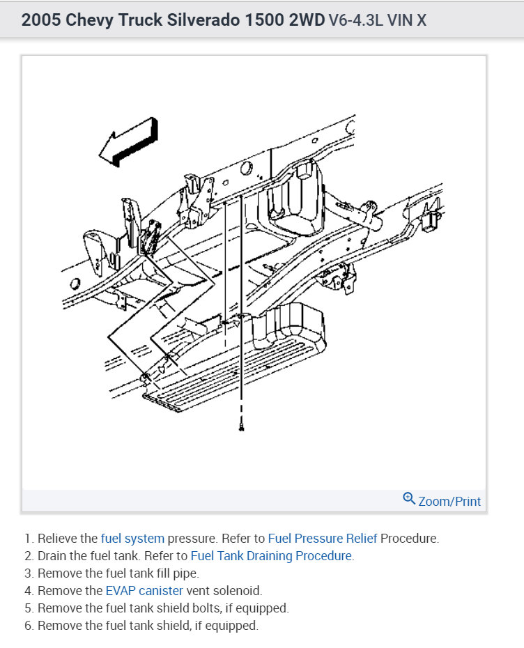

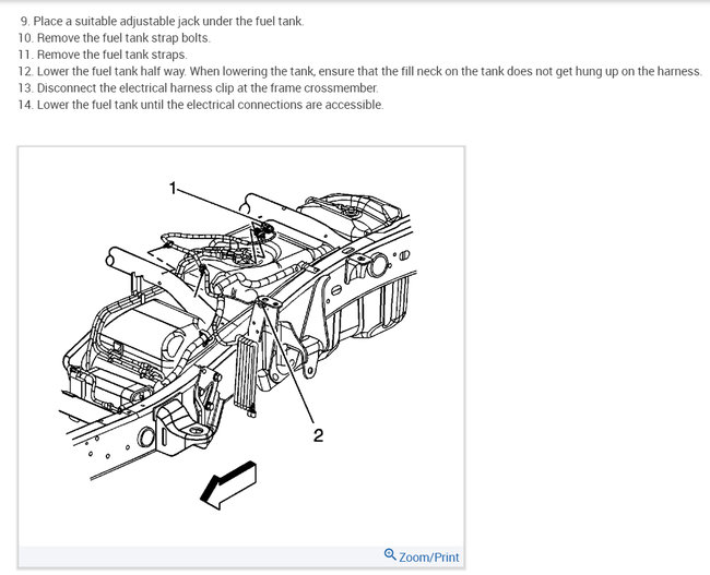

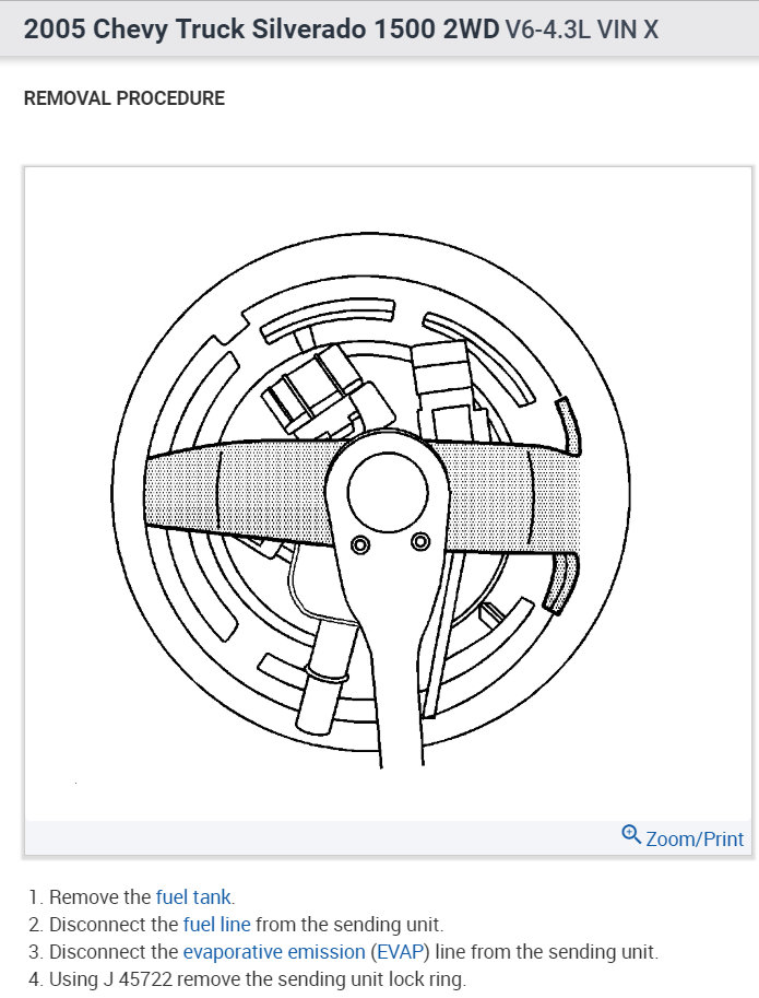

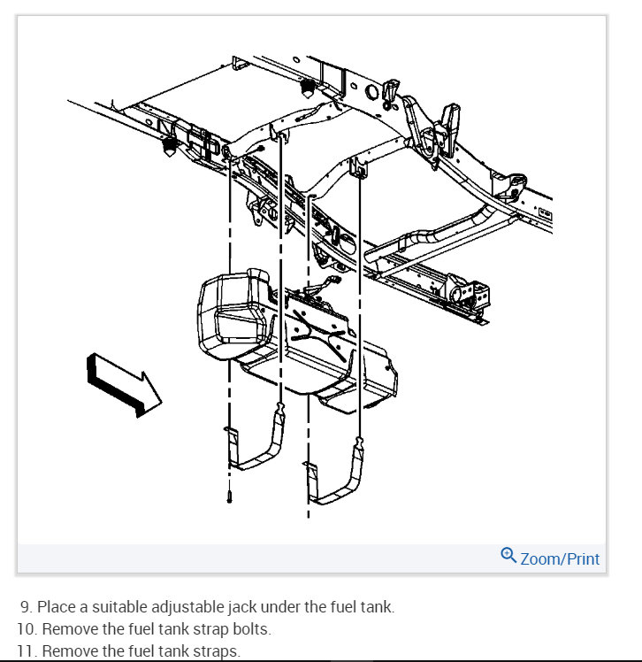

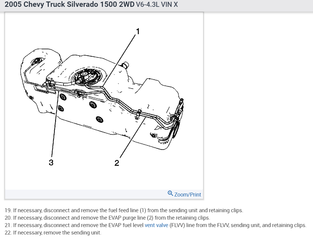

Fuel pumps go out in these cars. here is a guide to help walk you through the process and diagrams below to show you how to do the job on your car below:
https://www.2carpros.com/articles/how-to-replace-an-electric-fuel-pump
Saturday, December 29th, 2018 AT 11:28 AM
