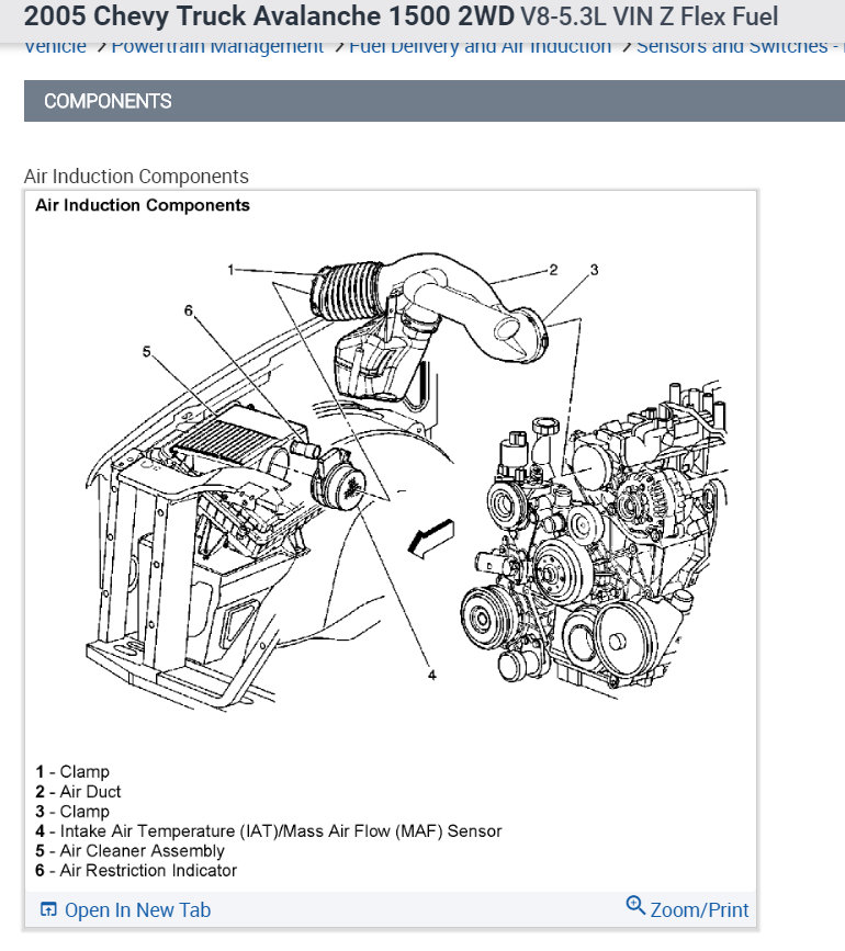

Hello, I do not see any codes when I check. Under normal driving conditions it performs well enough. But sometimes when I am passing on the highway the engine kicks in then right back out again and it feels as though sluggish. If I come to a rolling stop then proceed and give it lots of gas it will feel sluggish. Winter time now, I had spun the tires in the snow a couple of times. When I do the engine revs up tires spin I let off and tires stop spinning but engine keeps revving as though transmission is slipping. I have thought of replacing the vehicle speed sensor but seeking advice on maybe something else wrong. I had just bought this truck over the summer I do not know all that was done to it. I only know a cold air intake was added as well as a throttle body spacer and was told a chip was put in. I do not know if the guy tuned it himself afterward. Is it possible the previous owner over tuned the shift pattern on the transmission. As I mentioned it does run good under normal driving conditions. I only notice these things when I step on the gas moderately hard.

This can be caused by a bad MAF sensor which will not set a code. I would swap the sensor out to see what happens. Here is a guide and the location for your truck below:
https://www.2carpros.com/articles/how-to-replace-a-mass-air-flow-sensor-maf
This guide can help as well:
https://www.2carpros.com/articles/engine-has-low-power-output
Check out the diagrams (below). Please let us know what you find.

Okay, thank you Ken. I will go pick one up today. I kind of suspected that might be it. Something I had done with my air filter was sprayed to much oil on it when I probably should not have used it at all. I likely baked oil on that sensor. Thanks

Hi Ken. Well, changed my MAF sensor. It didn't make a difference. A couple of months ago I had changed my pedal position sensor because I was having like a stall condition. I'm wondering now. Is there a right way and a wrong way of installing this sensor. It was the sensor only without the pedal that I installed.

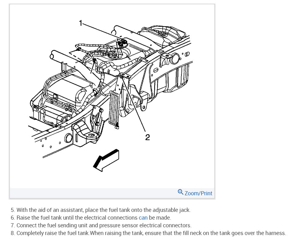

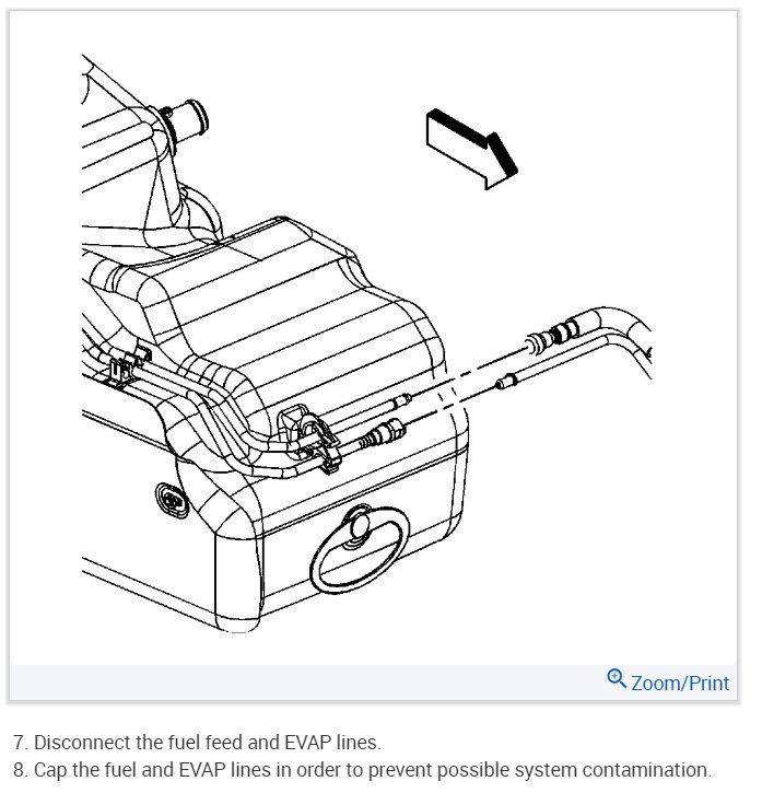

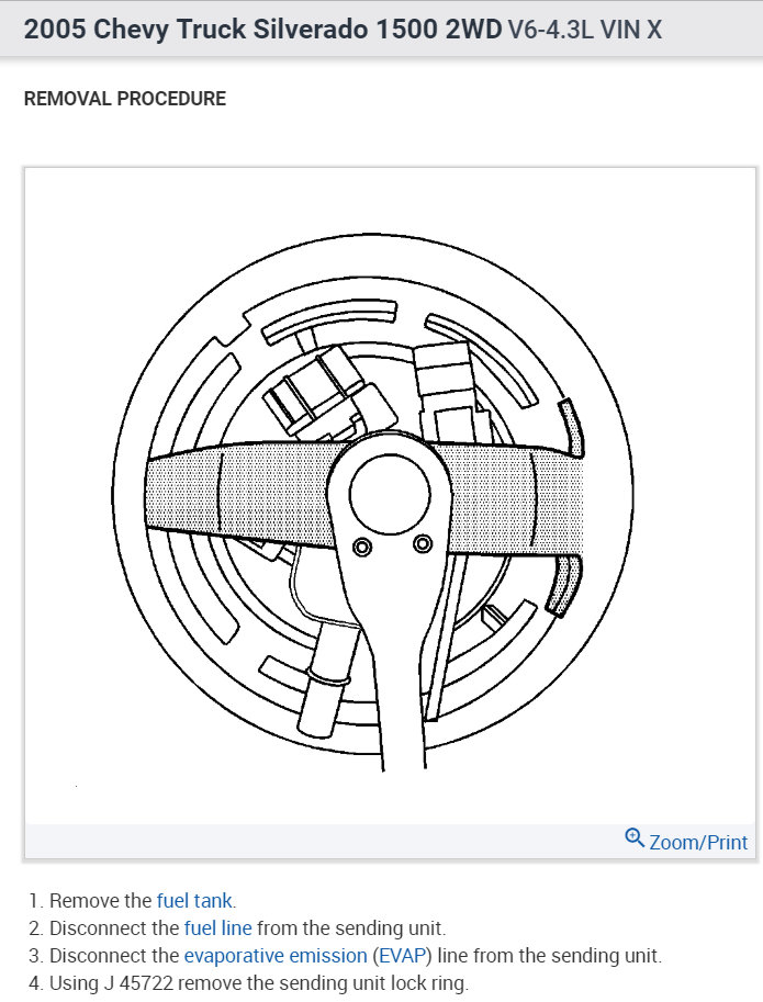

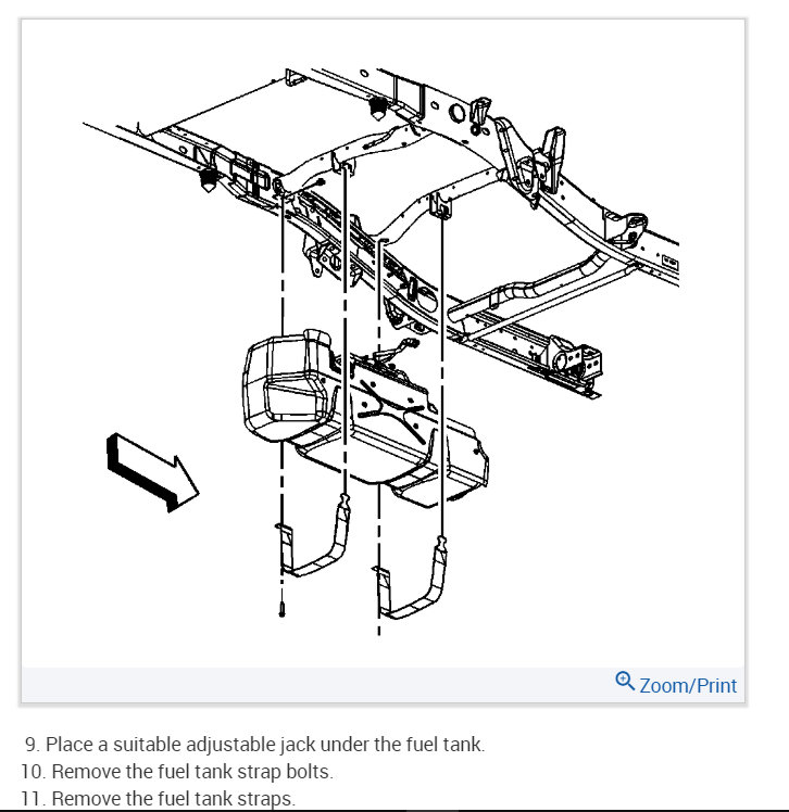

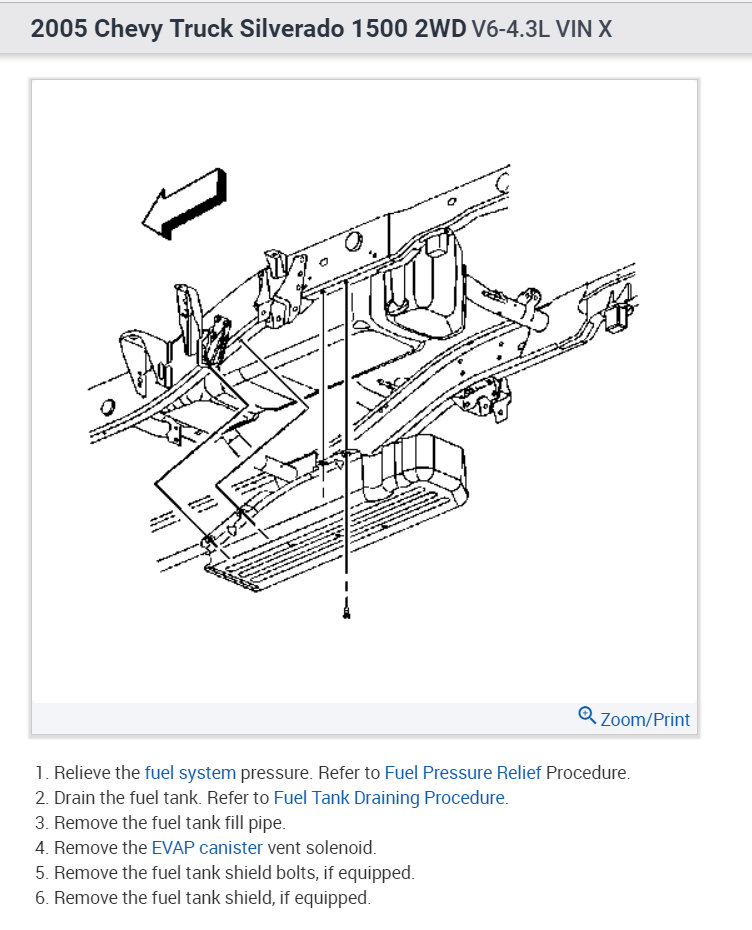

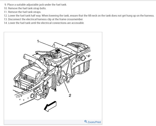

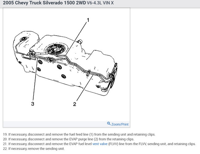

Hi Ken. Well, I didn't have a newer type of fuel pressure tester but picked one up yesterday. It is confirmed about the fuel pump. The pump itself is good but the regulator must be leaking. I tested it just awhile ago engine not running or cranking. I was doing it myself and never got initial reading but the reading I did see was up then slowly went down with key on. Unfortunately this regulator thingamajig along with filter are all in the tank. This technology sucks. From buying one thing to having to buy everything all at once. I hope this will solve all of my issues. But thank you for leading me in the right direction.
Dec 29, 2018 at 2:43 AM
  • 55,118 POSTS
Fuel pumps go out in these cars. here is a guide to help walk you through the process and diagrams below to show you how to do the job on your car below:
https://www.2carpros.com/articles/how-to-replace-an-electric-fuel-pump
Dec 29, 2018 at 3:28 AM
