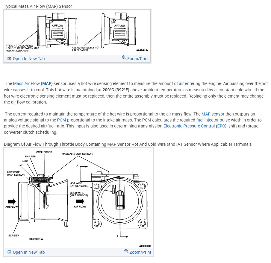

Car listed above Zetec has poor to nonexistent acceleration when the throttle pedal is pressed about 1/3 of the way down. On level ground it accelerates slowly then runs fine. On a hill, or trying to start quickly from a standstill, or using cruise control "Resume, " the engine just bogs down.have replaced fuel pump and filter coil,fuel pressure regulator pressure switch, o2 sensor.
Sep 28, 2019 at 7:51 AM

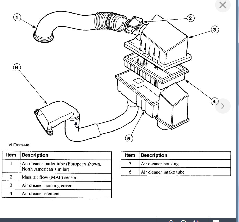

We need to look at the mass air flow sensor. These engines are known for them failing. When they do, your power drops to nothing.
Here is a guide that explains this and other possible causes. Please review this and let me know what you think.
https://www.2carpros.com/articles/engine-has-low-power-output
