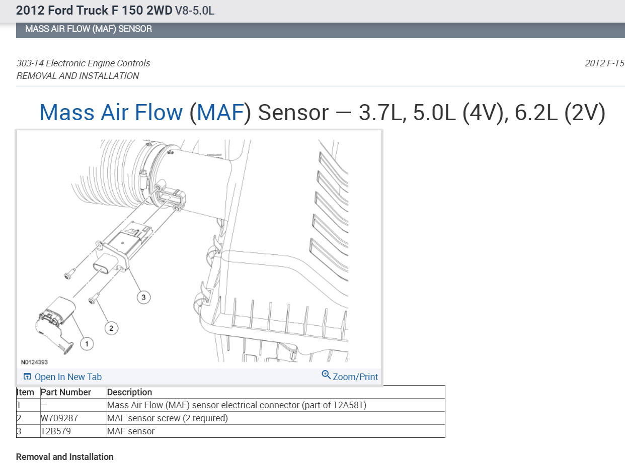

It is common for the MAF sensor to be off slightly which effects the engine fuel mixture and not throw a code. I would buy a new Motorcraft sensor and install it. You can take before and after reading if your scanner has the capabilities. Here are two guide to help with diagrams below to show you how to fix you car with diagrams below:
https://www.2carpros.com/articles/how-to-replace-a-mass-air-flow-sensor-maf
and
https://www.2carpros.com/articles/engine-has-low-power-output

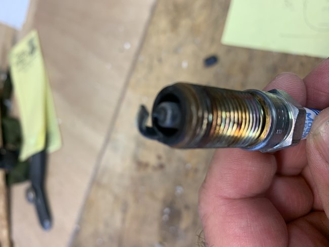

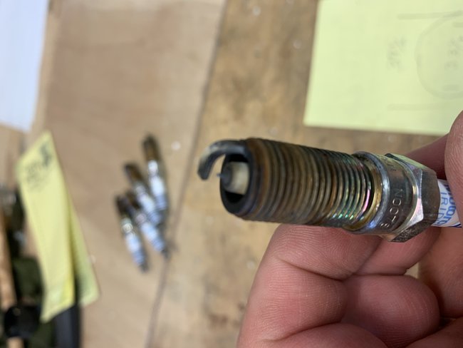

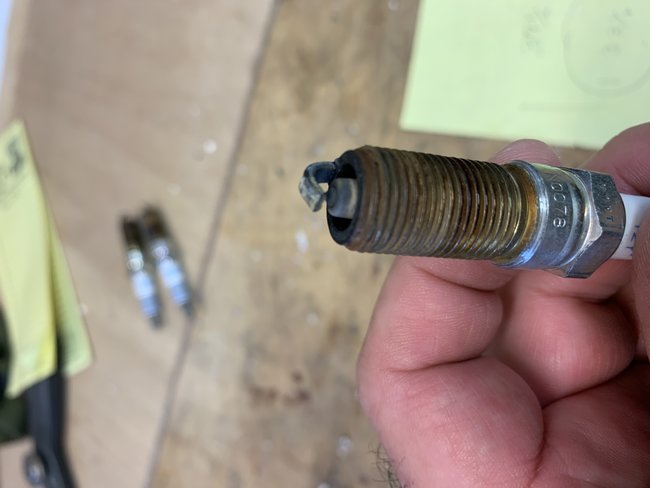

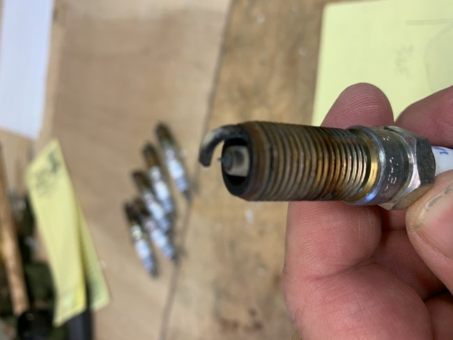

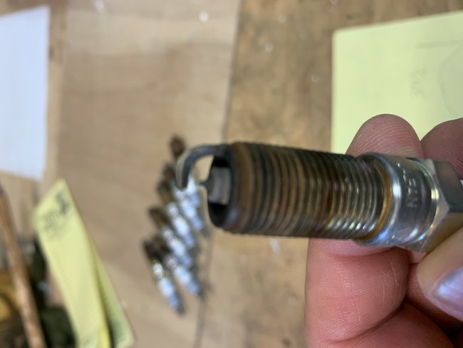

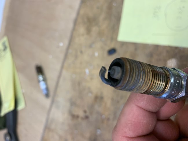

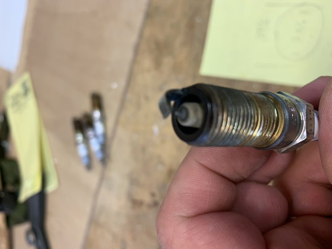

Hello again, it's been awhile since we last discussed this but I was waiting for it to get a little warmer outside and then the world came to a screeching halt and this kind of took a backseat. Anyway, I've had some spare time and I wasn't able to check the catalytic yet since I haven't been able to get my hands on an infrared temperature tool. Although I did manage to change the spark plugs recently and it seemed to help some, but not the dramatic increase I was hoping for. I remember getting around 23 mpg when just cruising on the highway about 1,900 rpm's and trying the same thing now it's about 21 mpg, so i seem to be down about 2 mpg all the way around. Anyway, I was wondering if you could take a look at the old plugs and let me know if there's anything there to be concerned about?
Thanks
Jun 28, 2021 at 5:40 AM
The 4th picture concerns me. There is no gap and that is a problem.
The others look okay but the gap is wide. I would replace them since you have them out.

Thanks, I did replace them already, I was just wondering if you saw anything on them that gave you any more clues to the poor acceleration. As I said, the new ones feel a little better but not the dramatic improvement I was hoping for. I think the one you mentioned was just a bad angle, they were all gaped, but close to the outer limit. I guess it's on the catalytic to try and rule that out.
Thanks again.
No, nothing to indicate the low power issue at all.
Keep us updated.
You are welcome.

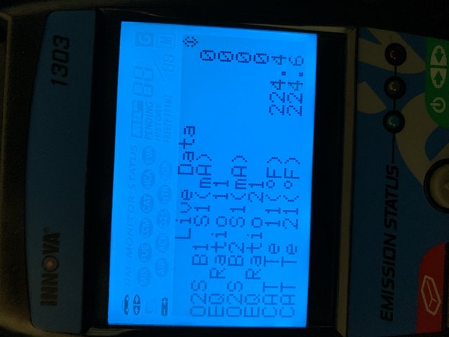

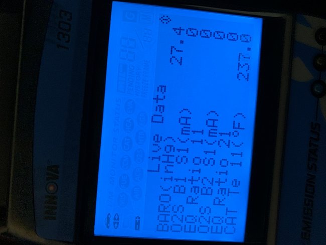

Hello again, I'm still trying to figure out if I have a problem or not. I decide that I'll just live with it and then get annoyed with it because it seems to have no power on the low end, like trying to get on the highway. I'm going to be towing again in the summer and would really like to get this sorted out if need be by then. So, this time I was looking around found a video where the tip off was the BARO reading. So I hooked up my scan tool and found the reading but it was in inHg(see first picture) and the video was discussing correct readings with Hz, is there a conversion or can you tell me what the correct reading should be here near Akron, Ohio? Also I still never did get a infrared thermometer to test the catalytic, but I noticed that there are 2 catalytic converter readings on the scan tool (see second picture). Are these the intake and exhaust temperatures for the catalytic converters? They read almost identical, so does this mean that it's okay?
Finally, I disconnected the battery and pulled the throttle body to clean it while I was messing around today and it didn't really seem to dirty. But after reinstalling everything and taking it for a test drive it feels great. It's the same as when I installed the new MAF, it's great at first until I drive it for a while and then it gradually ends p back where I started. So if everything above is correct, any other ideas on things I can check?
Thanks again.

What is the long term trim readings?
https://www.2carpros.com/articles/repair-lean-mixture-codes-p0171-or-p0174-on-some-manufacturers
