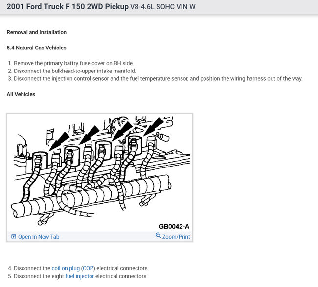

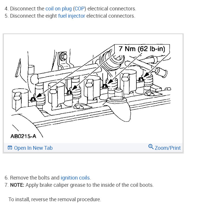

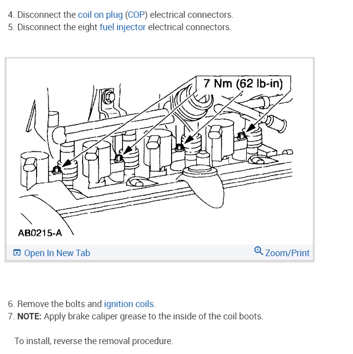

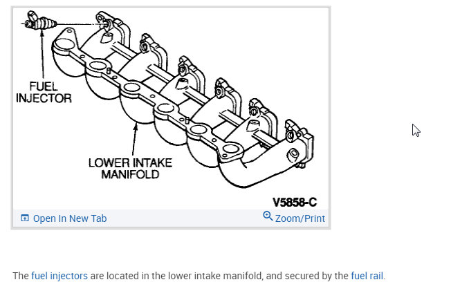

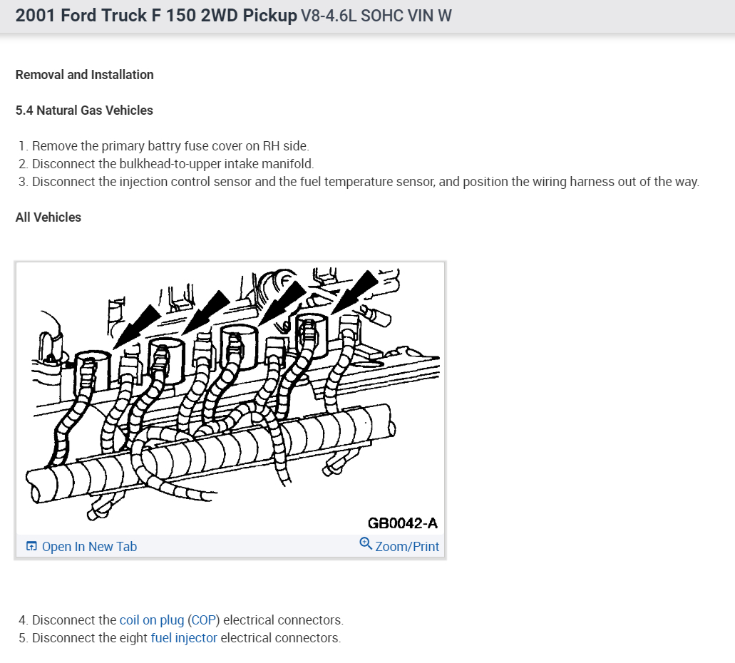

A recent problem is a lack of power at acceleration. It hesitates and "bucks" from start and from a roll. I have to shift down to 2nd or 3rd to maintain any speed when climbing a hill. But there is no check engine light displayed. I had a more pronounced occurrence approximately 2 years ago, but with check engine light. the code disclosed the coil over on #7. Replacement of same resolved issue.
Jul 18, 2008 at 9:28 AM
BMRFIXIT
  • CERTIFIED EXPERT
  • 19,053 POSTS

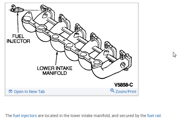

Its common when one coil out the rest tent to follow here is are diagrams below of the job being done so you can fix yours with a guide that should help as well.
Jul 19, 2008 at 6:04 AM

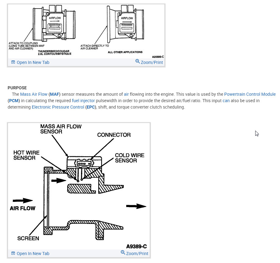

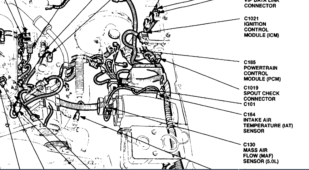

I have seen where the MAF sensor can be a little off and cause low power and give false information to the PCM causing late shifts. Have you installed a new one recently? This sensor should be replaced as a regular maintenance item. When this sensor gets off a little it will not trigger a trouble code.
https://www.2carpros.com/articles/how-to-replace-a-mass-air-flow-sensor-maf
It also sound like a input shaft sensor can be causing problems as well but those will trigger a code when they go out.
Jun 29, 2021 at 9:05 AM (Merged)
NICKBAR87
  • 30 POSTS
I have a maf code and haven't changed it recently. but no codes for the input shaft
  • CERTIFIED EXPERT
  • 53,888 POSTS
The MAF can cause the problem. That is what I would try next.

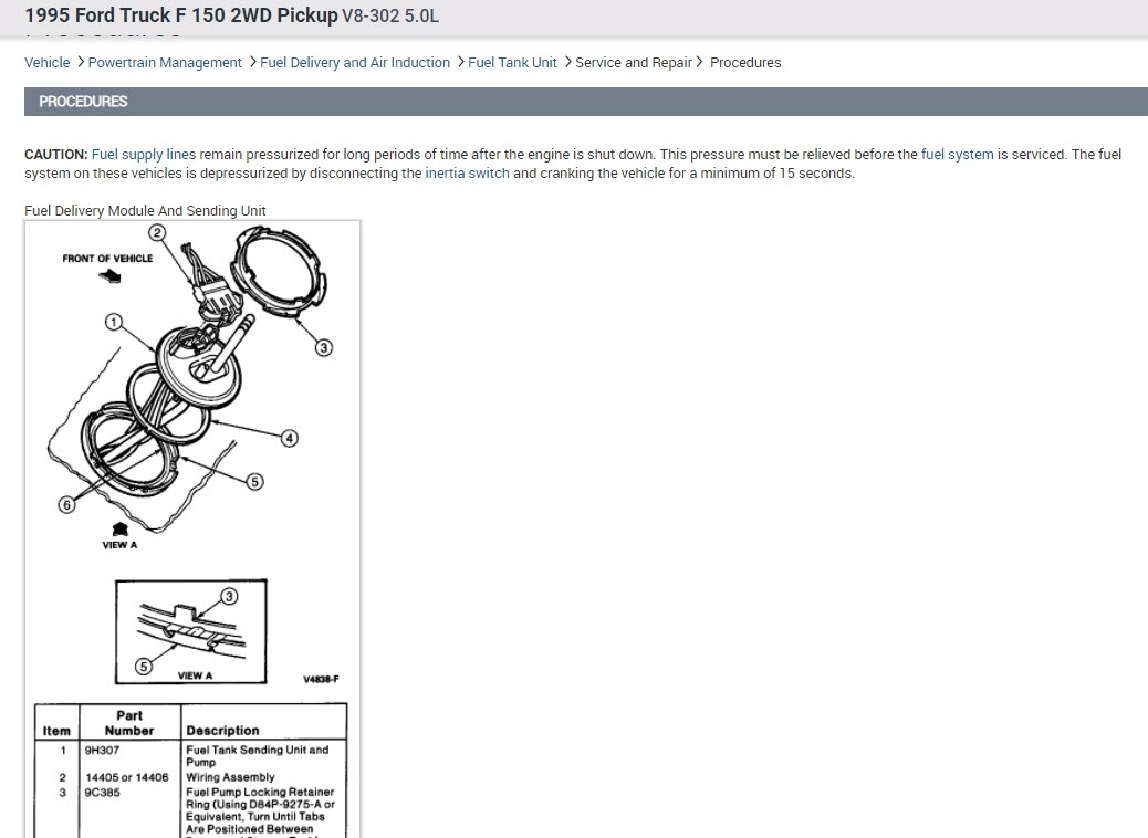

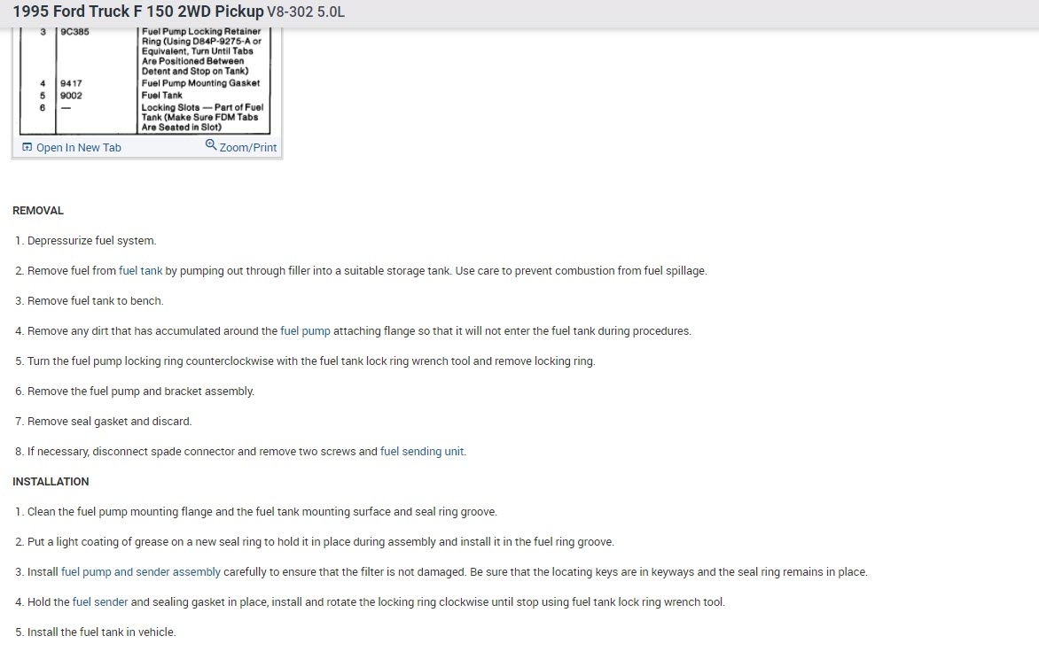

JIMMY1719
when i accelerate it stays at the same speed and does not advance I changed the coil module thinking it was that but it wasn't. If its the fuel pump what do i do and how much would it cost? It shakes when i accelerate i don't know what it can be.?
  • CERTIFIED EXPERT
  • 75,992 POSTS
You can change the pump yourself and save a bundle by removing the tank. check this link, our site made a great article about it.
https://www.2carpros.com/articles/how-to-replace-an-electric-fuel-pump
this is not the same car but gives you an idea :-)

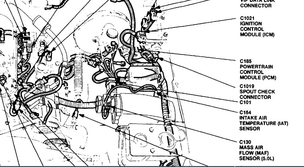

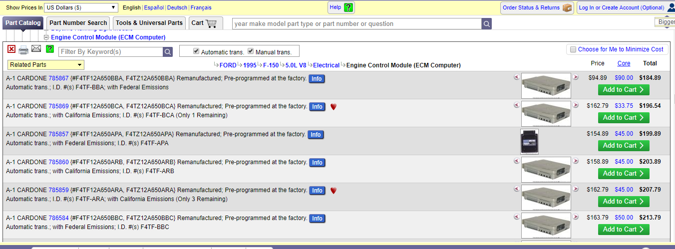

Truck runs awesome when it is first started up, drives beautifully but the check engine light will come on for a second then go off and i lose all power. it lowers the idle to 500, chugs and if i try to give it gas it just pops through the intake system. it has a fresh tune up, new fuel pump and filter, and a new vacuum canister purge solenoid. nothing seems to fix it. i cannot get it to duplicate the problem in the driveway at idle it would rather strand me and have to be towed home.
Jun 29, 2021 at 9:07 AM (Merged)
  • CERTIFIED EXPERT
Good morning,
Do you have the code? I need the code to help with the area of failure. Please go over these guides to help find the issue.

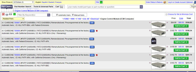

I have the reader for KOEO it is 565 Continuous code is 512 and KOER the codes are 538. 536. 632. The engine light is very intermittent, i just had it idling for an hour, power braked it to simulate being under power and nothing, stayed running great.
  • CERTIFIED EXPERT
512 is the key. The KAM or keep alive memory looks like the issue. The ECM is bad.

WALTER WOOD
  • 24 POSTS
I was afraid of that. now this one accesses from under the hood? Drivers side?
  • CERTIFIED EXPERT
Yes it is. It is under hood, drivers side.
Jun 29, 2021 at 9:08 AM (Merged)
WALTER WOOD
  • 24 POSTS
All other codes are gone. i went ahead and ordered a new mass air sensor and installed it worked great! thank you.
