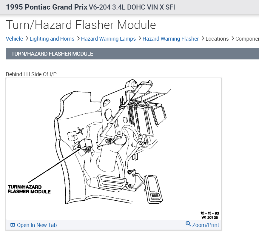

The driver side front and rear turn signals come on[light but dont flash]. The passenger side ones work fine. Are there two seperate flashers for the signals and where are the flashers? Thanx.
Tuesday, July 21st, 2020 AT 1:50 PM (Merged)
BMRFIXIT
  • 19,053 POSTS
It sounds like the flasher is out here is the location so you can change it out. Check out the diagrams (Below). Please let us know if you need anything else to get the problem fixed.

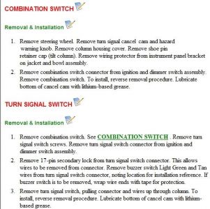

My friend has a 1992 Pontiac Grand Prix, and his turn signal switch does not work right. So we got the the new turn signal switch and we have no clue how to put it in.
Tuesday, July 21st, 2020 AT 1:51 PM (Merged)
BLUELIGHTNIN6
  • 16,542 POSTS
https://www.2carpros.com/forum/automotive_pictures/261618_Noname_2341.jpg
https://www.2carpros.com/forum/automotive_pictures/261618_Noname2_766.jpg
