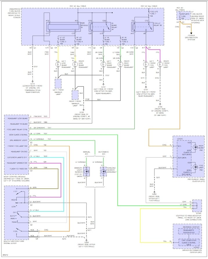

Just brought a new drive side headlight plugged it in but the low beams will not come on just the highbeam and turn signal works. What's wrong?

just the low beam on the driverside? I would confirm that you bought the correct bulb for that vehicle.

Yes the exact same one

Check all fuses, I have seen where if the fuse is bad it will not allow the low beaks to come on. I have added a wiring schematic to help out. Please let me know what you find
