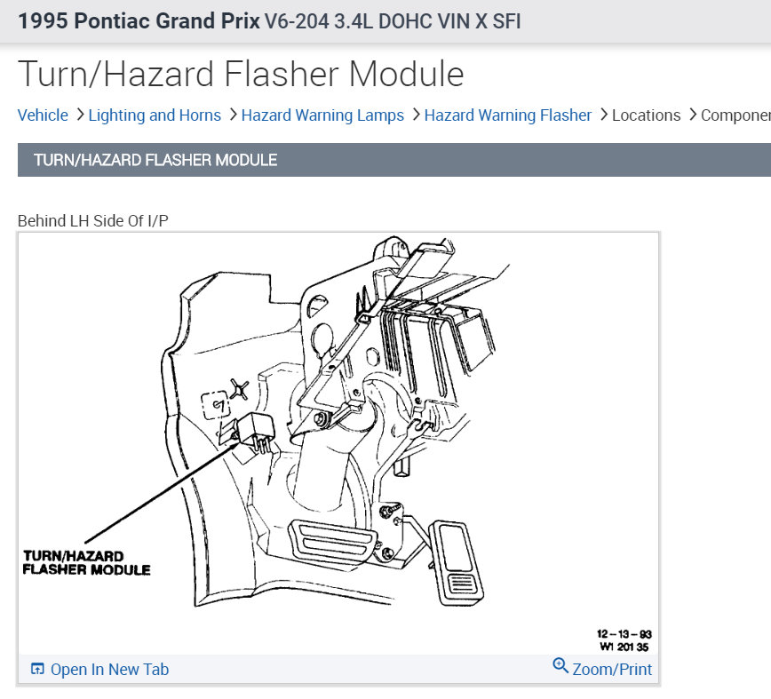

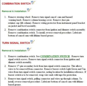

LREOPS
  • 1995 PONTIAC GRAND PRIX
I am trying to get the turn signals working on a 1995 Pontiac Grand Prix. I've checked all fuses according to the owners manual and they all test good. The four way flashers work fine so it is not the bulbs. Is there a relay somewhere that I am missing or what is the possibility that there could be something wrong with the switch in the steering couumn. If the switch is bad, is there a way to check it before getting into the steering column to take it out?
Tuesday, July 21st, 2020 AT 1:50 PM (Merged)
LSUSSEL
  • 252 POSTS
It is possible that the flasher itself might have gone bad. The 4 way hazard flashers will alwasy work no matter whats wrong with your car, thats a safety feature. Check the flasher itself before you take apart the steering column. When you turn on the right or left turn signal, does the green arrow light up at all in the dash?
