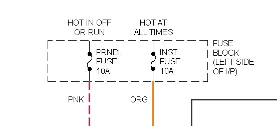

JDL
  • 16,098 POSTS
You need to check applicable fuses and ground for the instrument cluster. Check to see if voltage or ground is intermittent.
Use a voltage tester, check the fuses in the diagram. You can also check wiring at the instrument cluster connector. At the connector D-15 terminal black wire is ground

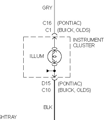

Instrument cluster not working. Checked all the fuses, they all have power in and out. Which wire on the cluster connector has power to it? Are there more than one and are they 12volts or a regulated voltage? Want to know before sending cluster for repair and also wheren can we send it? Thanks again!!
Aug 19, 2017 at 7:44 AM (Merged)
JDL
  • 16,098 POSTS
Sorry for the late reply. Are you talking about cluster illumination? Sometimes the dimmer switch gets turned all the way down, no lite. In the diagram, gray wire is voltage and black is ground, for illumination.
